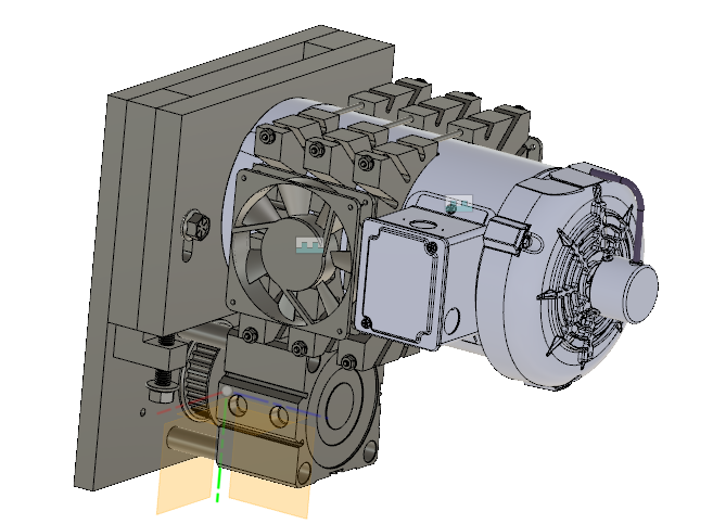

i do have enough finished that i can sort the motor mounting and everything else. this is still in the rough design phase and i still have a few things to sort out but the major stuff i think i have sorted out and did a screen grab to post for the basic plan.
since i would like to do rigid tapping this 3 phase motor needs some feed back so coming up with a way to get an encoder on the motor was a bit of a thinking process but i think i have a good plan, the motor has a plastic fan for cooling on the back side of the shaft so the plan is to attach an encoder directly to the shaft and loose the plastic fan altogether. these motors cool ok at high speeds but when you run slower the cooling drops off. so to make it better at all speeds the plan is to heatsink the motor and use 2 DC fans to cool everything. most likely they will just run all the time when the machine is running.
i have a simple belt tension system worked out and now know what length of belt i need. the one belt i have is too short but getting one that will work is not a problem.
this is still a work in progress but the screen grab explains things better than i can i think

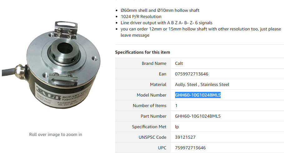

decided to go with this encoder it looked to be about the same as a glass linear scale as far as signals go and figured it would work for my needs here. seems to be rated for 6000 rpm as far as i can tell but some of the info i seen was conflicting? i figured it was cheap enough to try at $55 so time will tell
i was looking for one that would drop right on the shaft as is but to get into that size would cost way to much so i will have to alter the end of the shaft to make this one work but it's not that big of a deal for me. this is a tight budget minded project. the hollolw shaft design should fit under the cover of the motor once the original cooling fan is removed. the fact that i have a 1:1 ratio on the drive makes this simple and i like simple
direct attachment does not get much simpler and less parts are needed so i like that part

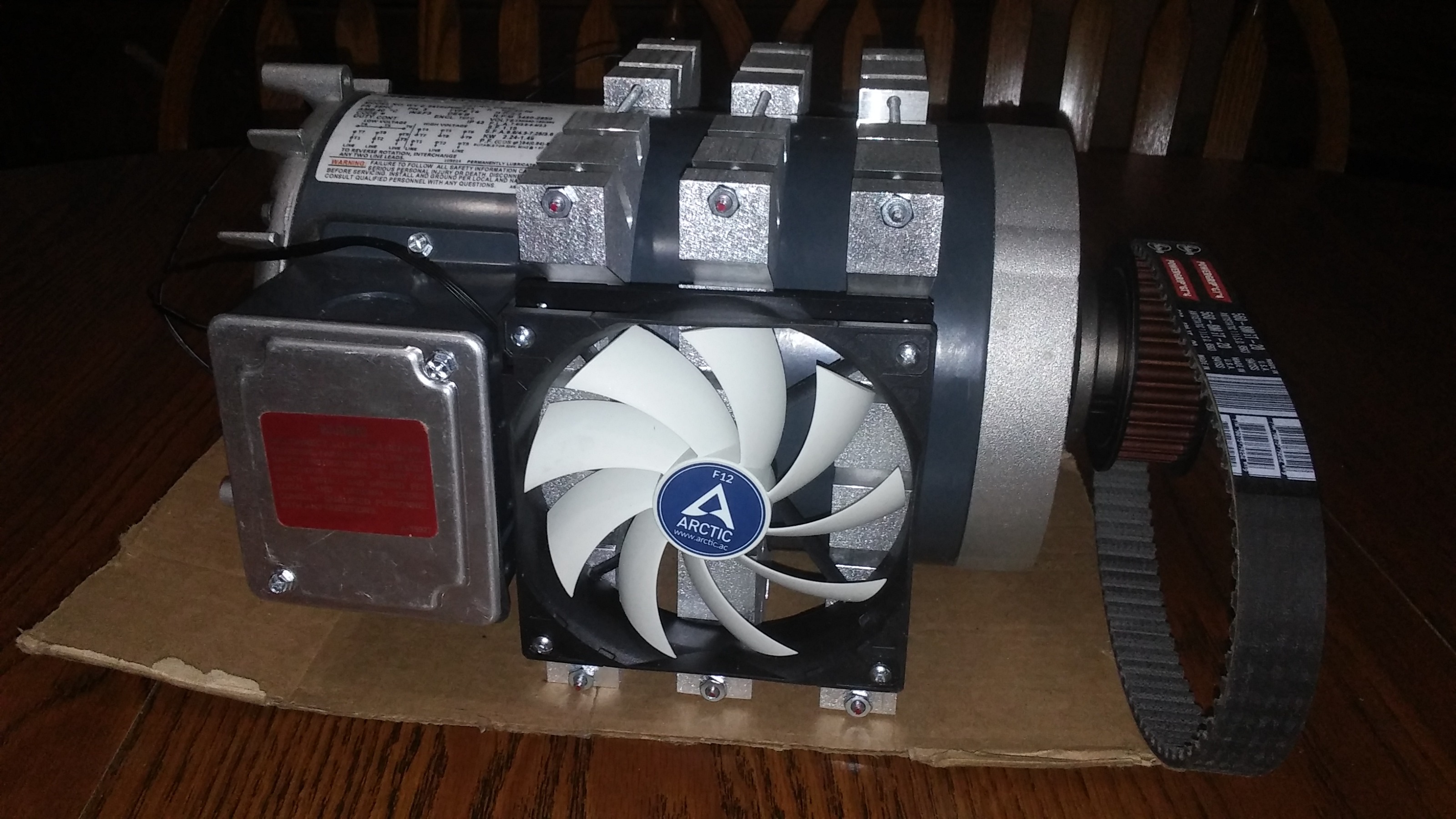

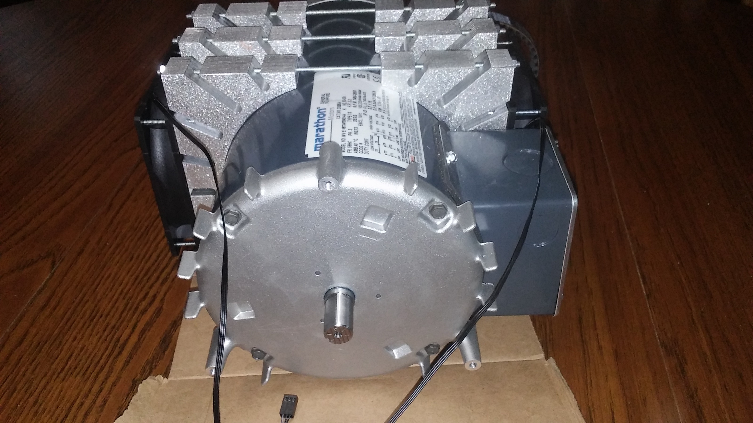

Started to work on my motor cooling plan and got my heat sinks made and the fans mounted. i think this should work better than the stock motor set up. Since I was testing fit and had things together I figured I would take some picture and share. next step is to alter the shaft on the back end for the encoder and open up the center hole of the plastic cover so it clears the rotary encoder and give it a nice tidy look.

F12 = Flow 120mm
P12 = Pressure 120mm
Fans from Arctic, very good and very cheap so try the P12, should be better for that job.
Also, if you can choose, P12 CO, bearings are long lasting.
