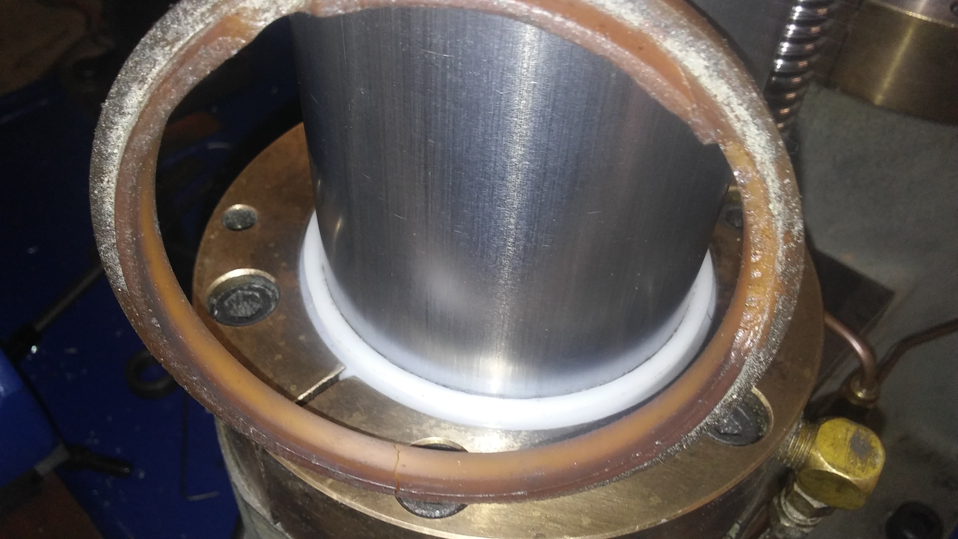

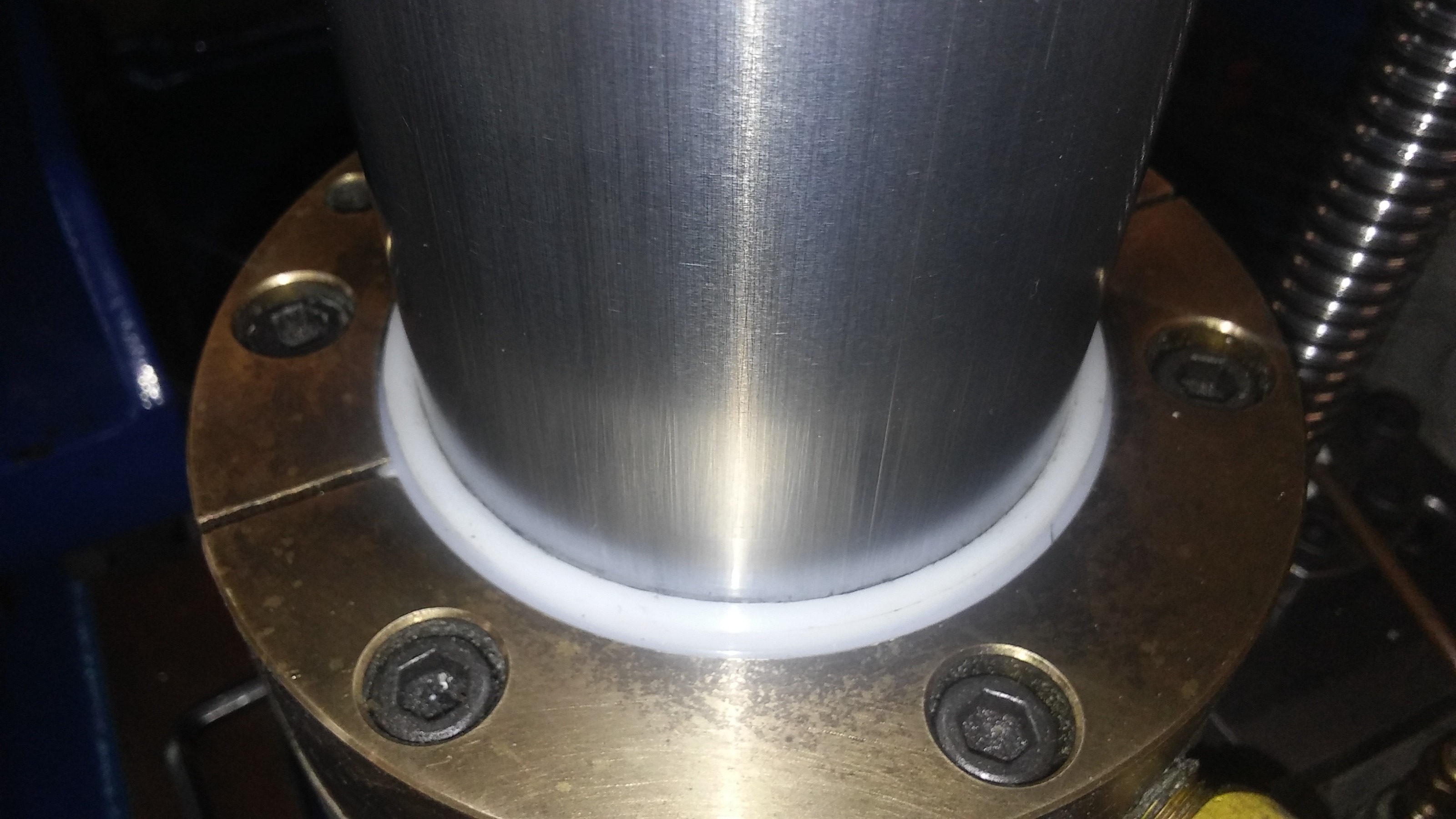

since i had the head all together i can see what kind of real travel i ended up with and see what i needed for an air cylinder. i was able to find one with a 14 inch stroke length with a 2.5 inch bore size for a little over $40. so at that price point i got one to play around with to see what i can come up with. the air cylinder is plenty big enough to only need one of them. i think it will be pretty easy to do a central mount off the back of the machine. a couple of simple mounting brackets should be simple enough to make.
as for travel things worked out ok. i lost some travel since the table got lifted with all the linear rails but it's rigid and it's working out how i wanted even if the travel is not as much as i was hoping for. i ended up with 12" to the center line of the spindle from the table top and around 2" below the table top to the center line of the spindle. so 14" total travel on the head. i knew the work space was not going to be huge but was after something rigid and able to cut steel well. i think i should end up with that.
7.5 months later and still have a ton of work to do on this project. but here is my starting point for the air cylinder counter balance.

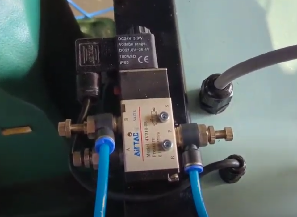

The attached component may help. It designed to trigger an air ram when the Z axis is moving up.

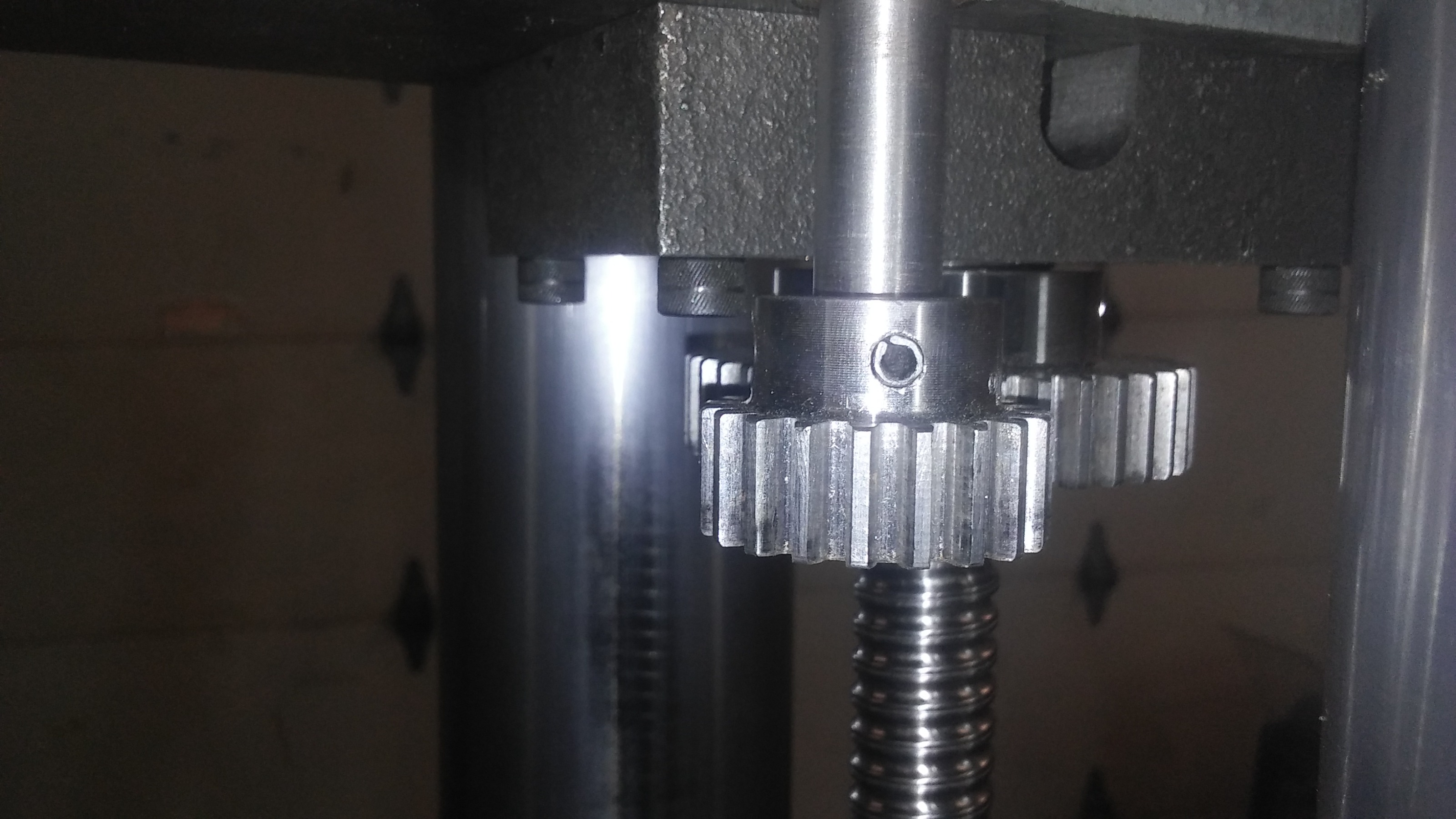

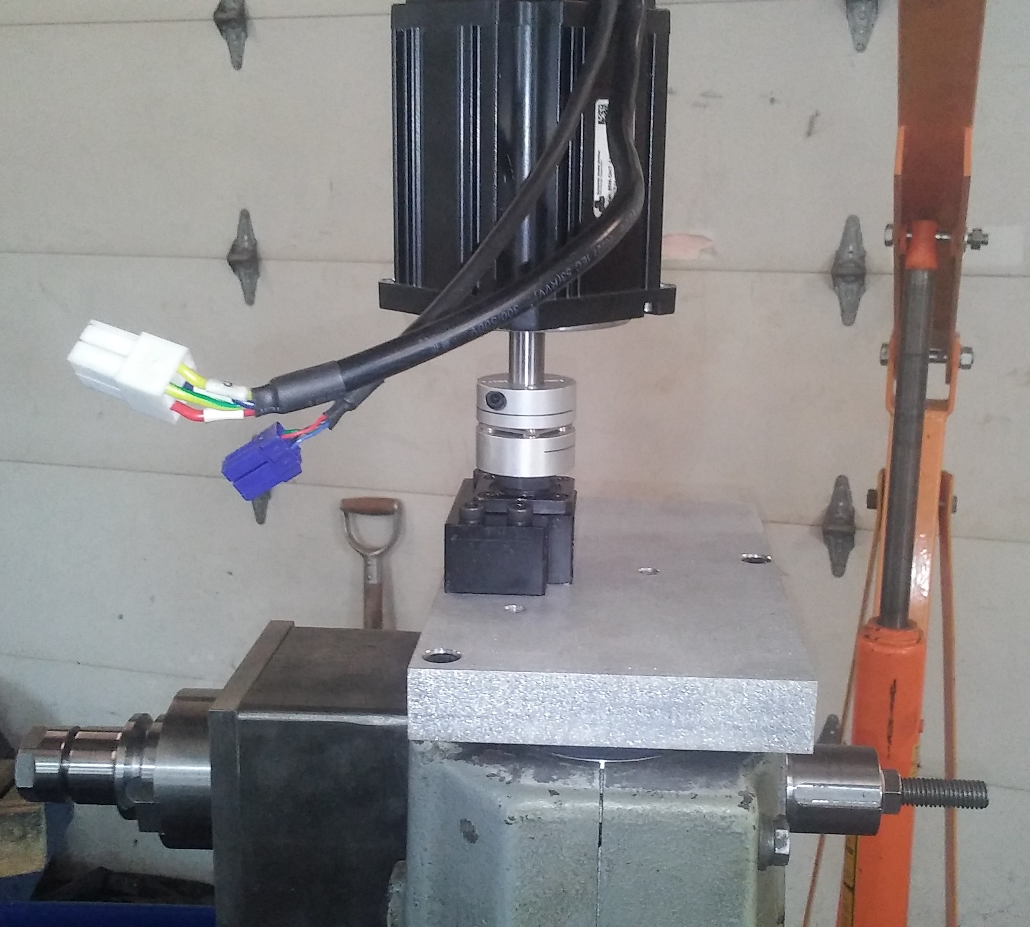

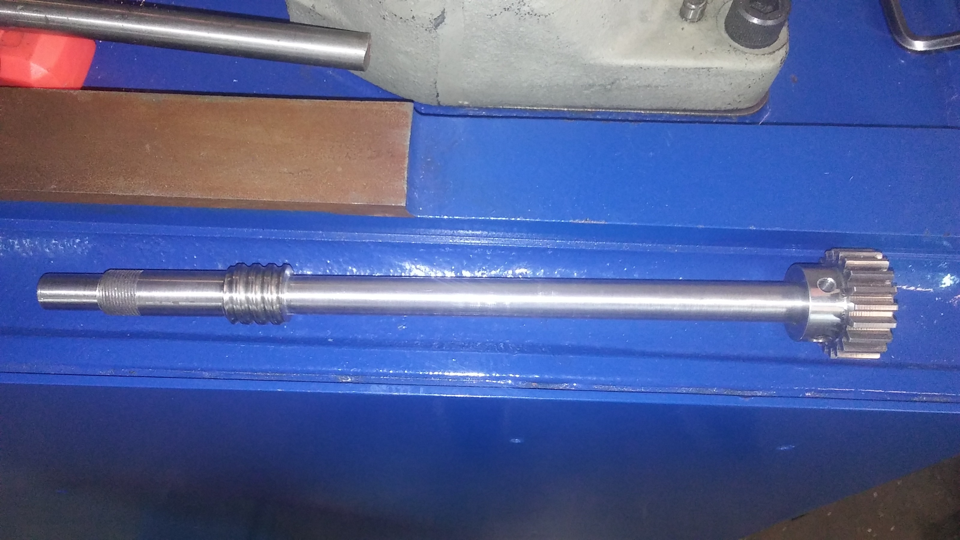

i spent some time working on the servo motor mount and pinion shaft to drive everything. the back driving seems to have stopped with the drive gear engaged and i can actually drive the head up with a cordless drill so a 1HP servo should have not trouble. i still want to play around with the air cylinder idea plus i have one coming tomorrow anyways. it's still good to have some kind of aid for lifting a heavy axis so i will try to make something of it .
the only down side i encountered was my mount for the servo motor. i can only get 3 connection points. not the end of the world just something i don't typically do but i have seen it done quite often so it is what it is. but now i know how long to make my stand offs and i will have to buy some longer cap screws for that part as well.
i had a extra short 20mm ball screw that i bought just for the nut for another project. i figured half the work was done so i decided to find a use for it since i had the bearing block for it. it was cheaper for me to buy the whole assembly rather than just the nut so it was just extra parts on hand.
i made some new wipers for the linear shafts the old ones were in pretty sad shape and the one came off in pieces so they were ready to retire after almost 50 years
Replied by machinedude on topic what to do with a free scrap dumpster find ?

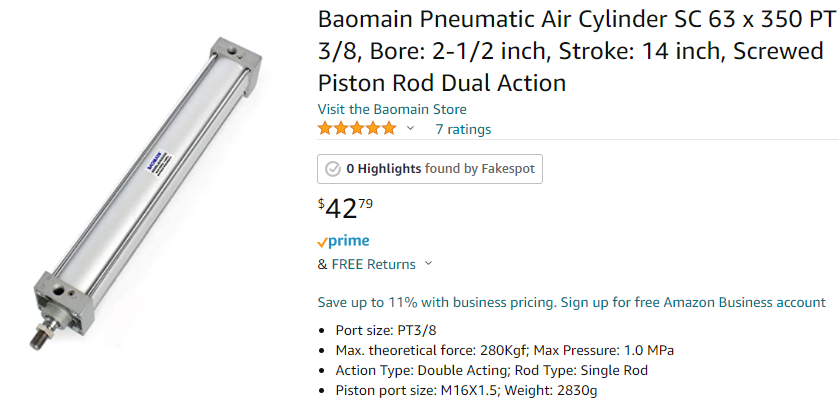

after looking at my old air compressor tank i think it is actually to big for this. more volume is good but i think it might be a 30 gallon plus tank which is to big to fit well anywhere. so i think i will just buy a portable air tank and use that instead. i found a 11 gallon tank for $60 which will fit much better behind the machine. a 5 gallon tank is about half that in cost so it's a toss up between the two.
i stared working on the mounts for the air cylinder but stopped at the base mount. i was just going to attach the threaded rod of the air cylinder to a mount attached to the head but decided to get a clevis pin so that had has a pivot point. i was worried about putting stress on the shaft if things were not perfectly straight.
fittings and everything else add up fast so it is not as cheap as i thought
i figured a regulator with a oiler would not be a bad idea either. i'm not sure what kind of oil would be best for an air cylinder so will have to look into that part some more.
so how i think things will work is the portable tank will act as an accumulator and the regulator will control my set point. i can get a pressure relief vale and add that on the accumulator side to blead off any pressure if it should go above my set point. you can get those in 5 psi increments so easy enough once the set point is determined.
i'm thinking you get constant force going up and down but you probably only reduce the head weight by maybe 60 percent. the part i am curious about the the amount of air loss? the return action is not used so that part either vents to or pulls a vacuum from atmosphere.
so as of now the cost is around $275 in case anyone is curious
i'm also going to take a guess and say having some force in both directions would help in the backlash department as well on this axis. tracking down the right fittings to seal everything up has been a treat too. everything thing here in the Sates is NPT but a lot to the cheap stuff you pick up on line is not so finding fittings is a pain in that respect.

I feel your pain re air fittings. I do remember thinking the tank was so cheap but spent about 4x its value on air fittings. Its another example of where the non-ISO US standards catch you out. You use NPT and the rest of the world uses BSP I have encountered this myself when fitting a similar air tank to my 4WD. I think you are looking at the pressure switch the wrong way. It should be there to ensure that the design pressure of the tank is not exceeded. Say its 100, 120, 150 psi whatever. Set the pressure you wish to use with a regulator. In my case, the tank was good for 180 psi so I used a 150 psi pressure switch so I had maximum air to seat a tyre and ran my air lockers from a regulator set to 90 psi.
To regulate different pressures for the up and down stroke, you can use a needle valve.
