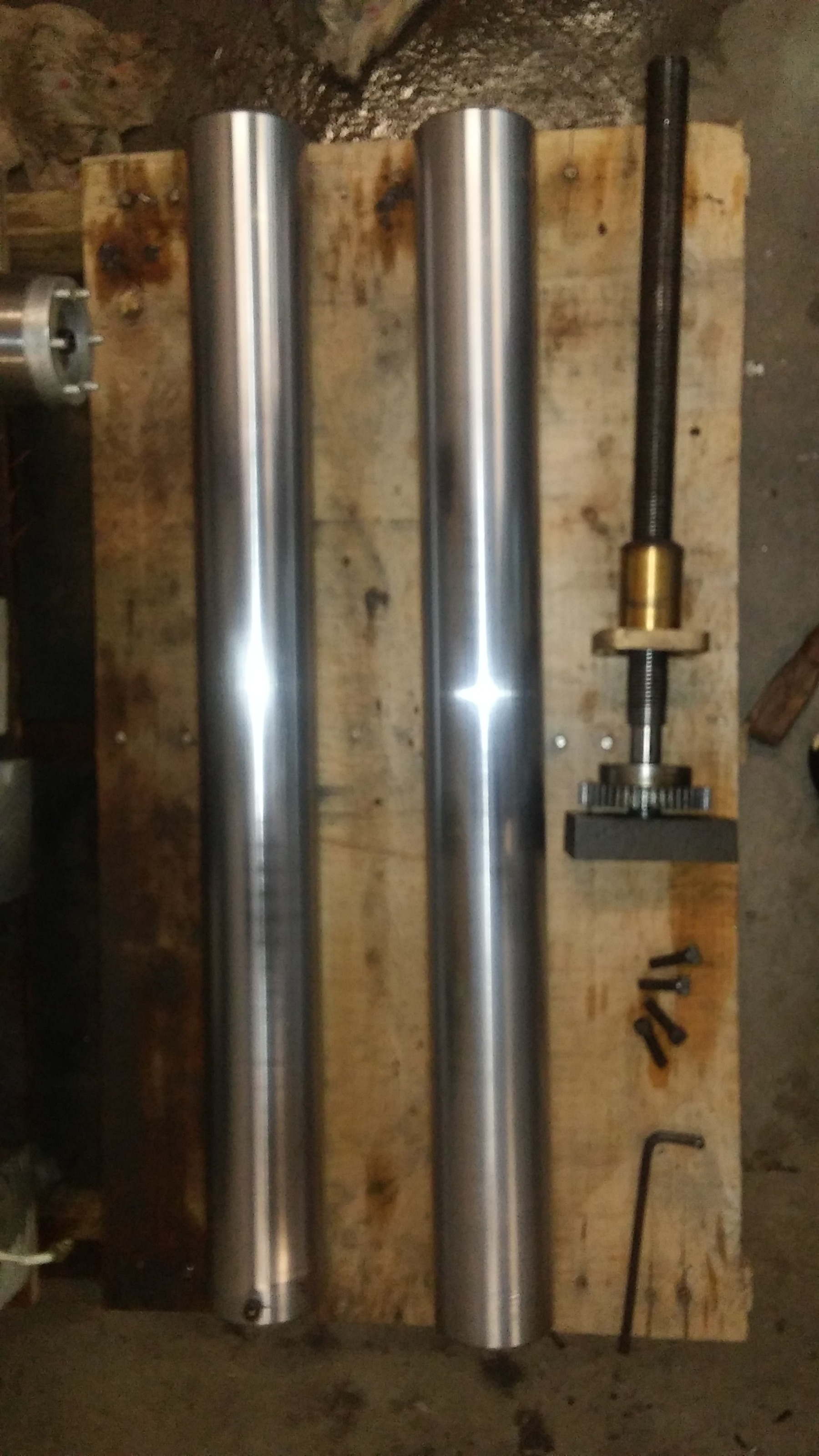

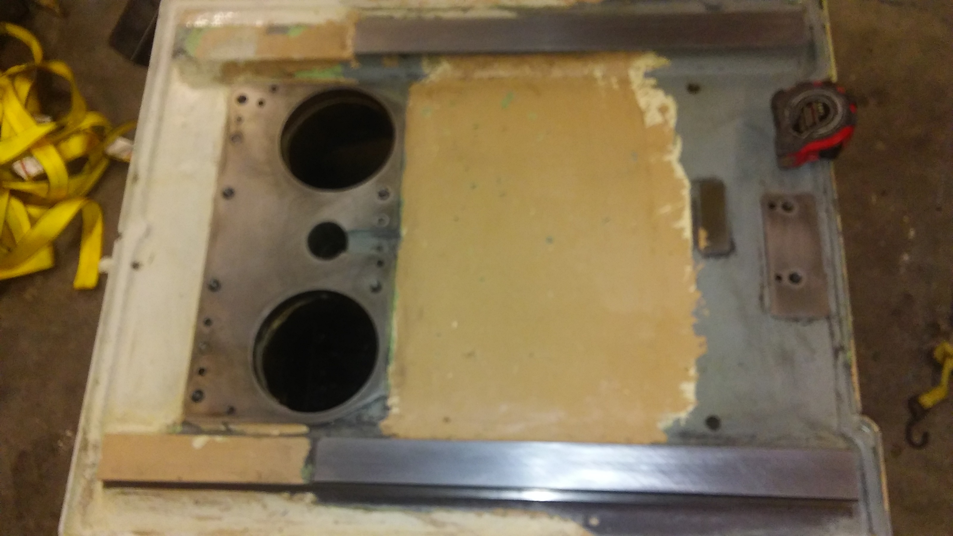

picked up a DoAll vs618-1 or what is left of one for free so now what to do with it

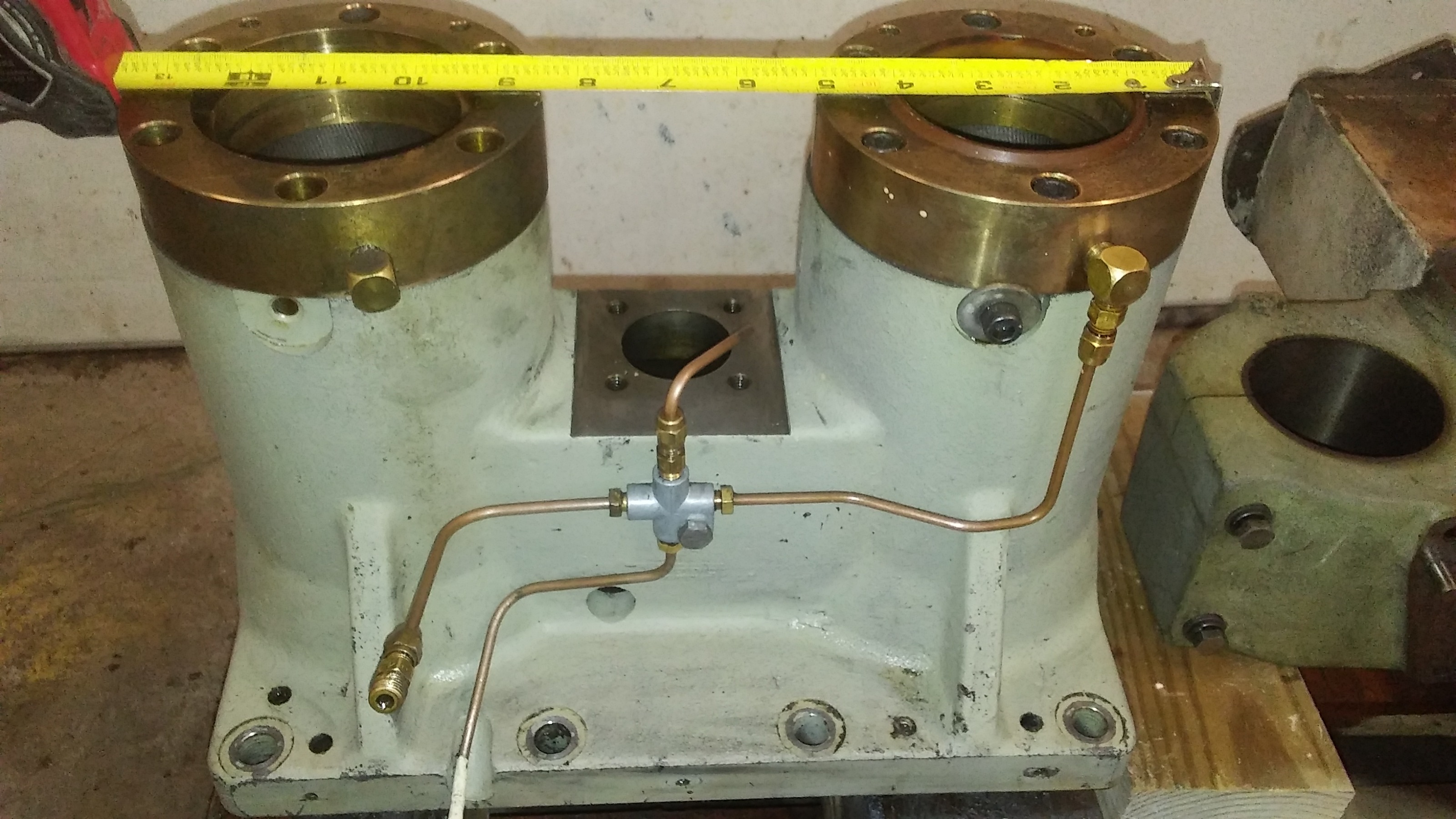

the grinder has seen better days and after busting down the machine and finding Rulon film lining some of the saddle ways and pricing the material and finding out it is not cheap by any means to replace it adds to the concern of is it worth it to restore as a grinder? the machine is missing some big price items like the hydraulic pump that drove the table and the magnetic chuck, the machine had a coolant tank at one point but not now.

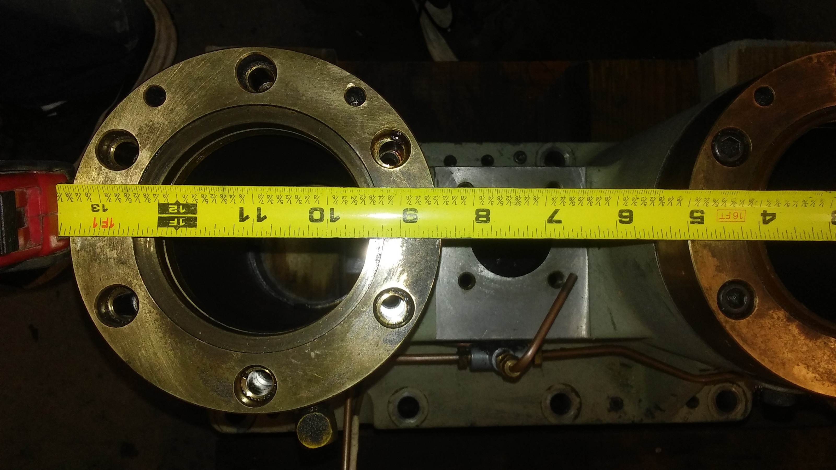

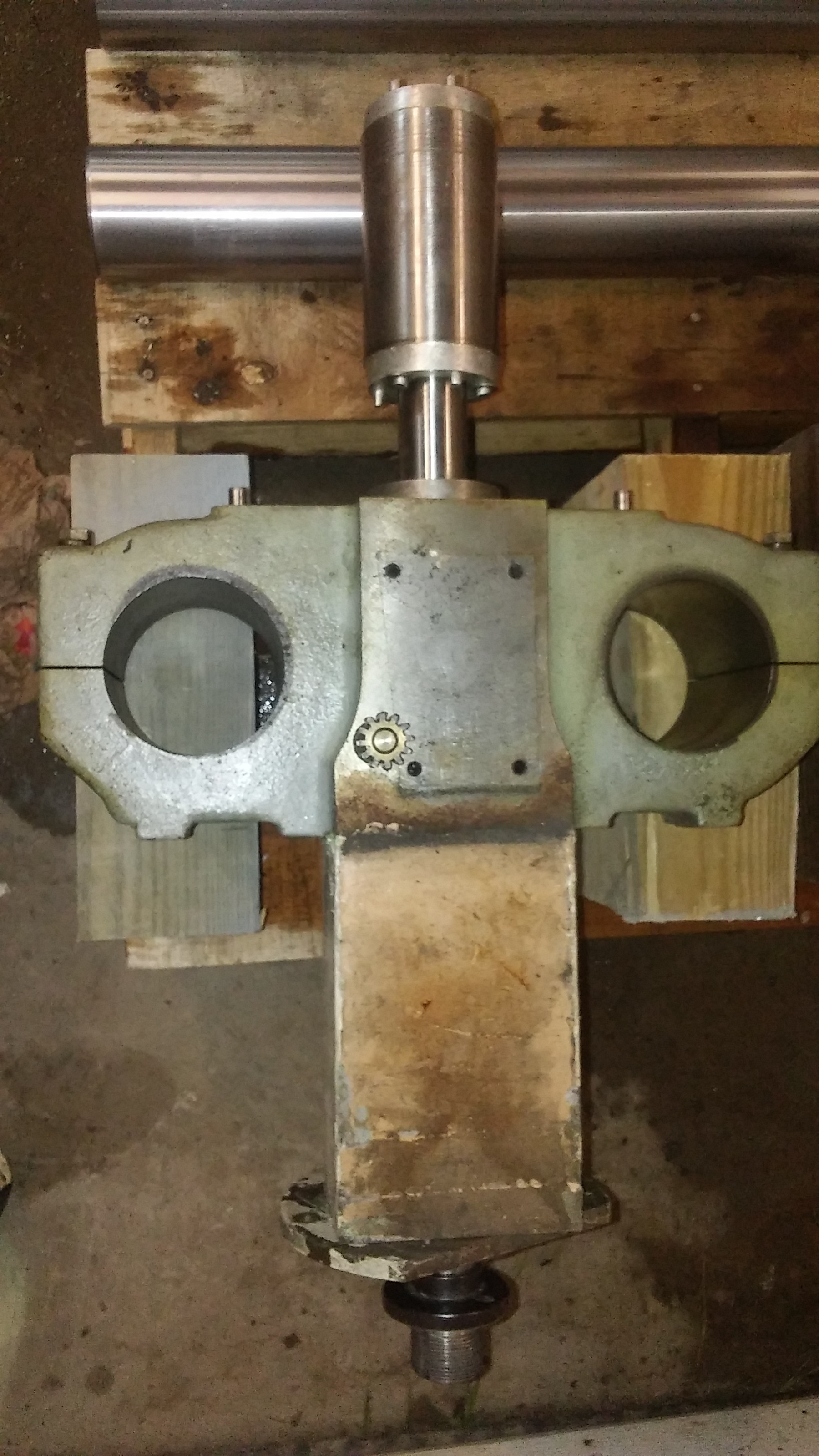

after looking at the castings and how the machine was made i am leaning hard in the direction of turning this thing into a horizonal mill which i would have far more use for than a grinder. the spindle would need to be redone but the casting could be modified for a new design on the spindle.
last ting i need right now is another project but this was one of those deals where you take it or leave it and free was hard for me to pass up

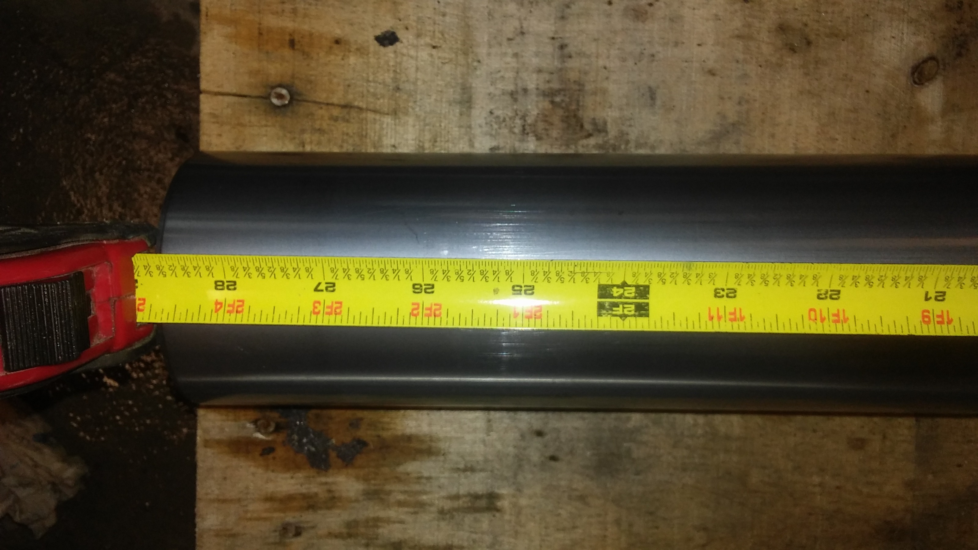

as is the machine is about 1600 lbs and the two columns are 3 " daimeter thick walled tube with a 3/4 wall thickness. i think the columns are pretty substantial for the size of the machine.

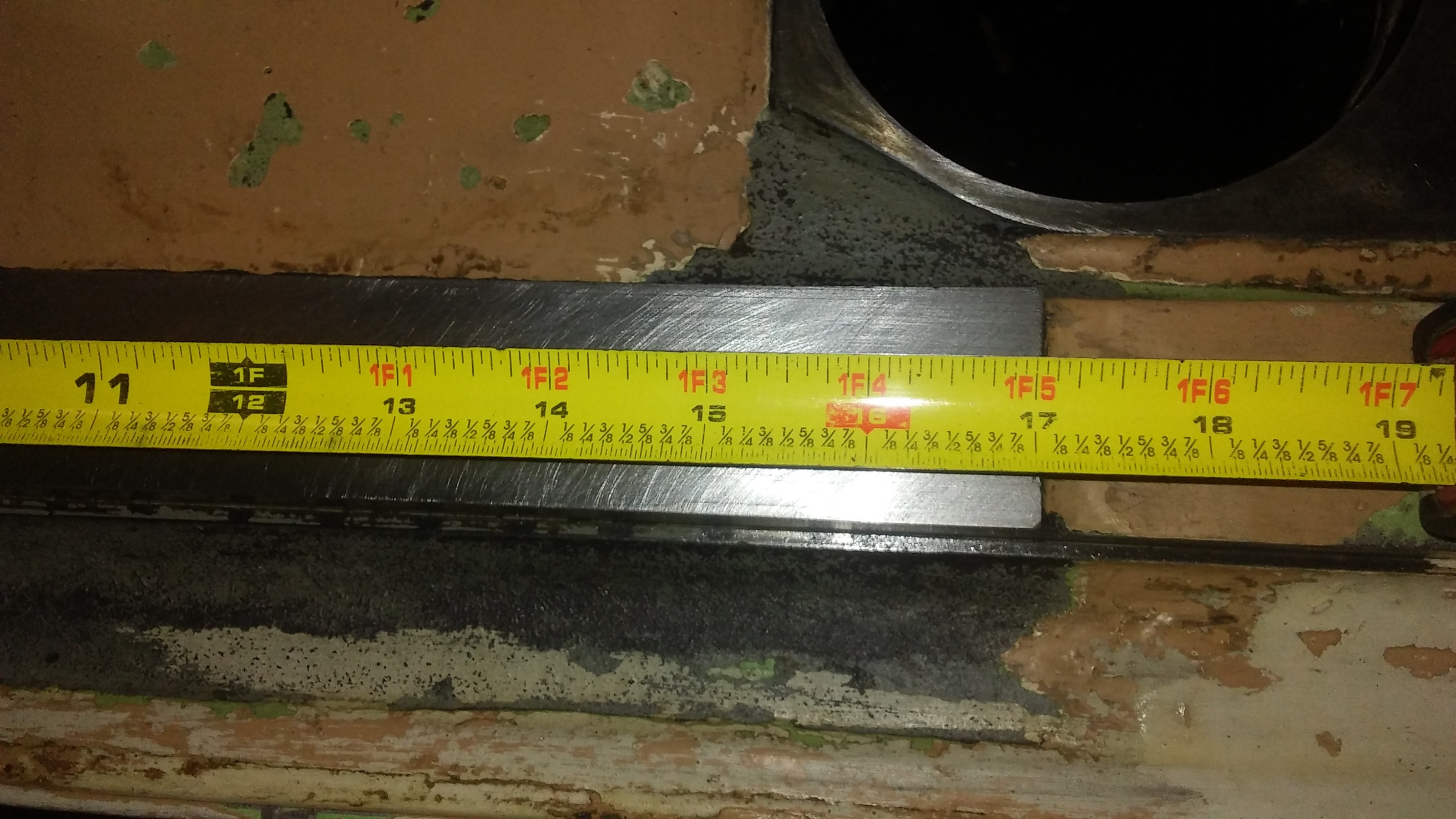

yeah the saddle and table are with it the only thing missing was the magnetic chuck that was on it. the saddle has out riggers cast into it that extend around the bearing assembly so i think i can get around 30" x 18" x 16" of travel as a horizonal machine. this grinder has quite a bit of head height @ 18". i was talking to one of the guys at work about travel on the Mazak machines and his only has about a 20" x 20" x 20" envelope. so i could make a small Bridgeport size horizonal i think with close to what the Mazak's at my work have in relation to travel.

back in the day tool and die was still around in some volume and i got into grinding. i had never done it before hand so i had no clue on how hard it was to swing handles all day. by the time the day was done your arms and shoulders were reduced to jello
the only thing that concerns me with a cnc grinder is a mishap and having a wheel explode in my face plus things would have to be supper tight with absolute zero backlash since the cuts are so small with grinding. anything more than .0001 or .0002 could be a problem.
i was cleaning up the saddle and table and seen the table may not be as easy as i was thinking to put rails on for a conversion so that area will require some more thought before i do anything drastic once i start on a path i'm pretty much stuck going that direction.
most of the wear is in the table. i took the Rulon off the ways on the saddle and under was in very good shape but the Rulon i took off was really bad and the table ways it rode on were really badly worn. with no Rulon liner all the heights off now plus this grinder has been worked on before and some things on the screw have been altered. someone has taken material off the bottom of the brass nut and there where shims under that nut because they must have took to much off?
i can machine things to where they need to be if i convert this thing and keep things close enough for milling but i have my doubts about keeping things close enough for grinding with the equipment i have in my home shop. splitting 1/10 ths is a whole different animal. after taking about 10 layers of paint off this thing i can see machined surfaces that will keep me square to the existing machine so reworking things on a milling level is not a problem. even having room for ball screws is not an issue since the casting has lots of room to work with.
i think the grinding spindle is ok but i can't say for sure i have used this machine as a grinder at work and it had some major finish issues. so i know a little more about the weak points of this machine than most would with a random machine.
i think at the very least you would need a 2 foot x 3 foot class A surface plate and a good indicator half a 1/10 to get this thing back to grinding along with lots of time hand scaping and could find that issues with the spindle might be the problem after all ? although i think it's in the table at this point. i did feel the spindle but have not put an indicator on it at this point yet.
this thing is a distraction but after 2 years of looking at the other stuff it's nice to take a break from it and have something else to look at so it's not all bad.
