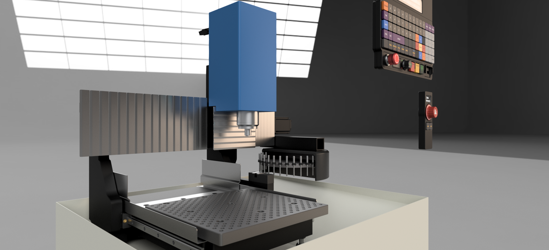

26 Jun 2024 02:11 - 26 Jun 2024 02:12 #303812
by ihavenofish
Replied by ihavenofish on topic Mini wannabe datron build
Ride along tool mag. I was having issues finding a sensible way to mount a more simple side tray mag, because having to grab the tool shank means you need very precise positioning. Makes it a lot easier to just have it ride on the Y axis. Holds 15 cutters up to 8mm and 100mm long. it is a half moon mag so it will spin and close itself out of the travel area with no need for any air cylinder. The laser tool setter is inboard of the mag. It needs some sort of retracting cover to keep chips off it. It has an air blast inside to keep the laser line clean. Cover should be opened mechanically by axis travel into the atc zone.
I think the magazine itself will be SLS nylon printed. That should be fun all by itself haha. (the blue spindle/z cover will also be nylon as well as the mounting parts for the way covers.

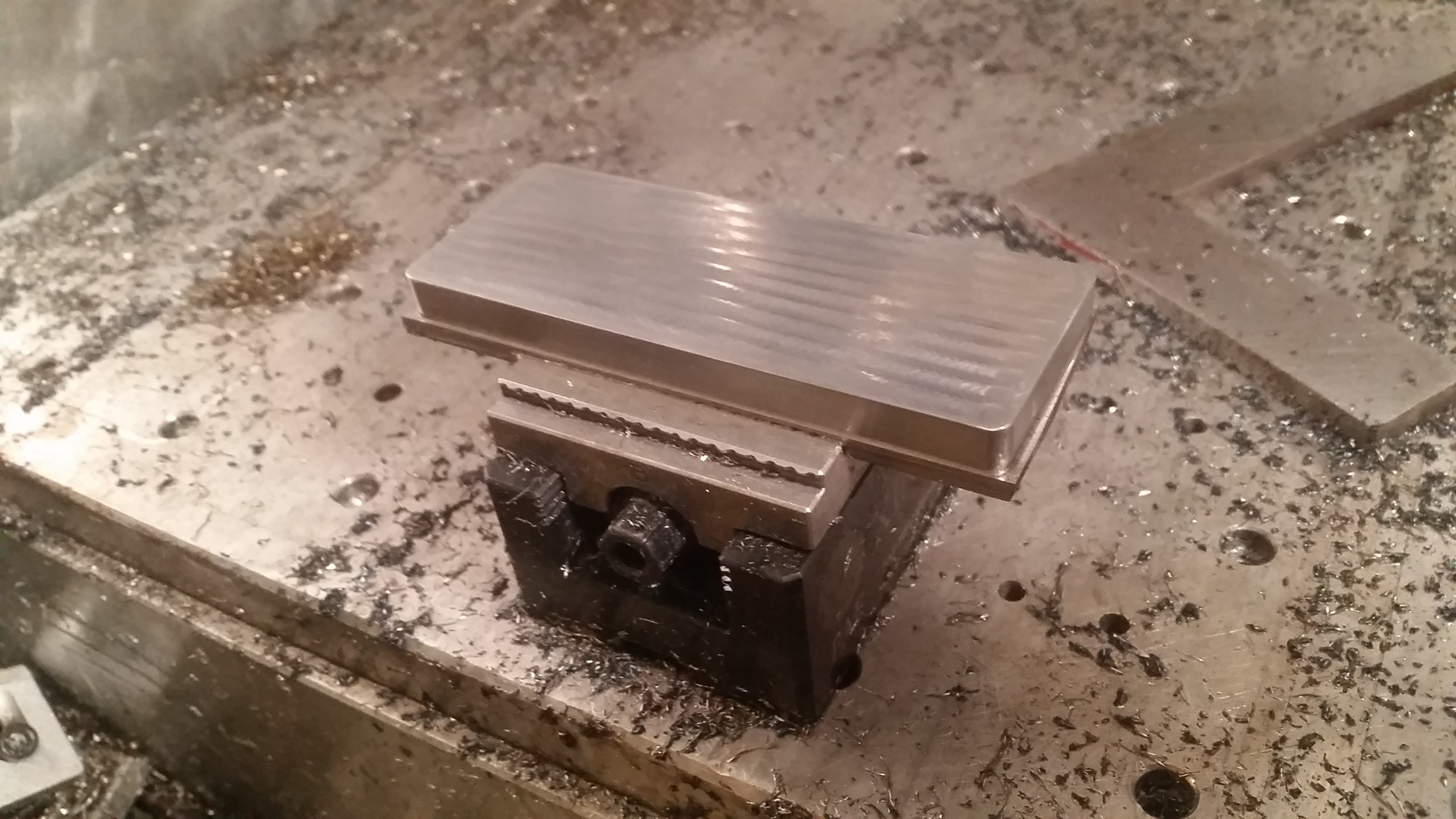

26 Jun 2024 19:55 #303861
by ihavenofish
A little testing of depth of cut.
29mm deep, 0.3mm step over, 4119mm/m, 36000rpm.
There is a lot of deflection. Some from the cutter, some from the machine, and some from the spindle. Didn't measure but id say at least 0.002" at the bottom of the cut. Picture is after climb, then back conventional, then climb again at 4119mm/m which fully cleaned it up.
I think this is near the practical limit of depth on the prototype machine. I had to cut the end mill shank down to remove any excess stick out. The stock tool was 35mm or so longer and would chatter and deflect a lot on 1/10 the feed. Doesn't chatter now that its shortened.
Can't wait to try some adaptive clearing with this cutter now.

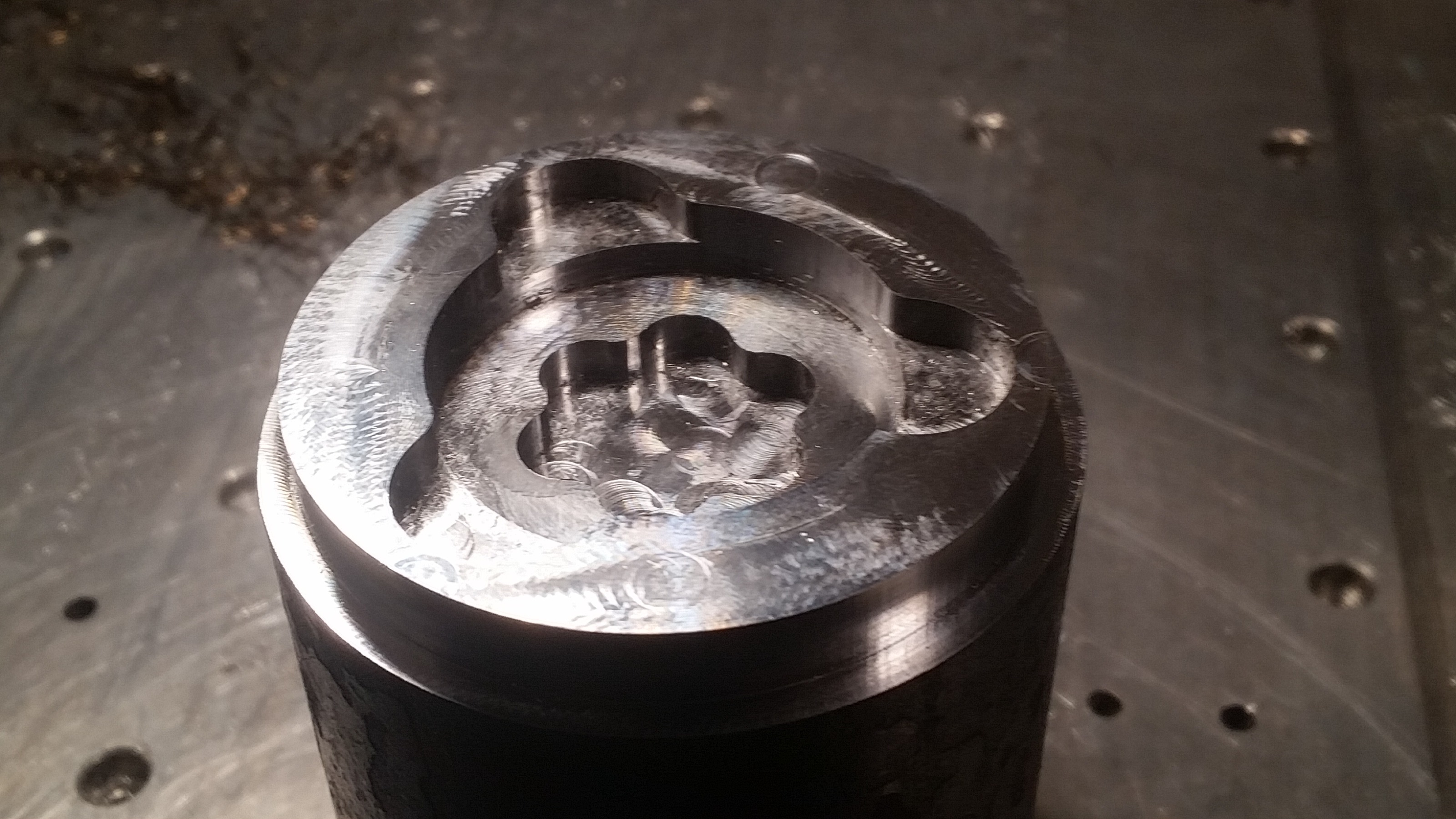

For my next trick: O-1 tool steel (soft).
This is the first proper "sample part" I am going to video to market the new machine. Just waiting on my 4mm end mills to come today or tomorrow I hope.
I expect only one real issue with the fine surfacing on the steel and that is the lack of jerk control and stepper tuning. It will probably leave marks at transitions is my expectation.

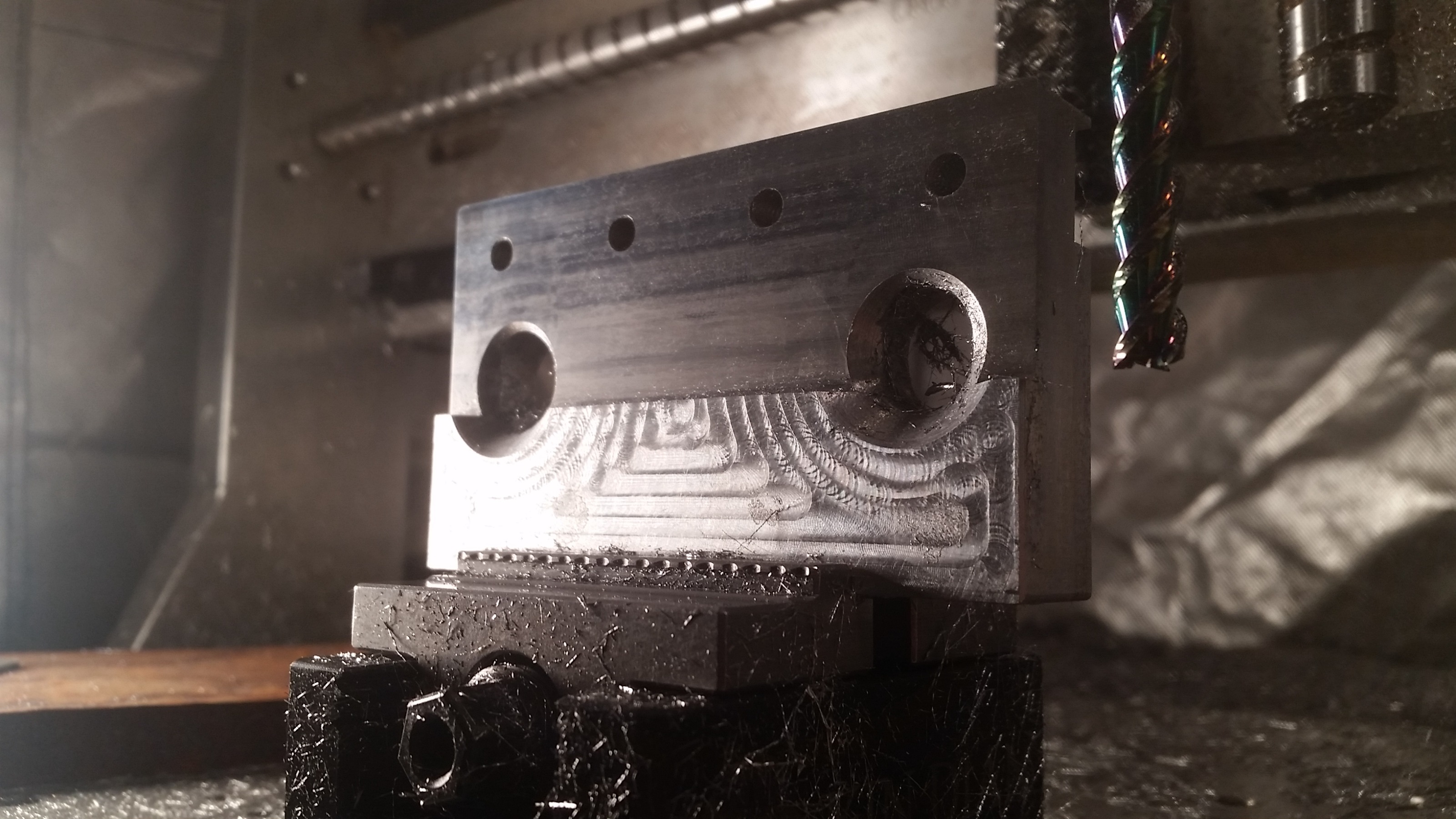

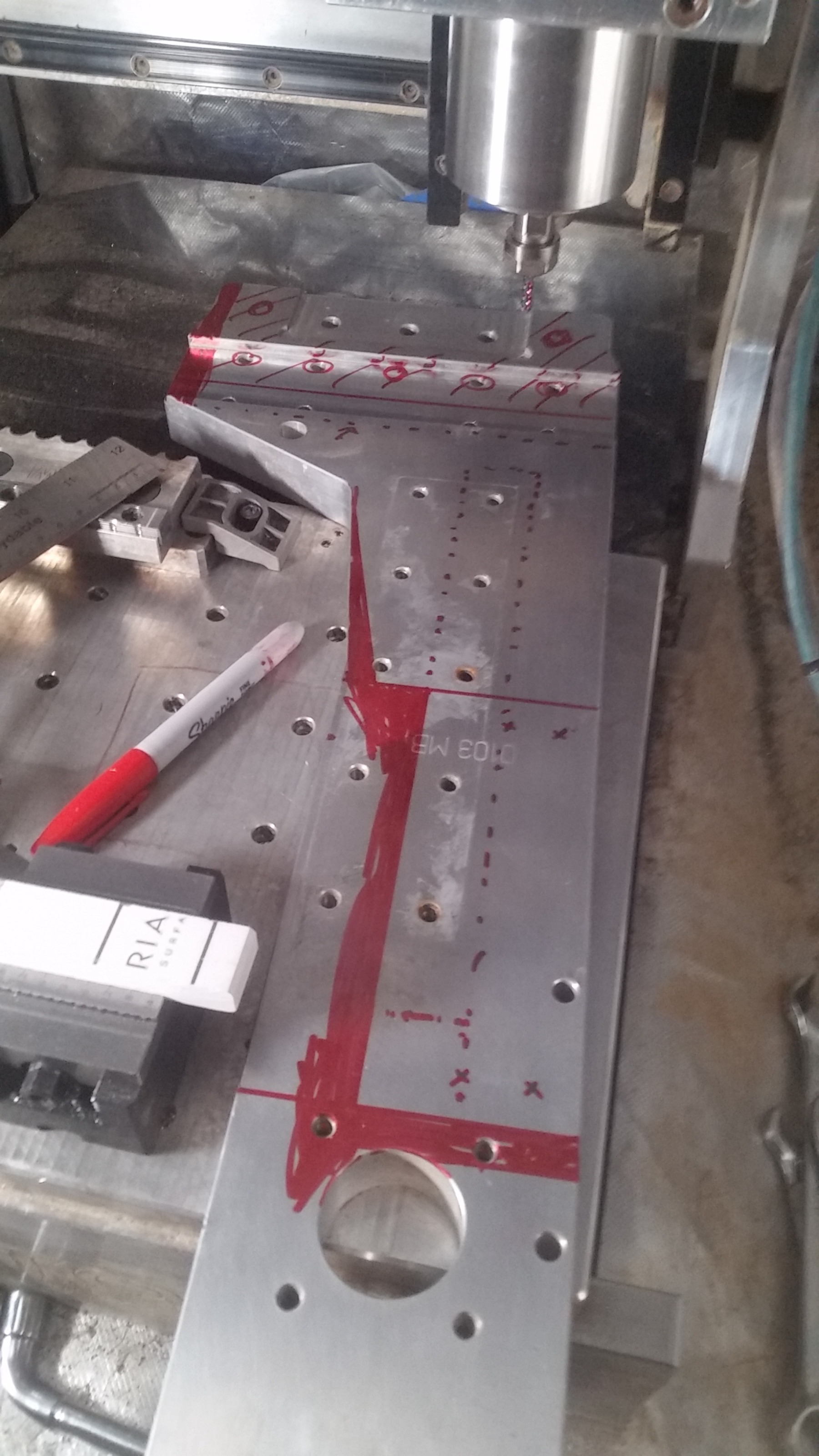

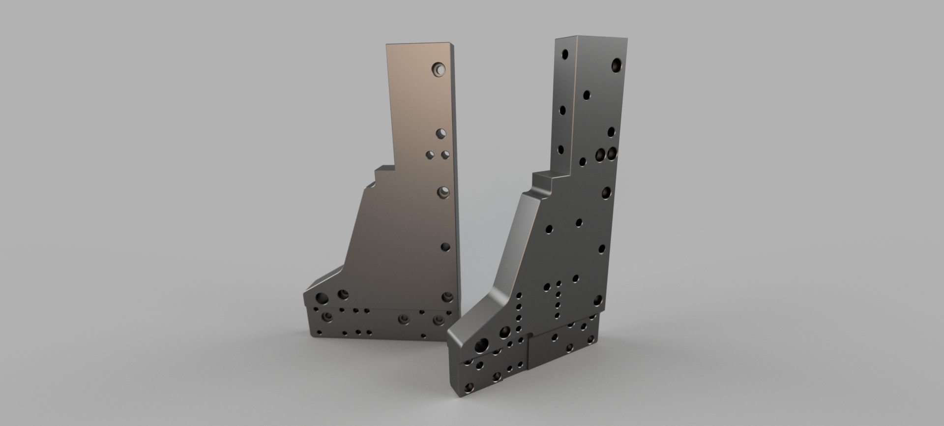

29 Jun 2024 16:12 #304059
by ihavenofish
Uprights for V1/V2 minimonster. V1 is single drive aluminium base frame, V2 is dual drive, granite base, these uprights can be used for both. As you can see, for this first one I am re-milling out of the old large predator uprights. Not reusing any features, just working around the holes to use it as stock.
I'd already made a Z axis, but I went and changed a few things on it, so I need to make another.
