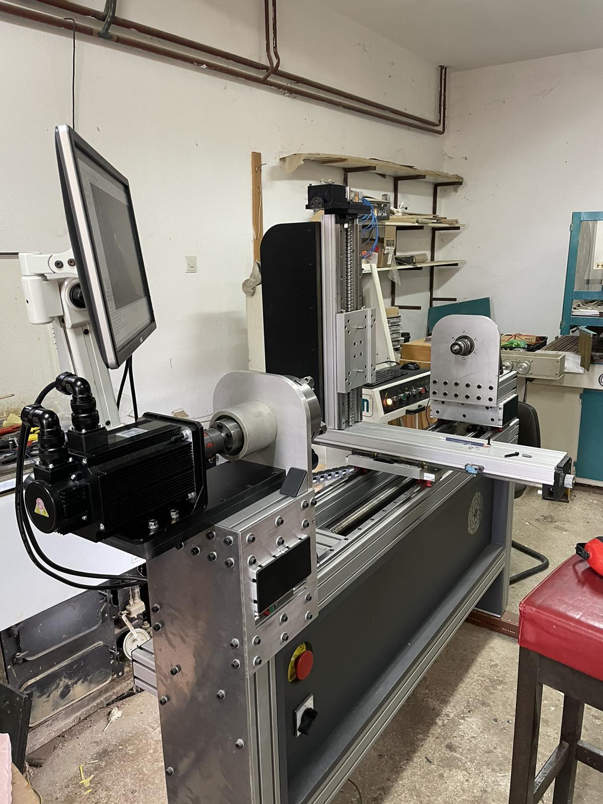

The perfectionist in me is screaming "Beef up the X-axis"!
- Masiwood123
- Posts: 423
- Thank you received: 93
10 Sep 2022 16:33 #251650
by Masiwood123
Replied by Masiwood123 on topic epoxy granite cnc lathe

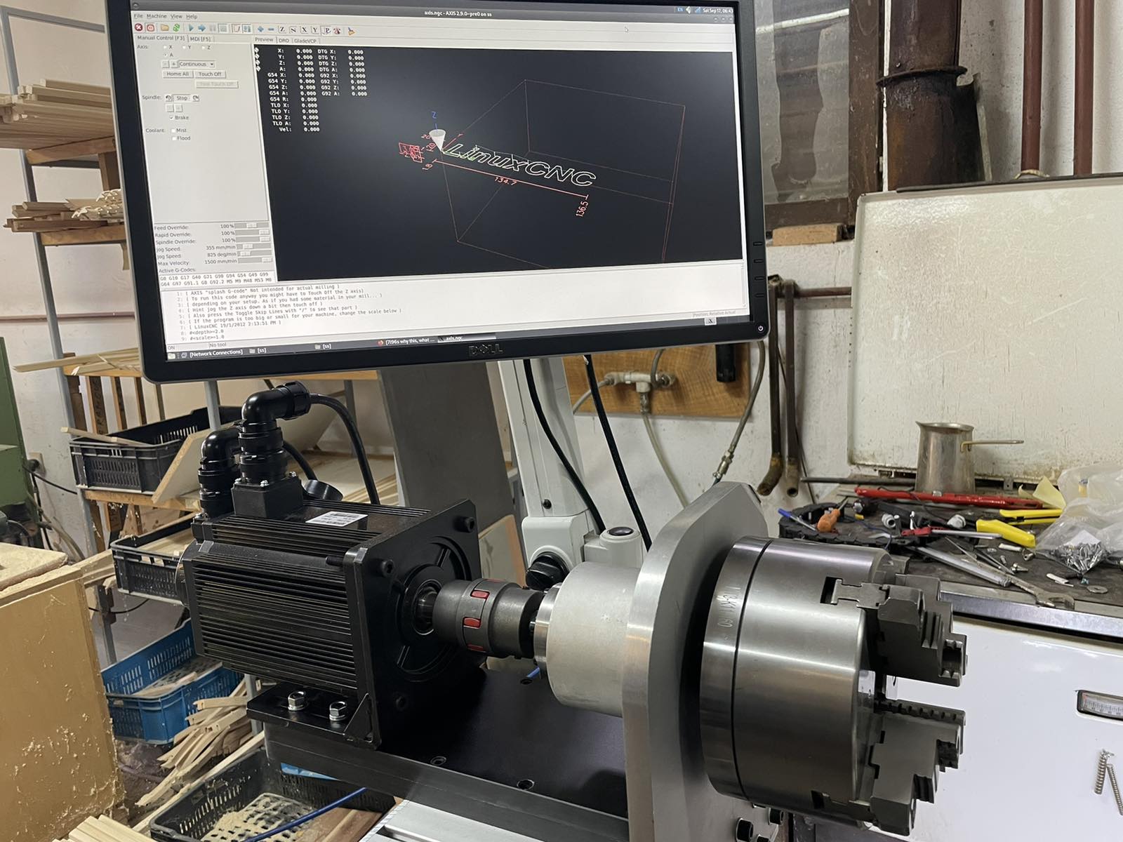

I agree i should put stronger X but I thought I wouldn't work with metal. The plan is to have two machining motors on the y axis, one with a saw and one with a router bit, on the opposite side there will be a heavy classic knife holder to balance it. on X Axis .Tailstock should be Z axis..I am planning this lathe for making some smaller pieces of wood and primarily the main spindle as the A axis, I have to figure out how to connect it so that it can also work as a spindle (S command to main main motor, instead of A) because the piece needs to be cut at the end with a classic knife.

Your headstock is going to be the weakest point.
You have a thin plate holding the spindle.
Look at every lathe headstock. There is a reason they are long and beefy and are not just a thin plate with a spindle mounted to it.
- Masiwood123
- Posts: 423
17 Sep 2022 09:25 #252171
by Masiwood123
the spindle is not mounted on that plate, the plate is only held by this aluminum cylinder which is inside with three bearings and an internal fi60mm, the spindle has an MT3 tail with a fi30mm adapter and goes the entire length of about 150mm through the bearings. I agree that the plate should be a little stronger. all in all, I rarely use full rpm, the headstock is primarily an A axis and will be used primarily for woodworking.. and maybe I will additionally strengthen it with some metal diagonal, otherwise the whole assembly seems light, in fact it weighs over 200 kg with epoxy..

New update A axis connected but a mechanical problem appeared..I will try to solve the driver settings first..

A and S command works..
Done with output from Mesa 7i96s, to AASD servo driver settings, to change position/speed mode on driver input.

..in this case I didn't use hal, I'm just a beginner, but since I didn't know anything, this is great. As for the configuration in this case, it's all down to the poor Chinese manual for the ASSD driver of the servo motor, the basis is that at the beginning I thought it could only work in 3 modes position/speed/torque.. I listened to your old advice to rest for a day , the next night I read the instructions from beginning to end..every parameter..in the end I realized that the driver has the possibility to change the mode of operation through the input..it is possible to switch from position to speed, but there is one more thing..it inputs in the driver are already factory set to default. they have to be allocated.. (if someone needs parameters I will be happy to help also will attach all hal/ini)... then I connected the output from the Mesa 7i96s to a relay that changes the operating mode on the driver from A (step dir) to S (speed ) .In the gcode, it is only necessary to enter M64 P0 for example and the output activates the input on the driver, change the operating mode and after the m64 command, put M3... follows the S command. Considering that I have no need for accurate indexing, this one has exactly what I wanted for me. Thanks Tom, I'll probably need help in the future with connecting the MPG.. when I get it all done with axis... than Mpg in the end.. beer is always ready if you're up to it Nis get in touch-

Today I have an idea that I might implement, but I need some advice. the plan is to install an encoder on the knife holder so that with scaling it can read a full 360 degree circle. I would make a reference knife that would be 0 degrees to z or x axis, and in order to manually rotate the holder, a vcp should be made on the screen, that would show the dro encoder reading, referenced to that zero. is it possible to do that, since the spindle encoder input is not needed on the 7i96s would I use it? thanks for the support again with how to configure Hal.
