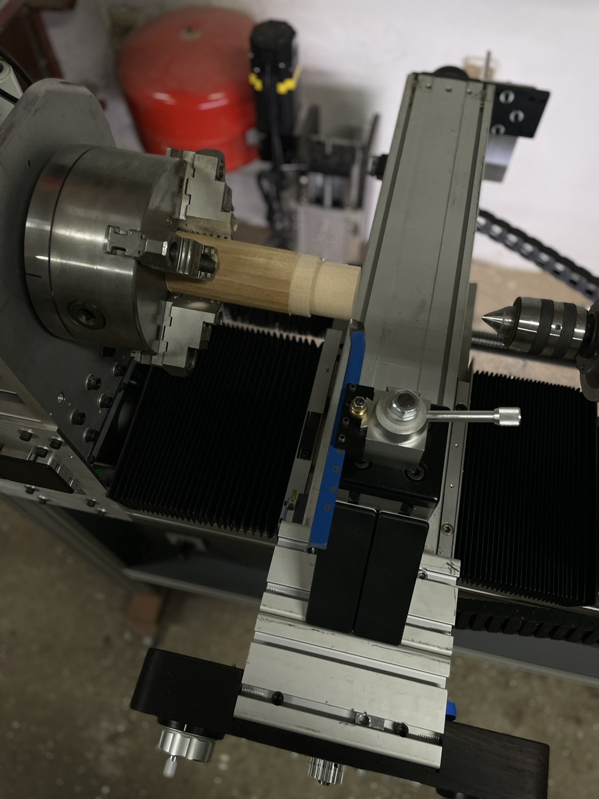

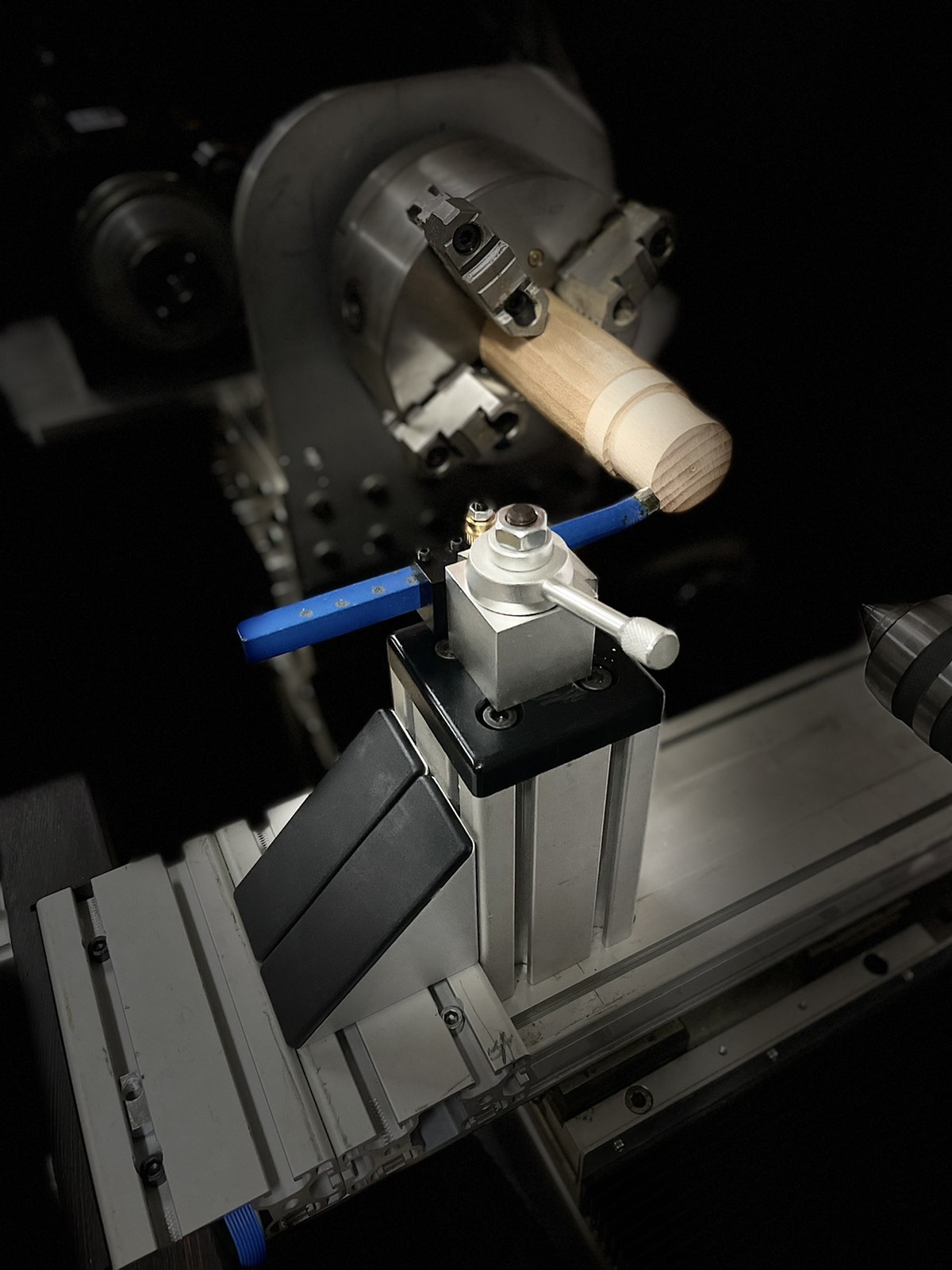

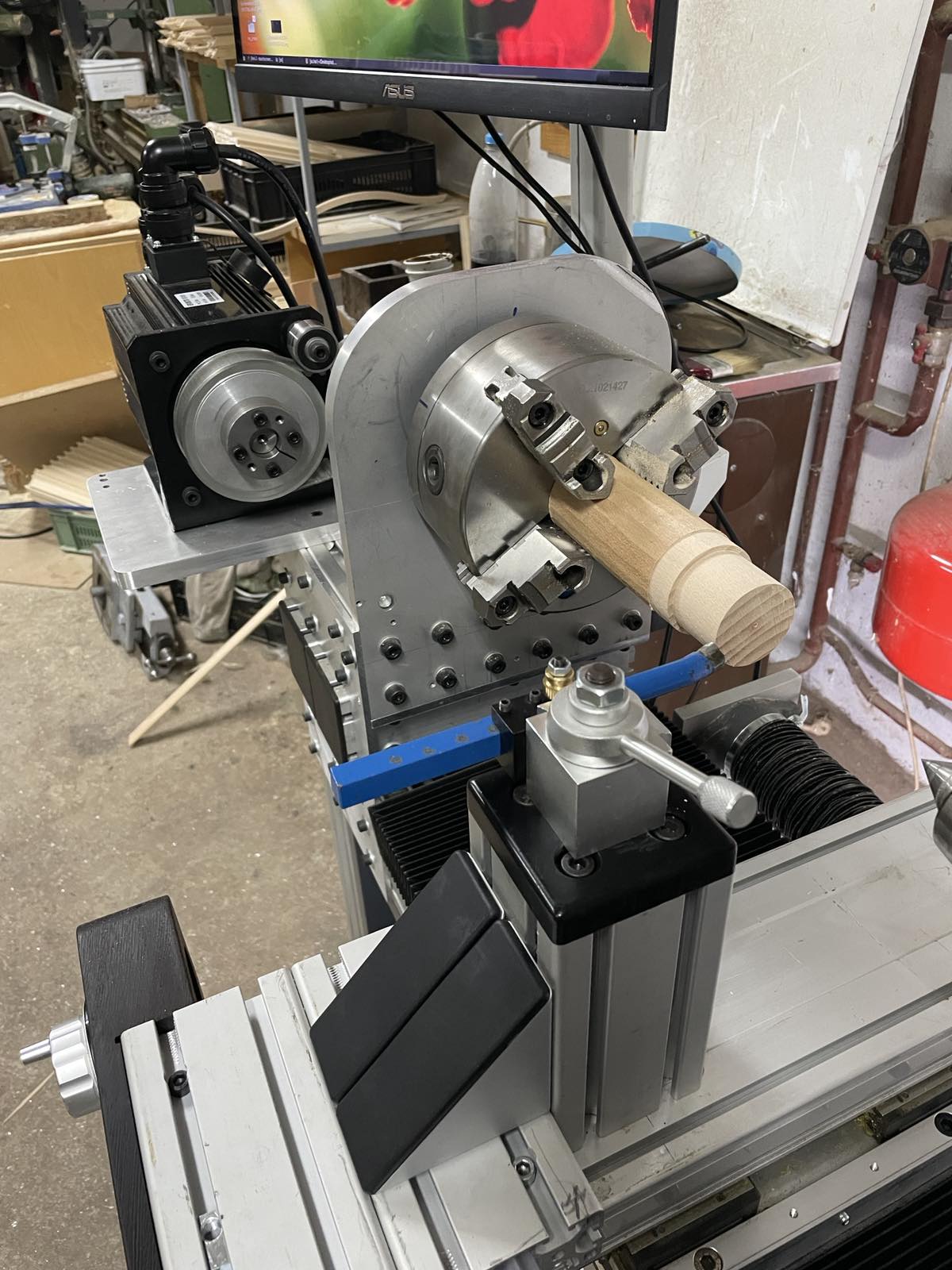

27 Oct 2022 12:31 - 27 Oct 2022 12:32 #255207 by Masiwood123
Replied by Masiwood123 on topic epoxy granite cnc lathe
I played a little today manually with mpg, with the Chinese carrier the results are good. i'm waiting for multifix, to finish the Y axis and i'm almost done.
Last edit: 27 Oct 2022 12:32 by Masiwood123.
The following user(s) said Thank You: arvidb, tommylight
  • tommylight
  • tommylight's Avatar
  • Away
  • Moderator
  • Moderator
27 Oct 2022 12:53 #255214 by tommylight
Replied by tommylight on topic epoxy granite cnc lathe
What, no video?
I am disapointed! :)
Cuts look clean, so no vibration as far as i can see on the pictures, nice.

27 Oct 2022 13:04 #255217 by Masiwood123
xD ..video for another day when i play the auto mod;) ,
I will quickly draw a chess figure and document it, since everything is around the knife holder
all a bit weak'' even the holder accepts only 12x12 mm, i am satisfied with the processing ,and that by hand.
