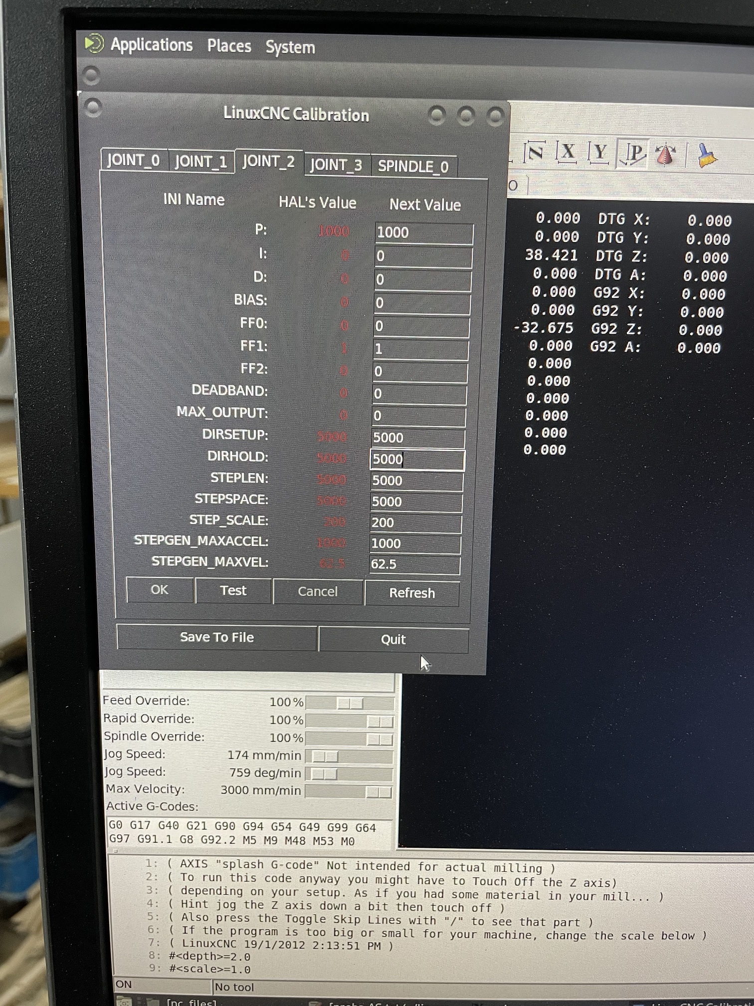

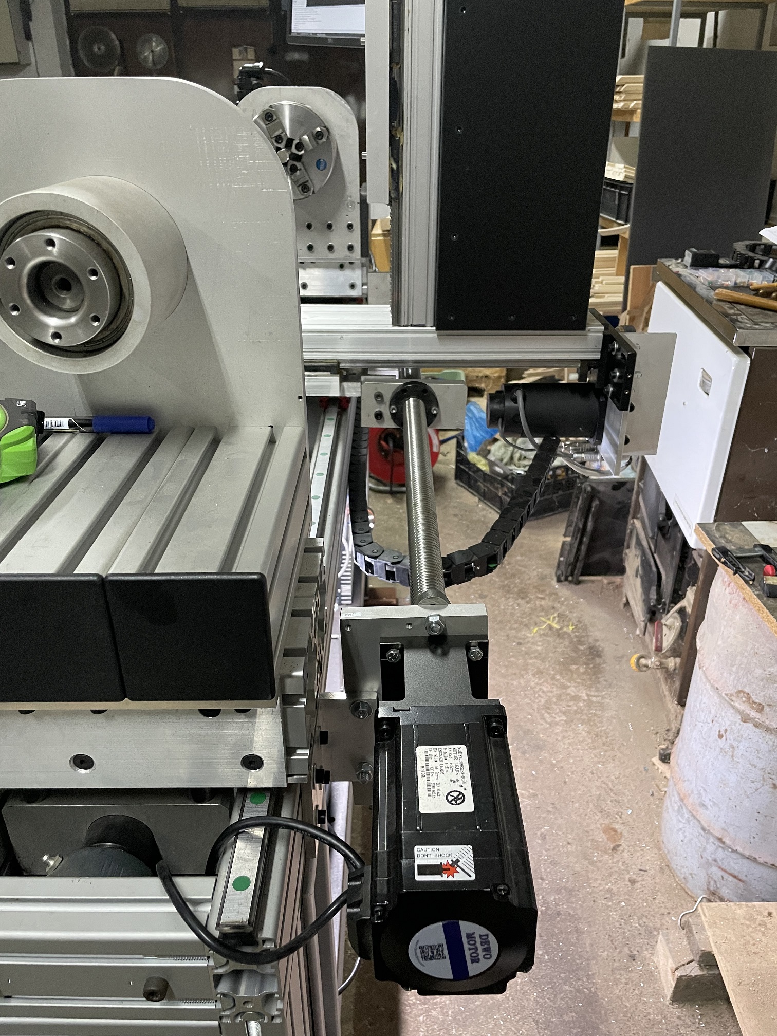

jogging
youtube.com/shorts/ObnzluSeB4Q?feature=share
MDI youtube.com/shorts/PqXwrarzofU
today I installed the longitudinal axis, I have a problem, in long press jogging mode the machine skips, jumping (see screwdriver) no matter what the feed is, in MDI mode for example g1 z200 f1500 works smooth. I tried changing the acceleration, from 100-1000, at 100 (joint following error) between 100-1000 there is no error, but there is no difference either. Anyone with an idea what it could be?
Last edit: 02 Oct 2022 15:55 by Masiwood123.
- Online
- Posts: 22037
- Thank you received: 7505
02 Oct 2022 16:08 #253288
forum.linuxcnc.org/38-general-linuxcnc-q...elocity-fluctuations
Replied by tommylight on topic epoxy granite cnc lathe
That is a keyboard issue,I have a problem, in long press jogging mode the machine skips, jumping (see screwdriver) no matter what the feed is, in MDI mode for example g1 z200 f1500 works smooth.

Hvala:)! I tried to add another keyboard (otherwise I use a wireless one), I also tried with a wired usb, it's the same. now I will read your answer and then I will try to solve it tomorrow and report back. thank you very much!
- Masiwood123
- Posts: 423
- Thank you received: 93
03 Oct 2022 05:39 #253332
by Masiwood123
Replied by Masiwood123 on topic epoxy granite cnc lathe
Prblem resen sa ovim xset-r, kad dolazis na to pivo>!

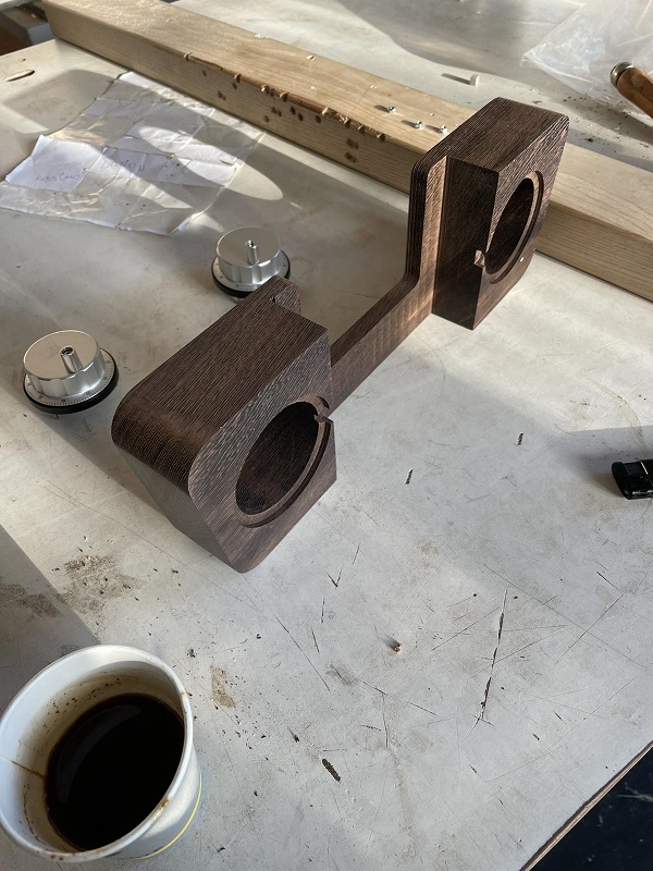

- Masiwood123
- Posts: 423
09 Oct 2022 10:00 #253810
by Masiwood123
I completely agree, casting iron absorbs vibrations the best...unfortunately, I don't have the conditions for it, nor does anyone in my area. I would be the happiest if I found some locatelli, for example, for a retrofit. by the way, what I am making is not for a hobby, but it is also not for metal or any such precise processing, I need it for some smaller series of some smaller wooden pieces. I will mainly use the headstock as an A axis, and as a spindle only at the end of the operation, for cutting pieces. In what sense do you think the headstock is not suitable? the shaft is fi 60mm with two bearings, with a 30mm adapter on the MT3.
- vre
- Posts: 613
- Thank you received: 17
09 Oct 2022 11:07 #253812
by vre
Replied by vre on topic epoxy granite cnc lathe
if it is not for metal but for wood then its ok
for metal needs very strong headstock bed support etc
