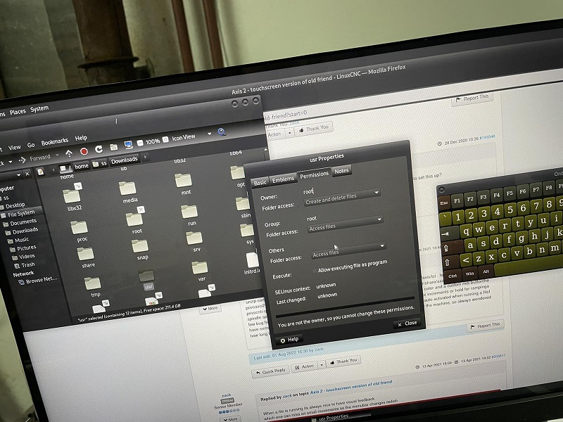

new crew member, ASUS 21.5'' VT229H Touch..all system works on touch, on axis gui, slider jogging, tabs works..how to get onscreen keyboard, or need to implement touchy gui?

sudo apt-get install onboard
Then on the "accessories" menu.
Has plenty of stuff to configure, like transparency, size, type, start at boot, etc.

ooo thank y! google doesn't know, I've been searching for half an hour without success, I was already falling asleep, tomorrow I will continue with the game:)

You don't want to change permissions of the /usr folder, it's meant to be owned by and managed by root. It's very unusual to have to paste files there. What is it that you are trying to do?
