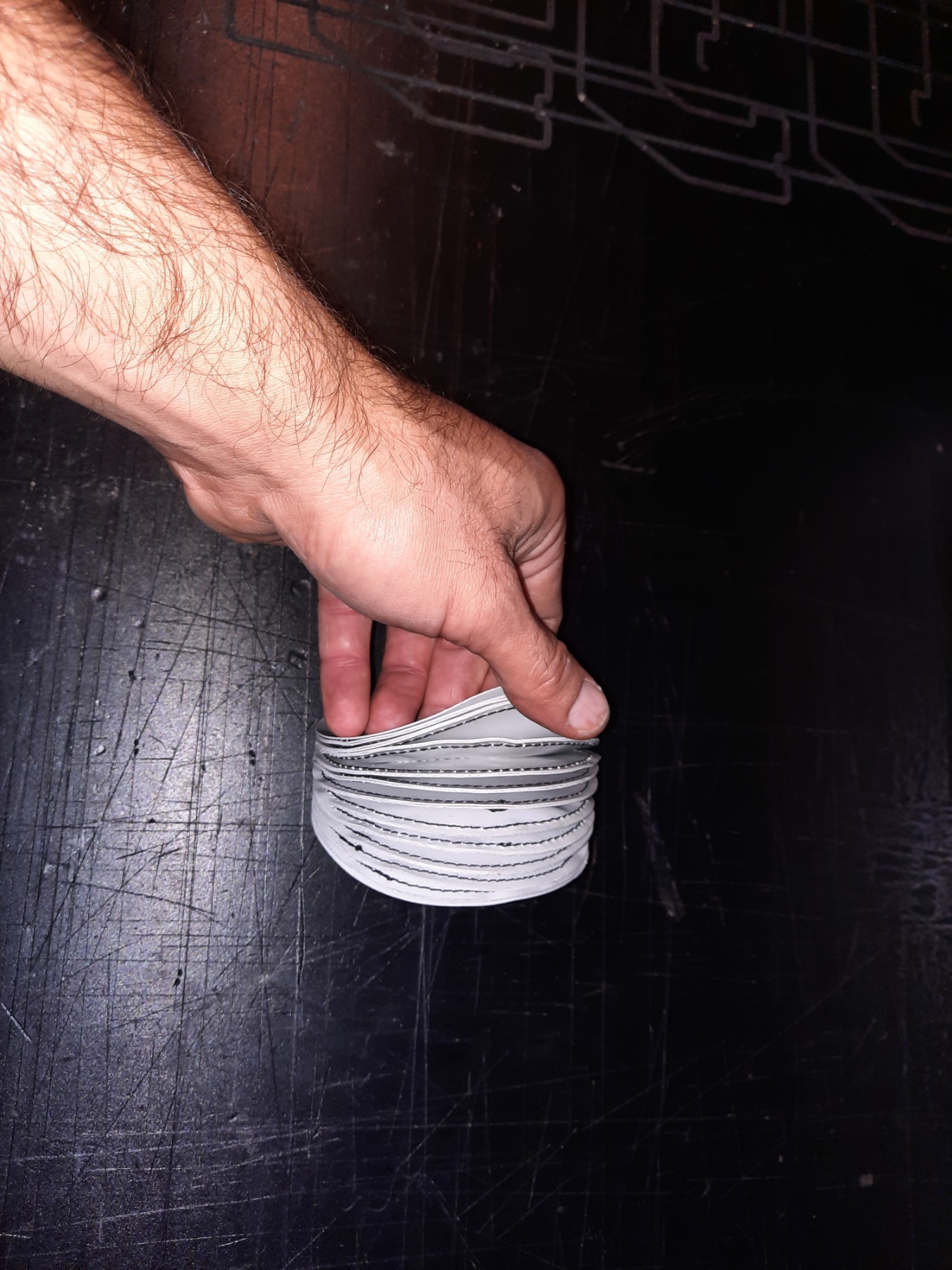

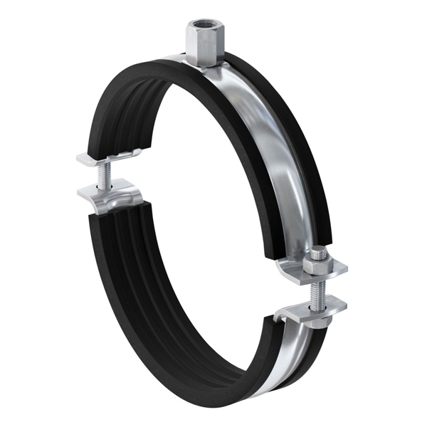

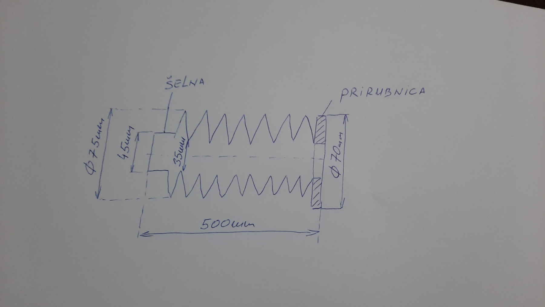

this guy works according to your sketch..dimensions, can be white or black, on the ends he can also put either a reducer made of the same material, or a flange made of flexible plastic with holes for mounting on the nut holder or on the ballscrew holder on the other side. it fit great on me and I fixed it with this hose clamp. I'm not sure about your customs, I can send it privately as a gift. I'll talk to you when I start the lathe, which I hope will be in a week or two-

Or maybe www.eiemaskin.se/produkter/maskinskydd/ who seem to have the Arnold catalogues on their web site.

I'm pretty sure EIE sells to companies only (probably a better chance of being able to buy directly from Arno Arnold!), but thanks for the tip! It's absolutely worth checking them out.
Replied by arvidb on topic epoxy granite cnc lathe
Nice! They have a pretty interesting catalogue , showing different end connections and guides.www.arno-arnold.de/de/
