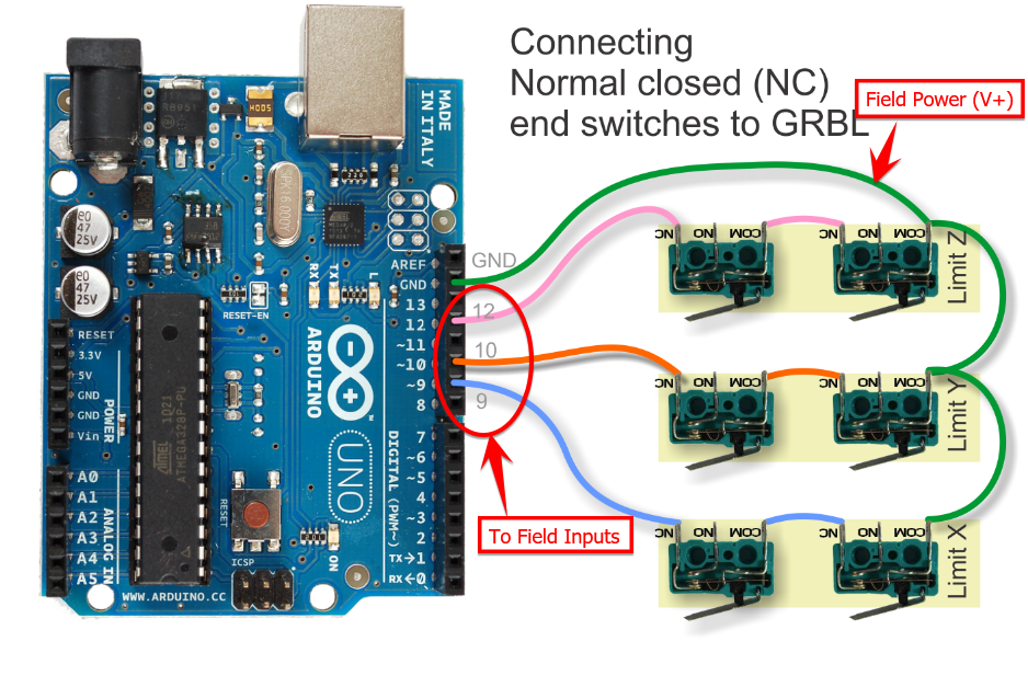

Hey real quick question. I just want to confirm that I am wiring the limit switches correctly. I got this diagram for a GRBL setup. I am thinking the switches can be wired the same (in series/per axis) but connected to the Mesa board differently. Do I just run the green wire to the Field Power (V+) and the others to the Digital Inputs? Please see attachment.

15 Feb 2023 06:06 #264549
by spumco
Replied by spumco on topic 1 or 2 dedicated 120VAC circuits for my CNC?
Yep. The pic had me confused for a minute, but if you wire it like your annotation you're GTG.
