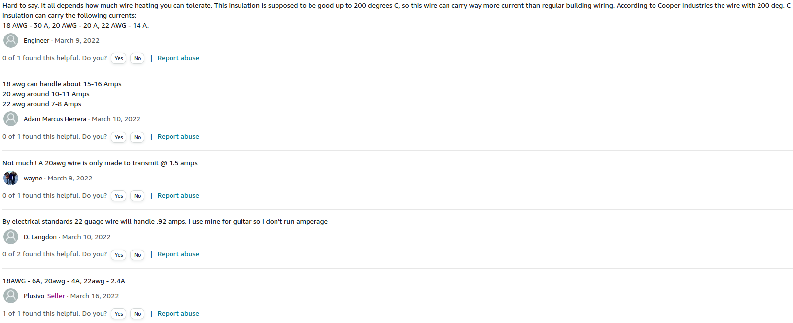

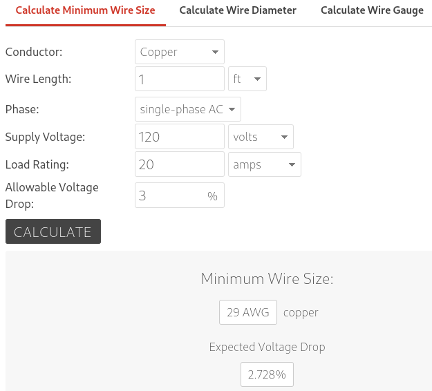

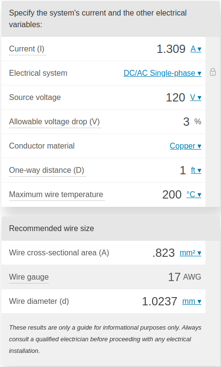

In researching some of the 18AWG wire I bought I came across these answers (by people) to the question about amp ratings for the 18-22AWG wire. It is crazy how drastically different they all are. They obviously all got the ratings from different charts/calculators.
I have also tried a bunch of calculators and they all seem different as well. Most of them spit out a super low amp rating. And then a few spit out super high ratings. Here are two different calculators. The first shows really low amp rating and the second shows really high rating. Note that they are not comparing similar size wire. But look at the gauge wire compared to the amp ratings.
It seems almost impossible to find accurate data.

Yep.
That's why I go by NEC and then treat everything smaller than 18awg as signal wires.
The responses below with crazy high amps are for 200c... and I don't want anything in my cabinet at that temp even if the wire can handle it.
And 1.5a for 20awg? Maybe for aluminum conductor insulated with dog turds.

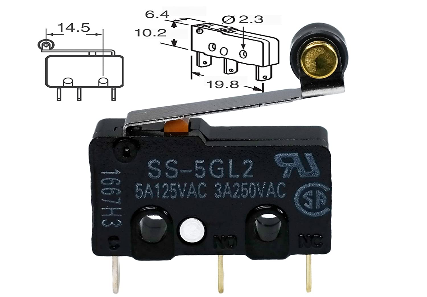

So I have the CNC completely wired except end stops. I forgot to order them. Will just any old limit switch work? Any recommendations?
- Posts: 21981
- Thank you received: 7481
09 Feb 2023 16:52 #264149
Replied by tommylight on topic 1 or 2 dedicated 120VAC circuits for my CNC?
Ones made by Balluff are good, but be seated before checking the price!
Mechanical fully enclosed ones should do for metal mills and plasma, inductive ones also good but might need a bit of protection from debris.
Anything from Omron should do, since you are aiming for good quality.

I'm partial to NC 3-wire inductive proximity switches. I believe the trick with these is to mount them in a way that the trigger/flag crosses the sensing volume rather than approaches. Put another way, if you think of the proxy like a flashlight, you want something (flag) to cut the beam from the side rather than moving the flashlight towards the device you're trying to sense.
I've read they're more repeatable this way. And you aren't going to smash the proxy if something goes wrong and tries to hit the hard stop. And the NC circuit means if a wire breaks or something, the controller will see it as triggering the limit (fail-safe).
On the other hand, I've also used $0.25 cheapo microswitches as limits on a couple of low-budget builds. They weren't repeatable to a 'thou, but that didn't matter much for a stepper plasma and I could run them at 24vdc for some noise immunity (at the cost of the contacts burning out sooner).
As with everything, it's a cost-performance decision. If you have a table-mounted ATC, tool length probe, or specific fixturing you may wish to have very repeatable limits. Otherwise, anything that gets you in the ballpark and doesn't fail frequently should be sufficient.
