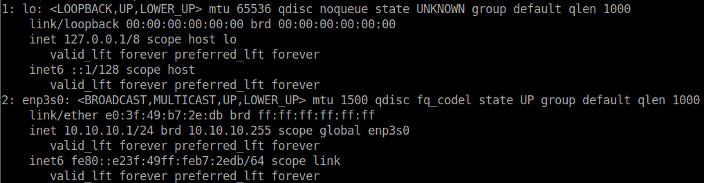

What does the command
ip a
report?
ip a
report?

OK that should allow access to the FPGA card at 10.10.10.10

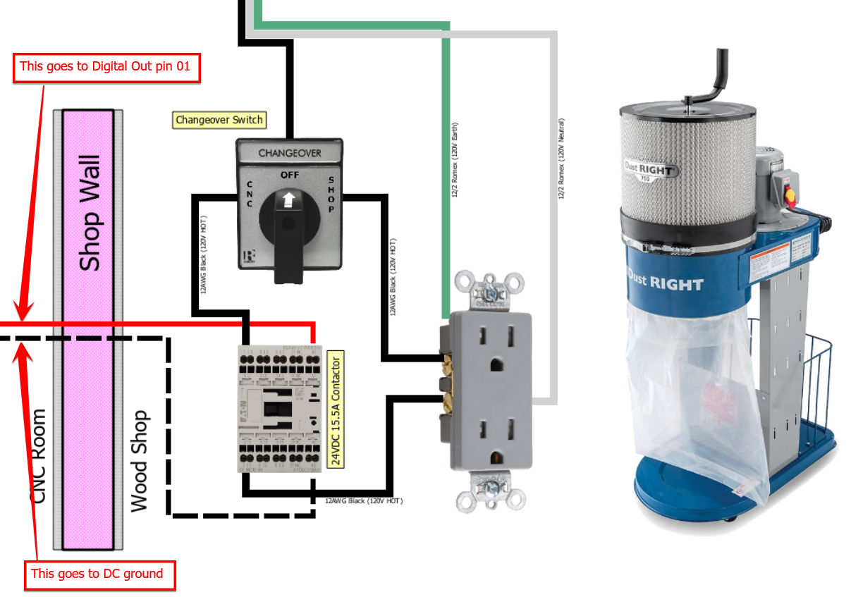

I have finally got the machine running. I have ran a few spoilboard surfacing jobs so far and it seems to run pretty good. I have a few tweaks here and there and some things I need to change but so far so good.
I now want to figure out how to enable the dust collector circuit that I setup. The discussion on how to wire this circuit started on page 5 of this thread. Here is a basic diagram of my setup.
As you can see I have the positive DC going to Digital Out pin 01 on the Mesa card and the negative going to DC ground. I have it setup use NO on the contactor. This way there is no power supplied until I want the collector to run. I want to have the collector come ON when the router circuit comes on and I want it to shut OFF during a fault, E-stop, end of job, etc. How should I set this up in LCNC?

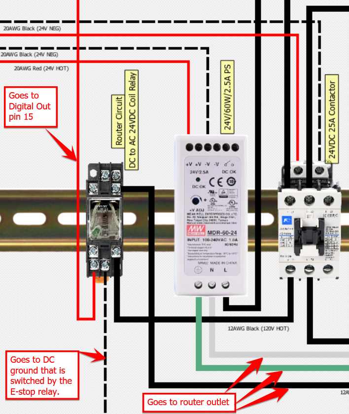

From what I could find, would I add the following to my HAL file?
# --- ROUTER-ON ---
net motion.spindle-on => hm2_7i76e.0.7i76.0.0.output-15
Not sure what else I would need to do. Like I said, I would like the router to come on when a job begins as well as a way to turn it on/off manually if needed.
Here is a diagram of how the router circuit is setup. See the notes in the diagram for wiring.
# --- ROUTER-ON ---
