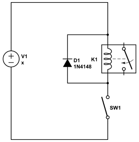

I am curious if maybe I have not setup my dust collector circuit correctly. I thought I was installing a relay for that circuit but it appears I did not do it that way. Instead I installed a ABB AE16-30-00 contactor. I assume I would still use a flyback diode?
If so, I could really use a little detail on how to install it. You mentioned
wired in parallel to relay winding, just mind the polarity in regard to Mesa output.
I would use another smaller relay in between, or a transistor.
Based on the diagrams I found of flyback diodes the they are soldered in between the positive/negative side of the relay winding like this image.
So I would install the diode between the DC pos/neg input on the contactor? Which side would the stripe face? I have read it both ways (toward the neg/toward the pos).
24 Mar 2023 19:24 #267412 by spumco
Stripe end of diode connected to DC+ side of contactor coil.

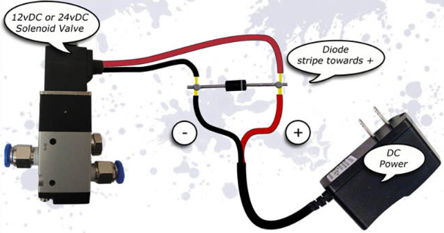

24 Mar 2023 19:39 #267416 by Sray69
So this is what I came up with.
The image is just an example. Instead of a solenoid valve I have a contactor. Am I correct in thinking that I can install my diode in the same orientation (stripe towards the + side)?
Here is a somewhat helpful explanation I found of what the stripe means and how to orient it. Provided this is correct information.
Think of the stripe as an arrow showing you which way current is allowed to flow through it, and imagine you just unplugged the power supply. Understanding that current will no longer go through the power supply, you should be able to see that it will now flow out of the coil and through the diode.If that diode were not installed, the coil can produce something called inductive kick, which can and will destroy the power supply by pushing voltage higher until it gets current flow - possibly through something that shouldn't be passing current.
Can someone let me know if my thinking is correct?

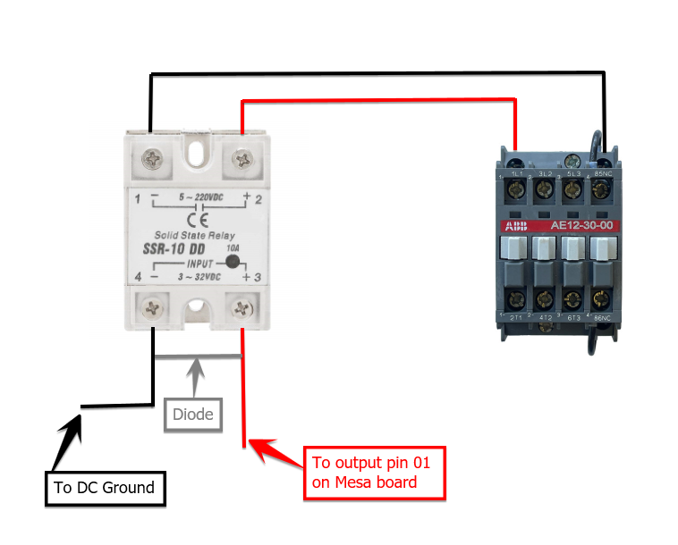

27 Mar 2023 20:17 - 27 Mar 2023 20:18 #267622 by Sray69
I didn't have the Omron relay but I did have a SSR (10A) that I ended up replacing with the Omron's. I figured I would test this and see if it would work.
Unfortunately I cannot get it to work. Maybe I am hooking it up incorrectly. I am not sure. The way I had the circuit setup originally was that I had the 24V signal coming from the output pin 01 (Mesa) to the A1 terminal and the A2 terminal (on the contactor) going to DC ground in the cabinet.
All I did was install the SSR inline with neg-neg and pos-pos with a diode on the input side (with stripe toward the positive side). See image.
Is this the correct way to connect it?
NOTE: I do not show the high voltage connections on the contactor.
When I enable the circuit I get a red light on the SSR. When I test the voltage I am getting 24V on the input side and zero volts on the output side.
Last edit: 27 Mar 2023 20:18 by Sray69.
27 Mar 2023 21:03 #267623 by spumco
1. Is your SSR rated for DC switching?  Most of the box/puck types I've seen are for AC only.  If your picture is of your actual SSR, you're fine.
2. What is powering the load side of the SSR?  remember - it's a switch.  It does't pass voltage through from the control side to the load side.
The load side (contactor side) needs a power supply.  Assuming your contactor coil is 24vdc, your circuit should be:
+24vdc -> SSR+(2)  (power supply V+ to SSR+)
SSR-(1) -> contactor A1 (SSR- to contactor coil V+)
contactor A2 -> 0VDC (contactor coil to power supply V-)
3. Assuming you're powering the contactor coil from the same PSU as that which is powering the Mesa... put the diode across the contactor coil and not the SSR.  The SSR turning off doesn't create a reverse voltage spike, but the contactor coil will - and that may work it's way back to the Mesa without a flyback diode.  Connect the diode acrosss contactor A1 & A2, with the stripe to the A1 side.
