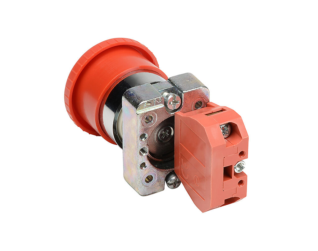

The estop switch should be one of the 'industrial' types where you can either stack separate contacts, or use two NC contact blocks for a single button.
Like this:

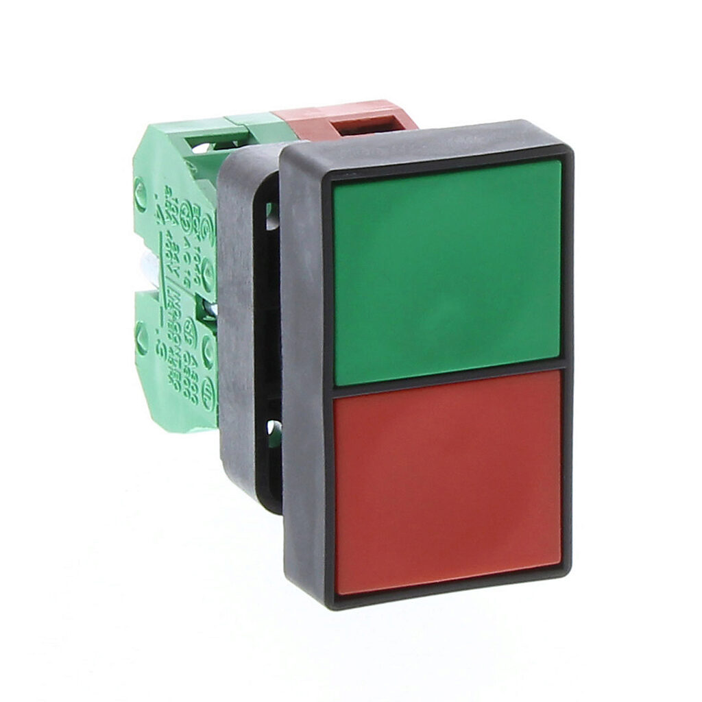

And the ON/OFF buttons can be a single switch as well. Here's an example:
Like this:

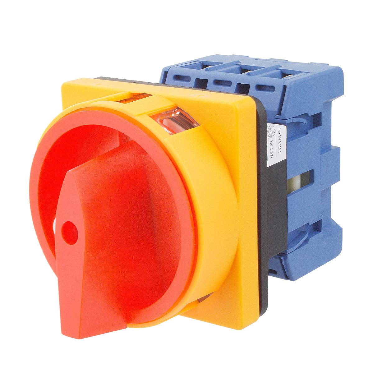

The main disconnect switch you have pictured is one of those cheapo computer C13 things with a built-in switch. I've gone through 2 or 3 of them - the switch dies. I suggest you get a real disconnect switch rated for your max current. Should look like this:
Tha't a 40A 3-pole disconnect for $18.

Here are all the Alpinetech stops/switches/buttons on Amazon
smile.amazon.com/s?k=Alpinetech&qid=1668919326&ref=sr_pg_1
Would these be worth purchasing?
Also if I go with a 30A breaker would this disconnect (32A version) suffice?
smile.amazon.com/Rotary-Changeover-2-Pos...8917297&sr=8-39&th=1

Disconnect switch - yes, that'd be far superior to the little rocker switch you originally had.
Alpintech switches are OK, but they're pricey on Amazon and they use contacts & operators (the actual button part of the assembly) that don't interchange with other brands. For the same or lower cost I'd recommend Automation Direct - and you can usually find AD switches and contacts on ebay for less than retail.
