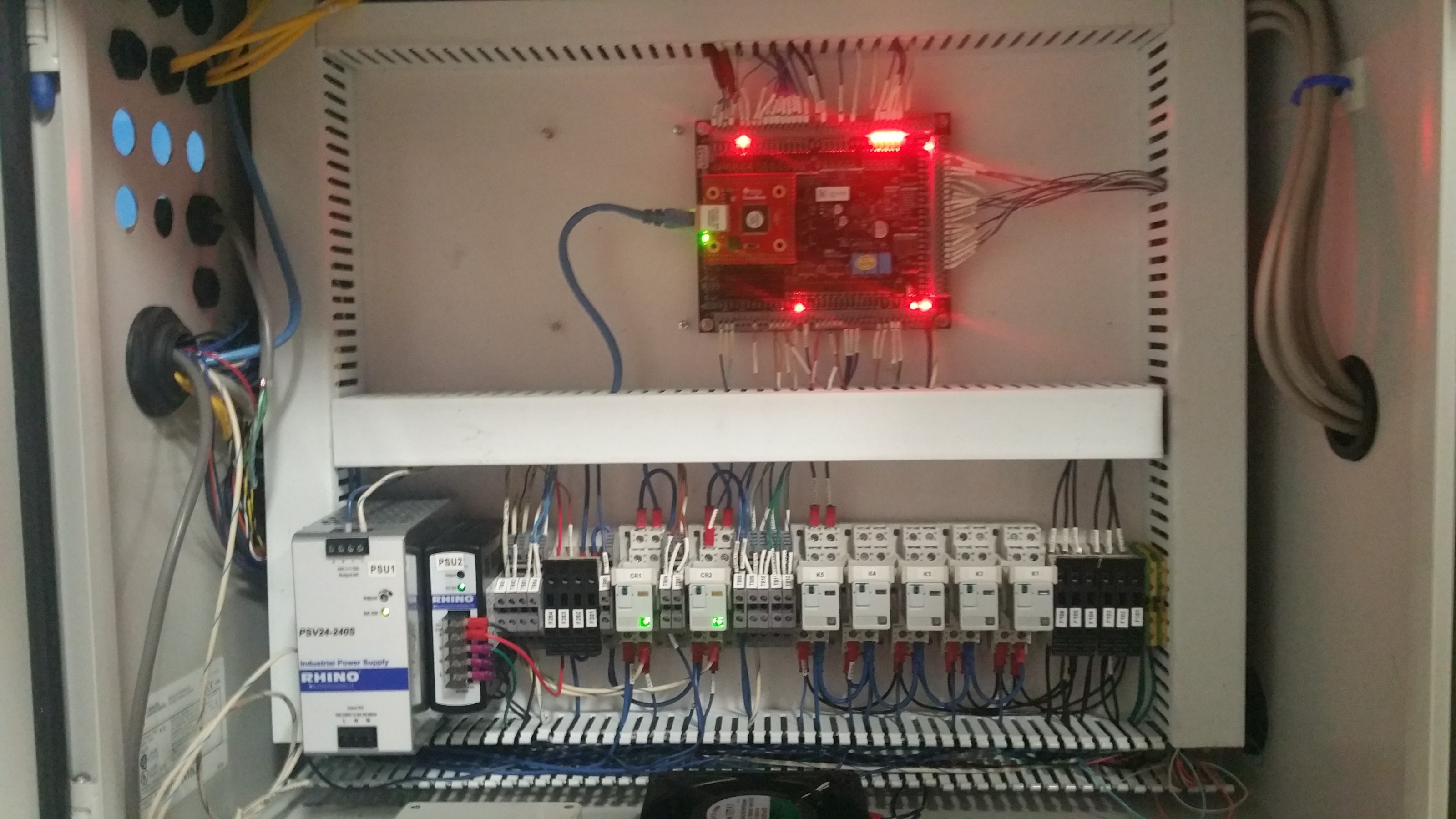

Replied by spumco on topic 1 or 2 dedicated 120VAC circuits for my CNC?
- ESTOP & switch
- the estop circuit does not control the 24vdc PSU. Once the main disconnect is closed (ON), the 24vdc PSU is energized and thus the 24vdc terminal blocks. The Mesa power and field power are immediately energized; there's nothing between the PSU and the Mesa V+ terminals other than an (optional) fuse.
- Yes, the estop button contacts are mechanical contacts
- The only current going through the estop contacts are:
- Contact set 1 - contactor and relay coil grounds (a few mA)
- Contact set 2 - Mesa VFIELD to Mesa input pin (a few mA)
- Fuse rule of thumb
- Fast blow for protecting electronics and sensitive stuff
- Slow blow for protecting things with large inrush currents (drive main input bus, VFD's, power supplies, etc.)
- A 3A fast-blow fuse would be fine for the 24vdc circuits
- 24vdc DPDT relay
- I'm a fan of these. Get a few - they come in handy.
- www.automationdirect.com/adc/shopping/ca...4_series)/782-2c-24d
- Also need a relay socket (DIN rail compatible):
- www.automationdirect.com/adc/shopping/ca...r_sockets/782-2c-skt
- Contactor
- There is no harm in going with higher-capacity contactors, except:
- More money
- Physically bigger
- Coil usually draws more current (but still not much)
- Definite-purpose contactors work, but they're 'cheaper' than the IEC versions.
- I honestly don't know why definite-purpose contactors exist, but I think they're less expensive because the housing and contacts are simpler. I believe they're intended for use in assemblies which are never opened - note that the terminals aren't 'finger-safe'.
- Decide now what the contactor is going to control:
- Just the 60vdc PSU, or the router motor as well?
- If just the PSU, then the one you linked is suitable
- If the router motor as well, then the 25A version of the same contactor would be suitable.
- No need for aux contacts
- both the Fuji and Weg IEC mini contactors are DIN-rail mountable.
- SSR
- Might as well just use another mechanical relay - i.e. same as above. They're rated for 15A @120vac, and you aren't turning the spindle on/off frequently.
- In fact... if it were me doing this I'd use 3 of the exact same relay & socket combos so I could have common spares:
- #1 - 'estop' relay
- #2 - spindle on/off relay
- #3 - 5v signal to drive enable relay
- Yes, you don't need DPDT relays for #2 & #3, but having a common component for all three items is quite handy. And it makes your control box visually satisfying.
- Bonus - terminal blocks
- Ebay has great deals on DIN-rail terminal blocks, but suggest you search for a single brand and stick with it. The accessories are never compatible across brands (jumpers, end covers, etc.).
- DIN-rail terminal block fuse holders are great - small, neat, hold 5x20 (or 6mm) fuses. Jumpering a row of them makes wiring really tidy. Just read the fine print to see what the max current is for that series. Example:
- Automation Direct Konnect-It fuse holder - rated for 6.3A
- Automation Direct Dinnector fuse holder - rated for 30A (!)

WOW! I need to go through this slowly so I can digest it, but it looks like you were very thorough and detailed in your answers. Exactly what I needed.
Thanks so much!
BTW, the cabinet looks very clean! I hope I can do the same.
Thanks so much!

Next step is playing tetris with all the components in the enclosure. Leave yourself plenty of room if you can, otherwise you'll be using foreceps to get the wires in the component terminals.
