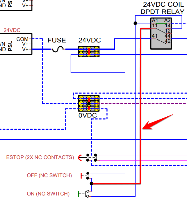

29 Nov 2022 18:12 #258005 by Sray69
@spumco-
I am trying to understand how the ON/OFF switch circuit works in your diagram.
So when the cabinet is powered on, power is allowed through the OFF button circuit ,because it is in a CLOSED (NC) state. The power then hits the ON button circuit but is stopped because the circuit is in an OPEN (NO) state. This means that the relay coil is not energized so the poles are open, not allowing power to flow through. Once the ON button is pressed the circuit closes, in turn powering the relay coil, closing the poles allowing power through. Is this correct so far?
If so, I have been struggling to understand how the rest of the circuit works. The wire that comes off the connection between the ON and OFF buttons that goes to terminal 11 on the relay. I think I may have finally figured it out but wanted to confirm.
Before the ON button is pressed there is power that goes to terminal 11 but stops because the relay coil is not energized yet. Once the ON button is pressed, the relay coil is energized, closing the poles, connecting the circuits. If I am understanding it correctly, once the ON button is pressed and the poles are closed, the power from terminal 11 flows through to terminal 14 which then powers the wire to the coil, allowing the relay coil to stay energized once the ON button is released. Is this correct?
Sorry if this is confusing or if I am not using the right terminology.

29 Nov 2022 18:52 #258012 by spumco
@spumco-
Well done!
This relay circuit is called a 'holding' circuit.  It's used extensively in machinery and the fundamental purpose is to ensure that the machine does not re-start automatically after a power outage.  It's simple & robust.
As you've worked out, the secret is using a DPDT relay where one of the contact pairs is used to 'back-feed' the coil to keep it energized.
An identical arrangement can also used on estop circuits.  Some of the machine/safety codes require a second action on the part of the operator to de-assert an estop condition.  Installing another holding relay with a separate momentary RESET button will accomplish the goal.  The operator has to unlatch the NC estop switch AND press an NO reset button to full de-assert the estop condition.
The following user(s) said Thank You: tommylight, Sray69

29 Nov 2022 19:50 #258016 by spumco
I forgot to mention that the diagram I cooked up doesn't need the separate RESET button.  If you push the estop button the holding relay de-energizes and your ON button serves the same purpose as a RESET when you want to de-assert.
Separate reset buttons are used when the estop circuit is more complicated or you want to keep some components energized (sensors, encoders) during an estop while still de-energizing drive/spindle bus power and pneumatic components.
If you want to be super-OCD you could label the ON button as ON/RESET and feel smug.
The following user(s) said Thank You: Sray69

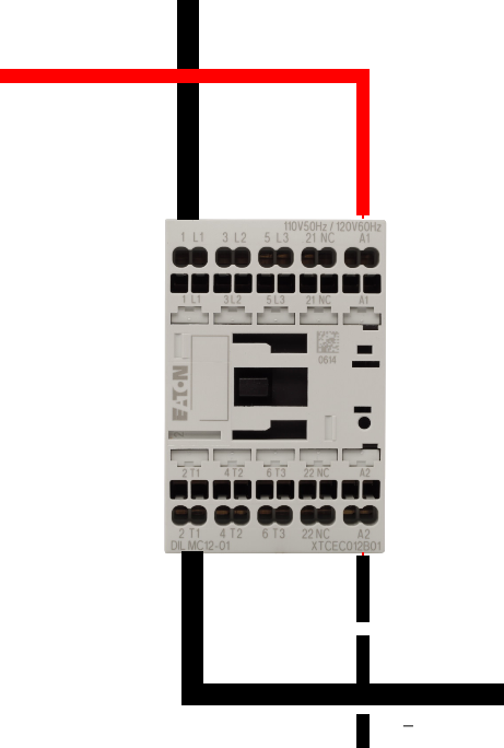

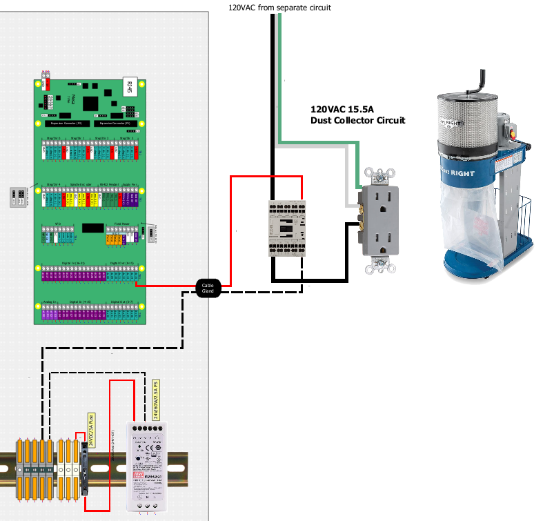

29 Nov 2022 19:53 #258017 by Sray69
spumco wrote:
Easy option - mount a small enclosure on the wall where the dust collector mounts and install a contactor in it.  Feed it with 120vac.  Run a 24vdc signal from Mesa to it - can be a small 18awg cord.
Is this correct?
29 Nov 2022 19:58 #258018 by Sray69
Close-up of Eaton contactor
