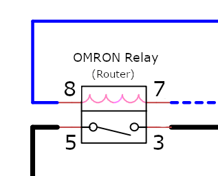

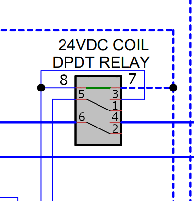

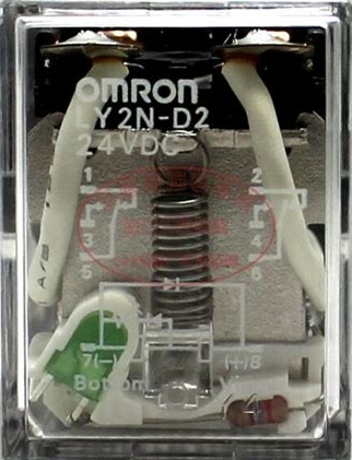

While drawing up my diagram I realized that the Omron relay and socket terminal numbers differ from the SSR & DPDT relay in the diagram you posted. The terminal numbers on the Omron relay/socket are labeled 1-8. The terminals on your diagram are labeled (11, 12, 14, 41, 42, 44). I want to be sure I connect to the correct terminals.
You can see the connection diagram on the top of the relay.
Is this how I would connect these?

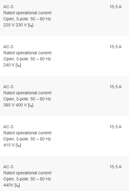

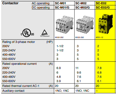

I was researching the Fuji contactor (SC-E02/G) that you linked to. I am curious if it can handle the amps (15A) the dust collector is rated for? By looking at the datasheet I am not sure it has a high enough rating. For AC-3 applications it only shows specs down to 200V (7.8A) so I am not sure what the amps would be for 120V.
It looks like the Eaton is rated (AC-3) at 15.5A (220V-440V). It does not show a 120V rating either but it is double the Fuji at the same voltages.
Am I looking at the correct specs? There are so many electrical specs on these components, I have a hard time knowing exactly what I am looking for.
