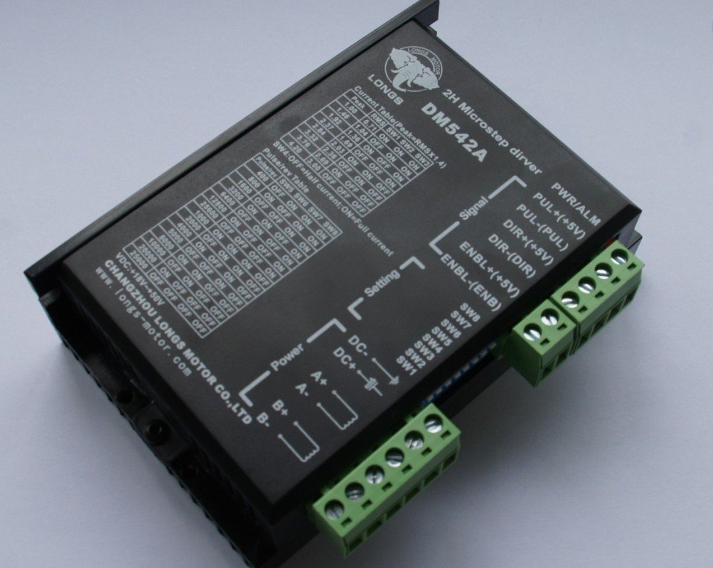

17 Nov 2013 01:58 #40874 by fannlow
Replied by fannlow on topic NEMA 23, weird velocity results.. need help
PCW:
I didn't quite get what you mean though?
while I'm reading up GECKO drives about stepper torque chart, am pondering about uStep ratio that you mentioned..
attached is the wiring diagram that I am using from the vendor.
yes, i use a parallel port to the controller board.
by uStep, I assume you meant microsteps?
I am using 4 microsteps with 200 pulse/rev.
what you are suggesting is pushing it up to say:
8 or 16 microsteps with 800 pulse/rev?
thanks

17 Nov 2013 02:07 #40876 by fannlow
this is what I am currently using:
Nema 23 stepper motor with 425 oz.in,3A
Stepper motor driver DM542A, 24-50VDC, 128 MICSTEPS
350W-36V power supply
breakout board & 1 pc parallal cable ( the maximum axis is 6 axis)
on the motor driver DM542A, there are 8 DIP switches...
1~3 control the RMS (output amps, max. 3.0A)
4~8 control the pulse/rev (max. 25,000)
I might have made a mistake inserting the pulse/rev at 200 in the linuxCnC?
the min. pulse/rev here is 400...>.<"
omg... I'll have to check again in the morning to double confirm this...
i didn't get what you meant by hardware step generation?
which part on the DM542A board does this refers to?
maybe I can try to play with it get better results?
what are you guys using to push it faster?
I saw on cncrouterparts.com that the NEMA23 they are using can push out 600IPM ~ 800IPM
and NEMA34 can hit 1000IPM, with a 29deg, 5-start screw..
so I'm still pondering, if I can get anywhere close to theirs with the same 5-start leadscrew?
or how should I be fairing with a normal leadscrew?
keep throwing something at me, I might just hit a jackpot! :)
thanks
17 Nov 2013 02:14 #40877 by fannlow
I kept thinking I was using 1/2 step though...
where on the LinuxCnC or the DM542A should I go to change this to 1/2 step?
I will change the pulse/rev to something like 800 in the morning (both the DM542A & LinuxCnC)
microsteps will change to 128 instead, and try to see if I get any good news?
I will try to post the HAL here for references.
thanks
17 Nov 2013 04:28 - 17 Nov 2013 04:29 #40881 by PCW
StepConfs "Motor steps per revolution" _Must_ be 200 (this is determined by your motor)
"Driver Microstepping" must be set to match the dipswitch settings on your step drives
4,8 and maybe 16 make sense for microstep values when the step drive is run from a parallel port
www.linuxcnc.org/docs/html/config/stepconf.html
Has more details on what each field in stepconf means.
Last edit: 17 Nov 2013 04:29 by PCW.
17 Nov 2013 05:16 #40882 by fannlow
yup, read it jz now...
its the motor step deg / 360 = 200 full steps per rev.
thanks!
regarding microstepping:
4 uStep = DIP setting to 800? (ON, OFF, ON, ON)
8 uStep = DIP setting to 1600? (OFF, OFF, ON, ON)
16 uStep = DIP setting to 3200? (ON, ON, OFF, ON)
hope I understand this correctly?
that is the DIP switch # 4~8 (pulse/rev)
17 Nov 2013 14:50 #40887 by Rick G
Replied by Rick G on topic NEMA 23, weird velocity results.. need help
Yup.
