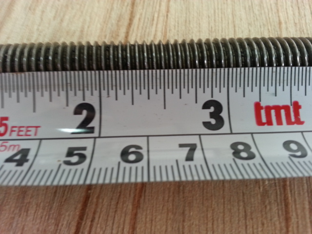

Tried at diffrrent velocity and uStep.
I get same speed for some reason around 6000hz.
Any higher it stalls.
Measuring the voltage while running come up somewhere around
10~14v
Attching a 15 thread per inch leadscrew for references.
Not sure if I should get a lesser tpi for use?
But still the motor stalls if I have velocity over 15mm/s or 6000hz now.
Will attach my hal and ini file in abit.
10~14v

Have you tried reducing your acceleration to say 300 or less ?
Have you checked your SCALE?

MAX_VELOCITY = 15.0
MAX_ACCELERATION = 750.0
STEPGEN_MAXACCEL = 937.5
SCALE = 157.480314961
these are way too high change your max acceleration to lets say 20
why are you trying to run at absolute max ?
how did you arrive at the scale value ?
also what power supply voltage and current are you using for your stepper drives ? idealy you need around 48v @10amp
if the motors are stalling whilst in your hand only then it is just a matter of reducing the accelleration and velocity settings
you are essencially trying to send pulses faster than the motor can handle
in your hal file change
stepspace to 0
dirhold 35000
dirsetup 35000
stepspace to 0
dirhold 35000
dirsetup 35000

36v & 10a for power supply.
Absolute max because I cut polyfoam and for my production needs.
So gaining any speed is good progress to me
No idea regarding scale. Or how it got that number?
Will need your help here.
The motor stalls after I tightened the screw on the motor mounting plate to the machine frame.
It works and can run to 340mm/s on my hand.
Hope this helps.

ok lets go back to the beginning ,
what are you cutting out of polyfoam ? , what type of cutter etc milling cutter or hotwire ?
increasing the voltage will give you more speed , up to the max input voltage of the Stepper drives ,
i think you said your using 542's which can go to 50v , i use mine at 48v and the larger drivers at 68v
i presume your using trapizodial threaded rod and delrin nuts
using steppers and a parrell port can be slow , you would be better with a mesa 5i25 which removes the parrell port speed limitations
lesser tpi will give you faster speed , or even look at gearing is another option , it all depends on the weight of your moving axis and torque requirements
if the machine is heavy ..
make the changes iv'e pointed out and attach your current files and i'll take a look further.
information on your machine or a few pictures helps too ,

A stepper motor on full step will turn 1 revolution with 200 steps. If directly connected to a 5 tpi threaded rod at full step it would take 1000 steps ( 5X200) to move one inch.
If your SCALE is wrong the velocity you think your machine is moving at is also wrong.
Set your velocity and acceleration extremely slow and measure how far your machine actually moves when commanded.
Stepper motors have a limited usable rpm range. I think you said you were using a 15tpi threaded rod, as Dave said if your motors have enough torque less tpi would result in faster movement.
Rick G
Replied by Rick G on topic NEMA 23, weird velocity results.. need help
SCALE is the number of steps for the machine to move 1 unit of measurement.No idea regarding scale. Or how it got that number?
