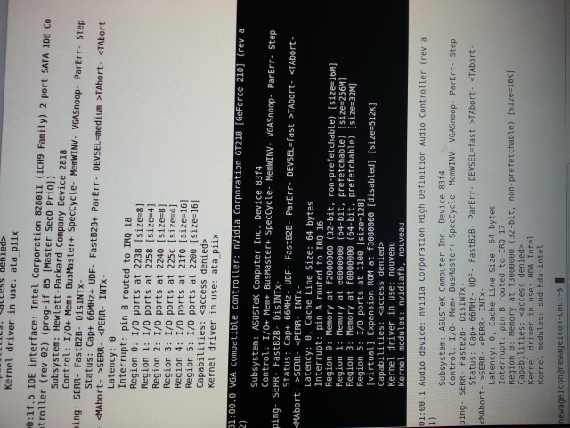

Attached is the driver in terminal, seems to run nvidia gt218. How do I change this?
Not sure where you got that number from, it clearly says
Kernel driver in use: nouveau
Kernel modules: nvidiafb, nouveau
Those are open source drivers, nouveau is right one for nvidia
It might work better with the 3D driver, this covers how
help.ubuntu.com/community/BinaryDriverHowto/Nvidia
but don't do anything until you know video is the problem.
You need to do the terminal latency test and see where the high figures are coming from.
It appears that you have the Intel 82801I ICH9 chipset.
There are no listings for this chipset having the SMI problem, if it is regularly spiking with no activity, the problem is likely to be something in BIOS, like fan control.
See this addition to the FAQ with a similar one I had
www.linuxcnc.org/index.php/english/forum...ency-solutions#36807
regards
Last edit: 20 Nov 2013 20:05 by ArcEye.
