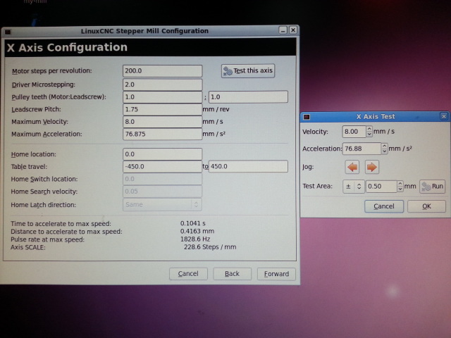

When inputting in stepconf, we insert the number in servo thread or base thread?.
Base thread.

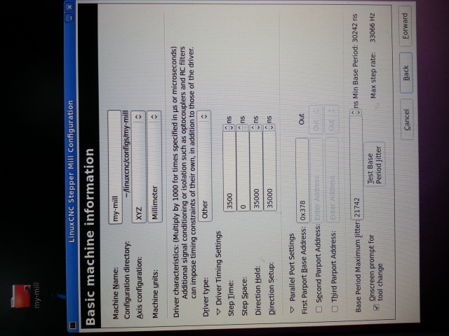

21 Nov 2013 03:21 #41035 by fannlow
Replied by fannlow on topic NEMA 23, weird velocity results.. need help
No wonder I am so thrown off :angry:
I have been using servo thread...
In that case I assume servo thread is for servo motors and base thread is for steppers?
In my case the base thread is much better now.
Only around 21000ish, compared to previously 33585..
Many thanks
Let me tests and see how it runs

21 Nov 2013 03:29 #41036 by andypugh
Replied by andypugh on topic NEMA 23, weird velocity results.. need help
NIn that case I assume servo thread is for servo motors and base thread is for steppers?
It's not quite that simple.
The "servo thread" is where all the complex calculations are done, and that runs at about 1kHz.
The "base thread" is where all the simple but fast stuff is done, and that runs at 10kHz to 50kHz.
Systems that use hardware step generators (such as FPGA cards) generally don't even have a "base thread"
Stepconf might still decide on a 100uS base thread, even if you tell it the latency is lower. I don't know what logic it uses.
21 Nov 2013 03:39 #41038 by fannlow
The results came in..
New base 21742,
Managed to get only 8mm/s :(
Any ideas?
What else I can try?

21 Nov 2013 03:44 #41039 by andypugh
What base period is stepconf giving you?

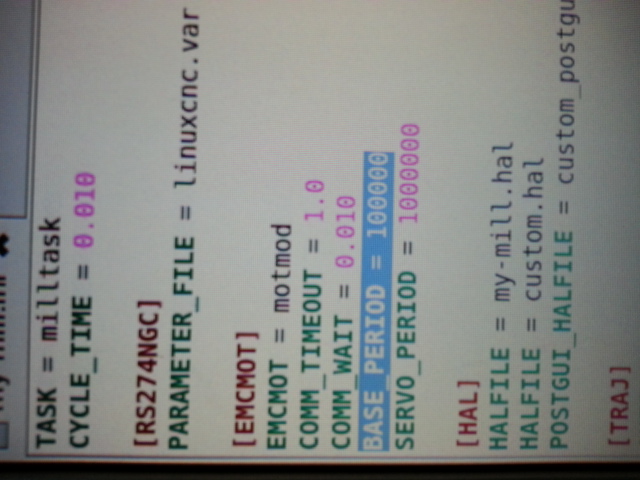

21 Nov 2013 03:52 #41042 by fannlow
Base period is 100, 000.

21 Nov 2013 03:58 #41043 by andypugh
So change it!
Let stepconf finish the configuration, with quite a high max velocity.
Then edit the config files to change the base period (the reason it is choosing 100,000 is probably because you are only asking for 8mm/sec so it doesn't think it needs to be any lower. A bit of a chicken-and-egg situation).
Then start LinuxCNC with your new config and see how fast you can jog axes (adjusting the speed sliders).
I don't think that "test axis" is the best place to optimise the axis speed with your particular (fine leadscrew) setup.

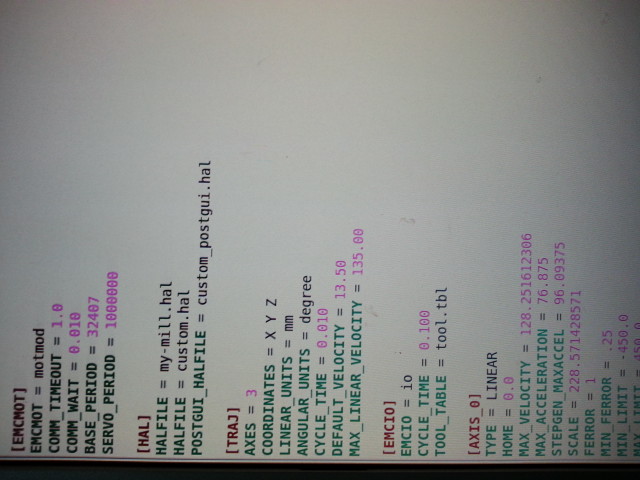

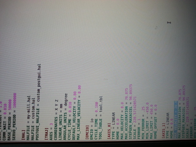

21 Nov 2013 04:01 #41044 by fannlow

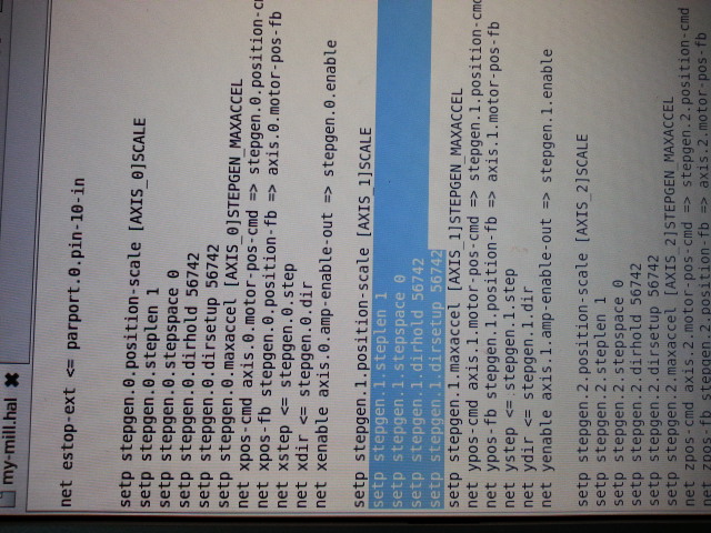

Any idea where did .hal get the
Steplen 1
Stepspace 0
Dirhold 56742
Dirsetup 56742
Also changing and saving .ini doesnt reflect out when I run the machine?
I have changed the base period to 50000
And up the velocity from 8 to 20 now and still same though..?
Something I did wrong?
21 Nov 2013 04:06 #41047 by fannlow
Using stepconf to up the velocity as you suggested and here is the new .ini file.
Though in stepconf I set max velocity to 135mm/s, in .ini, I see that max accel is cap at 128.251613306mm/s
Now testing slow jog

21 Nov 2013 04:07 #41048 by andypugh
Steplen 1
Stepspace 0
Dirhold 56742
Dirsetup 56742
1, 0 is normal for a config that uses "reset" as a way to get a step pulse every cycle, rather than ever second cycle. That part is right.
The dir hold and dir setup seem strangely long, but they are in the region of one servo-period, so that's fine.
In the screenshot the speed limit is still 8 for [AXIS_0]. Which one are you jogging?
