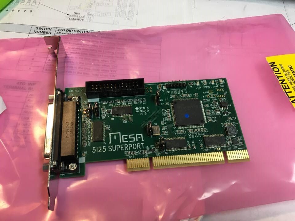

I always thought it was just one set of field power.
Look what I got for Christmas today....... lol, thanks John.....
Replied by bevins on topic Biesse Rover 346 Retrofit
Yes there is. There are two power lines on the field power connector, there is a Vin on pin 5 and Vfield on pins 1 2 3 4. The 5V is logic power so I always use separate power for it.
PCW is welcomed to chime in about this as I got the Mesa cards 2 days ago and so far I only tested the 7i76 on the bench ( well living room table ), but from experience it should be like that.
There is the W1 jumper that has to be set to the right for use with separate power supplies on the Field power connector.

Linuxcnc is up and running with the 5i25 in it and communicating with the 7i77 and I added an input and output from the machine and all is working. Well on the way......
Now I just need to find the time to sleep.....
