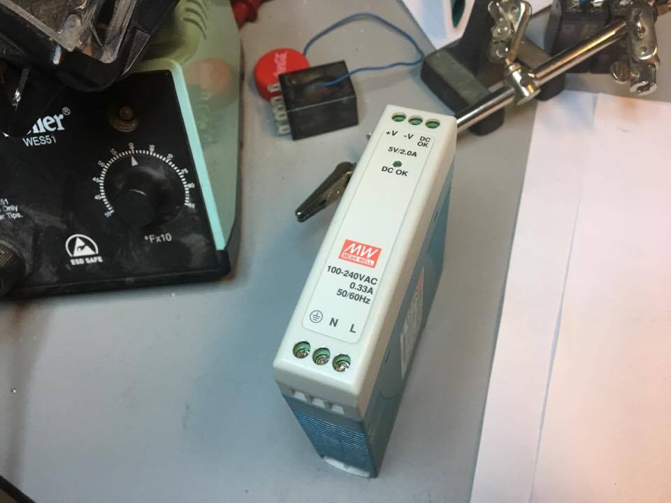

Replied by andypugh on topic Biesse Rover 346 Retrofit
Err, I just had a more careful look, and hope that you didn't buy that _exact_ part, as it is 24V to 24V...
www.ebay.co.uk/itm/Din-Rail-power-supply...d:g:PwcAAOSwSzdXCUKh
Is more like what you probably want.

15 Jan 2017 16:17 #85822
by bevins
Replied by bevins on topic Biesse Rover 346 Retrofit
I got the 120vac one.Err, I just had a more careful look, and hope that you didn't buy that _exact_ part, as it is 24V to 24V...

17 Jan 2017 21:51 - 17 Jan 2017 21:53 #86010
by bevins
Getting everything ready to cut the cord......
I/O is straightened out, had to obtain and fabricate solder etc about 115 wires onto connectors that will mate with cables coming from existing relay boards.
Testing firing a bunch of relays for devices re: solenoids, air valves for checking, spot check. Still have to test every output to see if existing wiring numbers are ok.
One of the first things i have to check is a difference in potential between the two com....if that is ok, then i am set.
Going good, now i am at the airport on a 2. Day buisness trip. Argkkk!!
Return on thursday.
How's the retro going?
Regards,
Tom
Return on thursday.
