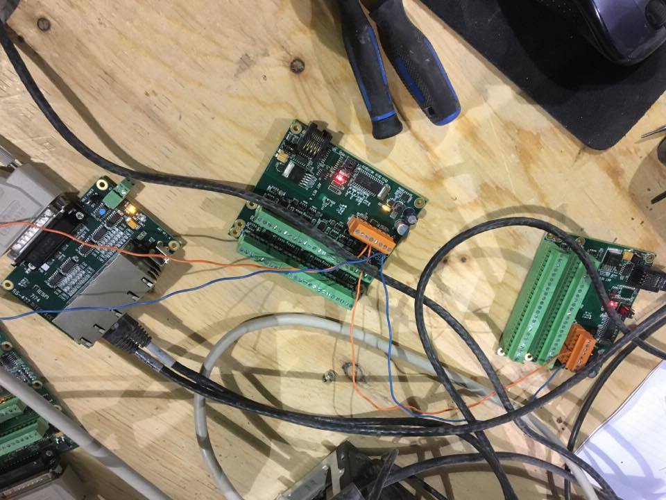

ok so I got the 7i74 and 7i70,7i71 cards.
Plugged them in connected to 5i25 on the second port with the ribbon cable,
powering on 5v cable like the 7i77 just for now to test and the 7i77 comes up ok but not the 7i74 and I cannot see
the 7i70, 7i71 stuff in halshow. thats probably cause 7i74 is not coming up as shown by the yellow LED on it, which I assume should flash green like 7i77 if all is ok.
so, the 5i25 says 7i77 7i74 on the sticker, so i assume the firmware is ok on the 5i25. Is there a way to check what firmware is on it?
Also the ethernet cable I am using to connect the 7i70 to the 7i74 port is suppose to be straight not cross correct?
The jumper on the 7i74 is set for power from cable.
thanks,
Bob
thanks,
Bob

11 Jan 2017 05:12 #85602
by bevins
Replied by bevins on topic Biesse Rover 346 Retrofit
- bevins
- Posts: 1947
- Thank you received: 338
11 Jan 2017 05:35 - 11 Jan 2017 05:36 #85603
by bevins
ok,
Board configuration verified successfully.
So it has the right boards.... So I am down to 5v power not sufficient or wrong ethernet cables.
The 7i77 board works fine, in/outs etc...
The lights on the ports that the 7i70 and 7i71 boards are connected to are off.
