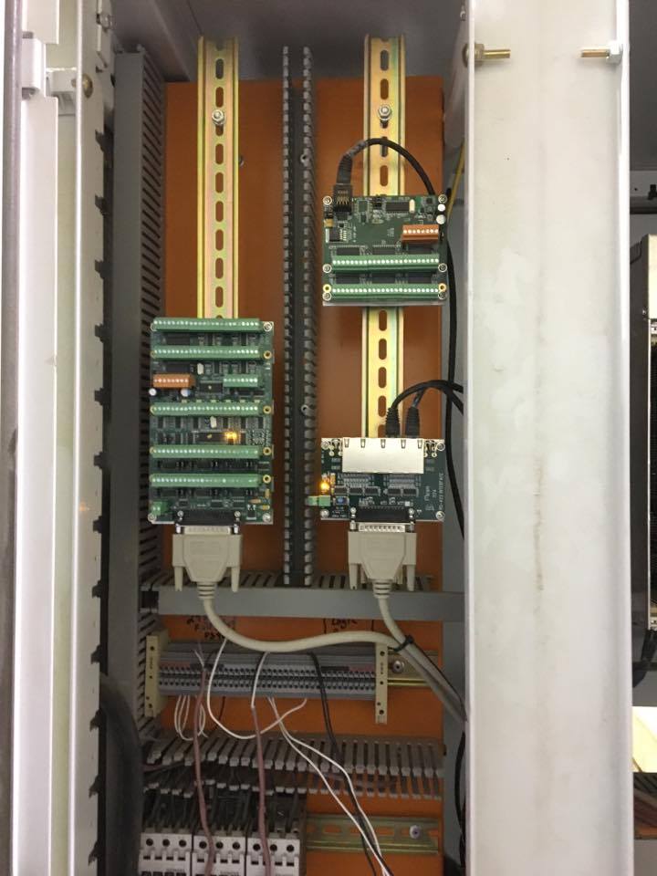

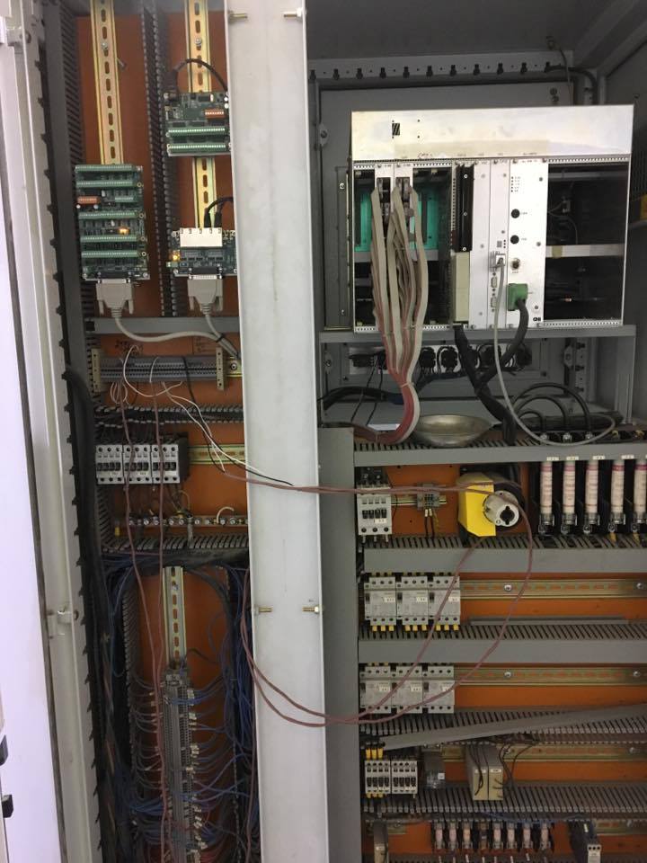

looks like fun. Are you reusing all the relay and digital input boards? Were they just TTL digital io to the old Num control? I think that is how our old Num 1040 works. The fiber optic remote io pannels our machine also has are a little more intimidating to try to think about integrating.
- bevins
- Posts: 1947
- Thank you received: 338
13 Jan 2017 05:32 - 13 Jan 2017 05:50 #85681
by bevins
I am removing those input boards but reusing all the relay boards. Saves alot of work and money and they have built in snubbers already on the boards. I dont know what those input boards put out back to the control but you see I installed a 7i70 there so they will just plug into the 7i70 and I have to find the other sides which is common Positive they are using so should be easy.
I found connectors for the relay ribbon cables that output wires so they will plug right into the 7i77, and they are positive trigger with common ground, so it is going to be so easy.
Replied by bevins on topic Biesse Rover 346 Retrofit

I have to research a DIN rail 5v power supply. Anyone have good luck with a nice one not too expensive?

To be honest for 5v supplies I usually just mount an outlet and plug in a cheap wall wart. But a quick google brings up this.

I'll order three. I have a bridgeport I have to do, so I will have a spare.... $11.50 lol
/EDIT Orderd 5........ Check!

I ripped out a power supply from a computer and was going to use that, but these are so small and fit right on a din rail. So I bought three of them......lol Cant never have enough 5v power supplies....lol
