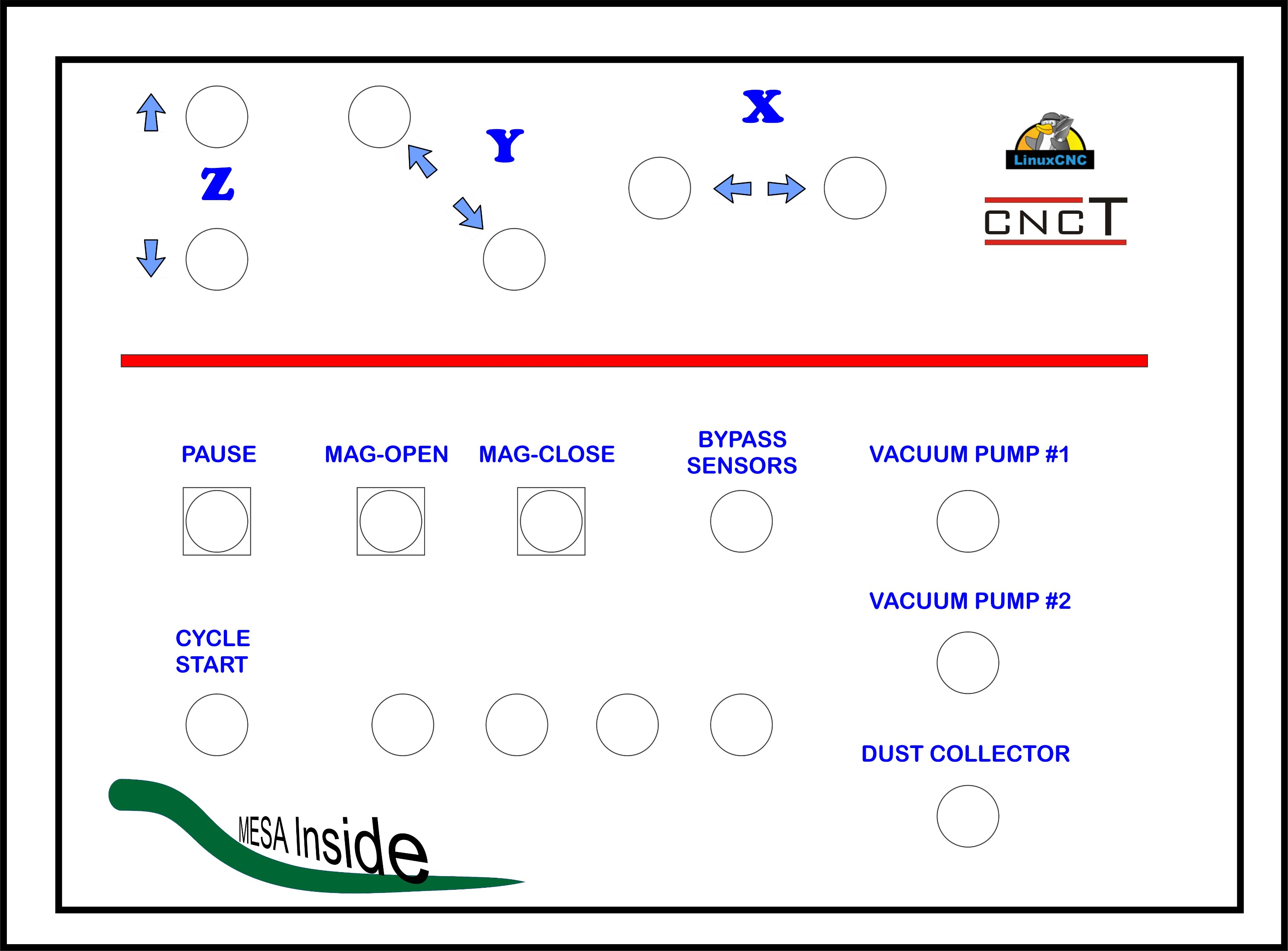

Love the bottom left. I think PCW should come up with an official MESA inside logo
Oh and the logo in the top right is cool too

Thanks,
I need a higher res LinuxCNC logo, dont know if this will come out good. Maybe I will try and vectorize it and scale it up.

Hmm, I'll put my old printers hat back on. A Vector would be best by far.
If you use a bitmap, 300dpi is preferred but on a digital colour output device, you can get away with 200 dpi and maybe even as low as 150dpi. Resize the image (without rescaling or rendering) to the required dpi and you will know the maximum safe size.
Also there is an image in the source code for LinuxCnc that is used on the opening splash screen, is that any better resolution?
And this one found by googling "Linuxcnc"logo" is big enough to print perfectly (3008 pixels wide so will print 10"wide) even if its not the official one....
diy.vegashelicam.us/wp-content/uploads/2014/02/LinuxCNC-A.jpg

Oh, I like that one
