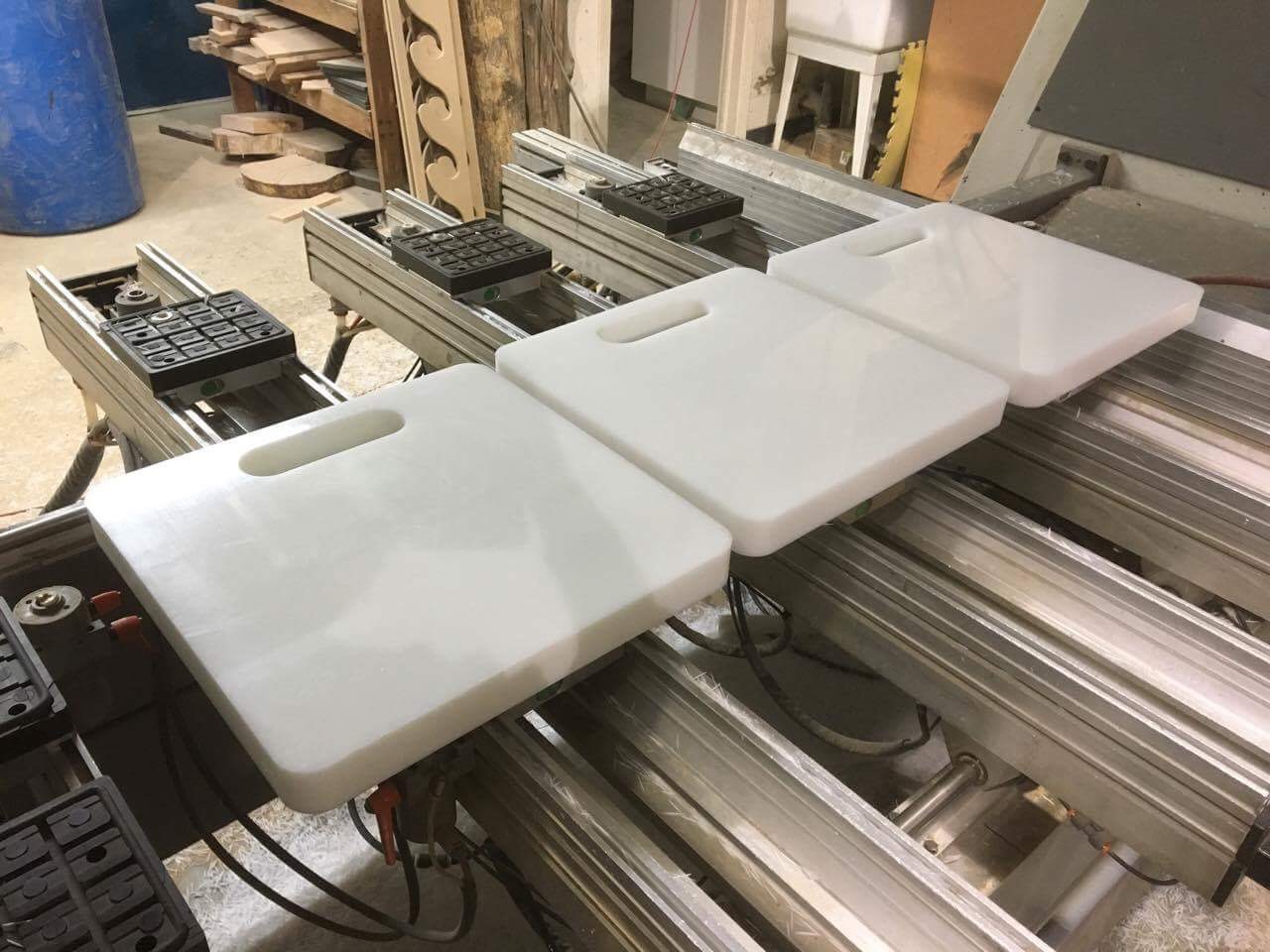

22 Feb 2017 19:20 #88509
by bevins
Replied by bevins on topic Biesse Rover 346 Retrofit
First job on the machine, in and out. It did a great job. 3 hours faster than what I quoted.
4X8 sheets HDPE 1.5" thick.
Now I have to finish the machine....

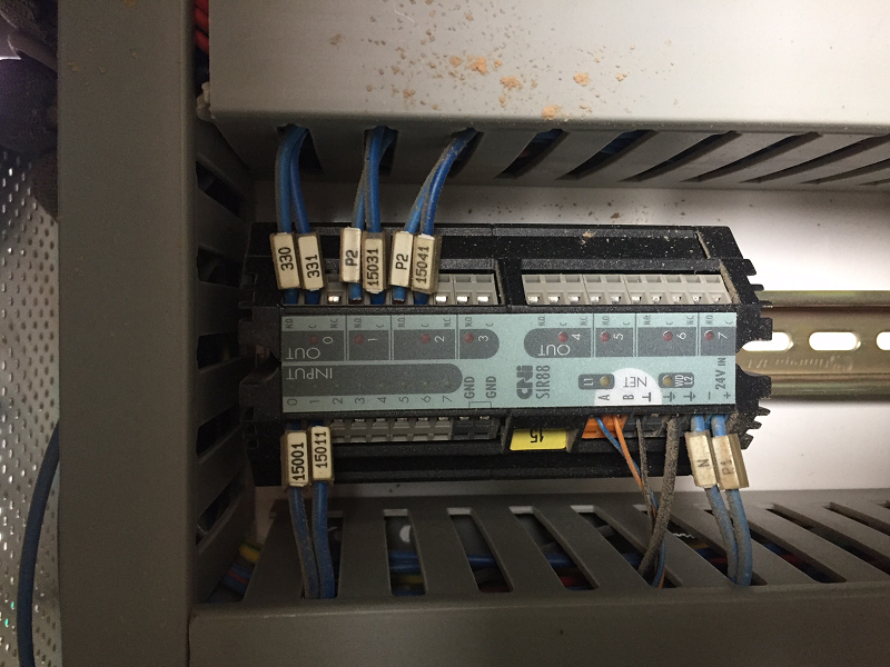

23 Feb 2017 16:15 #88547
by bevins
I have been getting requests for these machines. I think I will start a thread for this not to contaminate my build log. But.....
After 1997 or somewhere around there, Biesse decided to change up their controllers. They got rid of the proprietory cardcage hardware backplane type controller and replace it with a PC running a form of Unix. Dont know yet what but it is unix.
Then they have made these RS485 input and relay boards to replace the relay boards I have on mine that are controlled directly with output of mesa's outputs.
To get thes relay boards to work I think there are three options.
1. Try to get the RS485 working with LinuxCNC. Guess would have to know the Biesse protocol to operate these and get inputs.
IF this is done and you can somehow connect rs485 in/outs in HAL makes this conversion easy and I would comment the retrofit could take days and not weeks.
2. Modify the boards so have a wire connecting directly to the relay and cutout the RS485 on the board and place remote 7i84's in the machine.
3. Use remote 7i84 in the machine and purchase relay boards and run the inputs directly into the mesa boards.
Those are the three options I see. There are alot of these machines with the RS485 boards, so it would be nice to get LinuxCNC to talk to them.
I know there is already modbus working, but probably just need to implement the protocol that Biesse uses. What I am questioning is are these coms fast enough for LinuxCNC to react for things like classic ladder and limit switches etc..... It does on the existing machines so I would assume it would be ok in LinuxCNC.
What are your thoughts on this?
You can see by the attached pic that it is using half duplex RS485 (2wire).
One thing to note that modules seem to homerun back to the controller and not daisy chained. They could very well be using star configuration on the board they connect to but not sure. They seem to have different addresses so maybe they are all on the same port. I dont know yet.
