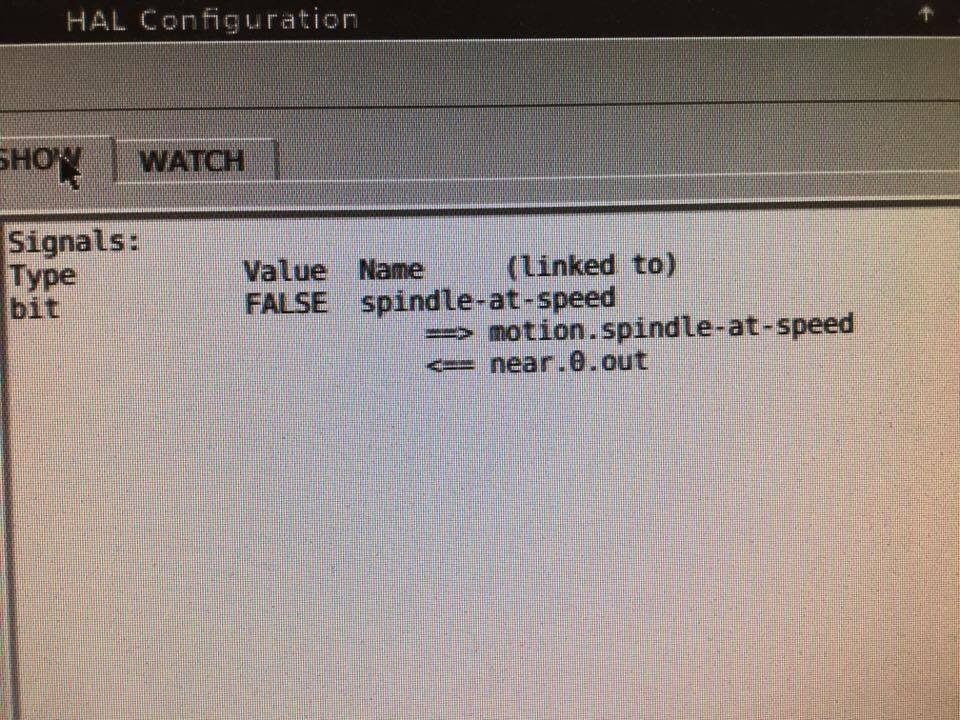

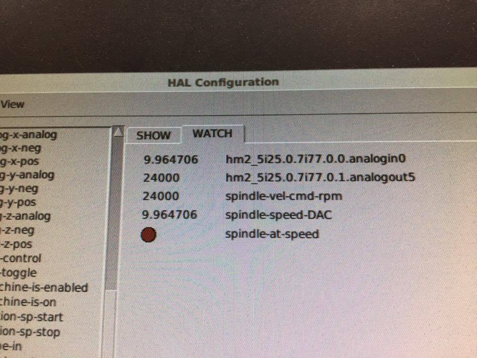

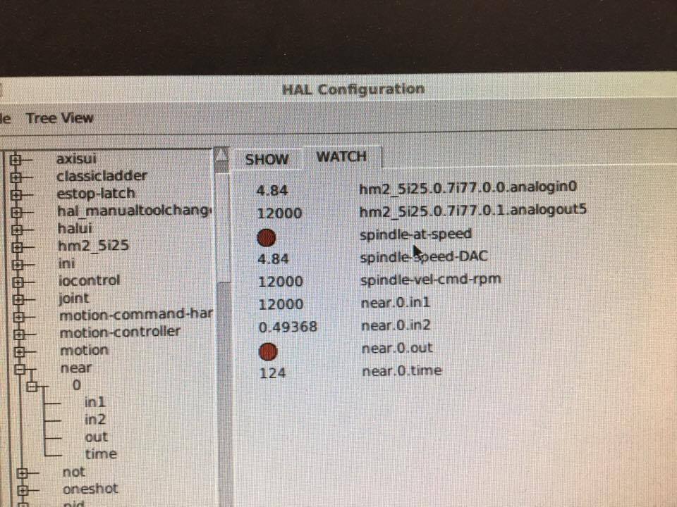

Replied by bevins on topic Biesse Rover 346 Retrofit
Still cant get a handle on it.
I am using motion.spindle-speed-out sending 0-10 to the spindle inverter.
But this says the analog in is an out pin....
BS_346.hal:224: Signal 'spindle-speed-DAC' can not add OUT pin 'hm2_5i25.0.7i77.0.0.analogin0', it already has OUT pin 'scale.0.out'
INI file:
# Spindle
[SPINDLE_9]
OUTPUT_SCALE = 24000
OUTPUT_MIN_LIMIT = 0
OUTPUT_MAX_LIMIT = 24000
I am at a loss.

- bevins
- Posts: 1947
- Thank you received: 338
11 Feb 2017 18:14 - 11 Feb 2017 18:17 #87831
by bevins
I think I have it setup properly, but spindle-at-speed never goes true, so the program doesnt continue.
It is really close.......
Tried tweaking the near scale up and down but nothing yet.
Both analogout and analog in are the same so it should set spindle-at-speed true I would think.
Warning: Spoiler!

The spindle output 0-10 is being scaled by the board but it is going from rpm (gcode) to analogout 0-10.
I need analog in so it has to be reverse scaling so:
The scaling the other way is 10/24000 should be the gain. Thats going from rpm to analogout 0-10
so my calculations are it should be the other way around for 0-10 to rpm which should be something like:
10 X 24000 = the gain
Does this logic make sense?
/EDIT Apparantly not. Doesnt work. I am all out of ideas.

What you need to do is scale the analogin to match your RPM. That is what the scale component we added is for. Use the setp scale.0.gain to set that and from the images you posted from the pins watched it should be about 2400 (not 0.102)
setp scale.0.gain 2400
You'll probably want to make the near scale closer to 1 but I have never used a near comp.

The spindle-at-speed saga is finished. It is working somewhat.
It is not linear so the farther away you get from the max the more the difference is. There is a tradeoff. I cannot get 1000 RPM because I would have to set the near scale to 3.5 but then if I request 24000 it will be spindle at speed at like 6000 RPM. I can live with this for now. Will never have the spindle at 1000 rpm. Wood routers are not ideal at 1000 rpm.
Thank you Todd for your help with this. I learned alot and it will be a long time before I forget this one. Helps with all the other comps....
So the machine is up and running. Theoretically I could be cutting some wood now. Have to work out the spindle selects, and start thinking about the tool changer, and of course the control panel.
on with the show.........
NEXT!!!

Perhaps you need to set this pin "near.0.difference" to something.other than the default of 0. and keep "near.0.scale" closer to 1.
setp near.0.difference 500
You might also need to fine tune "scale.0.gain" and "scale.0.offset" a little better..
