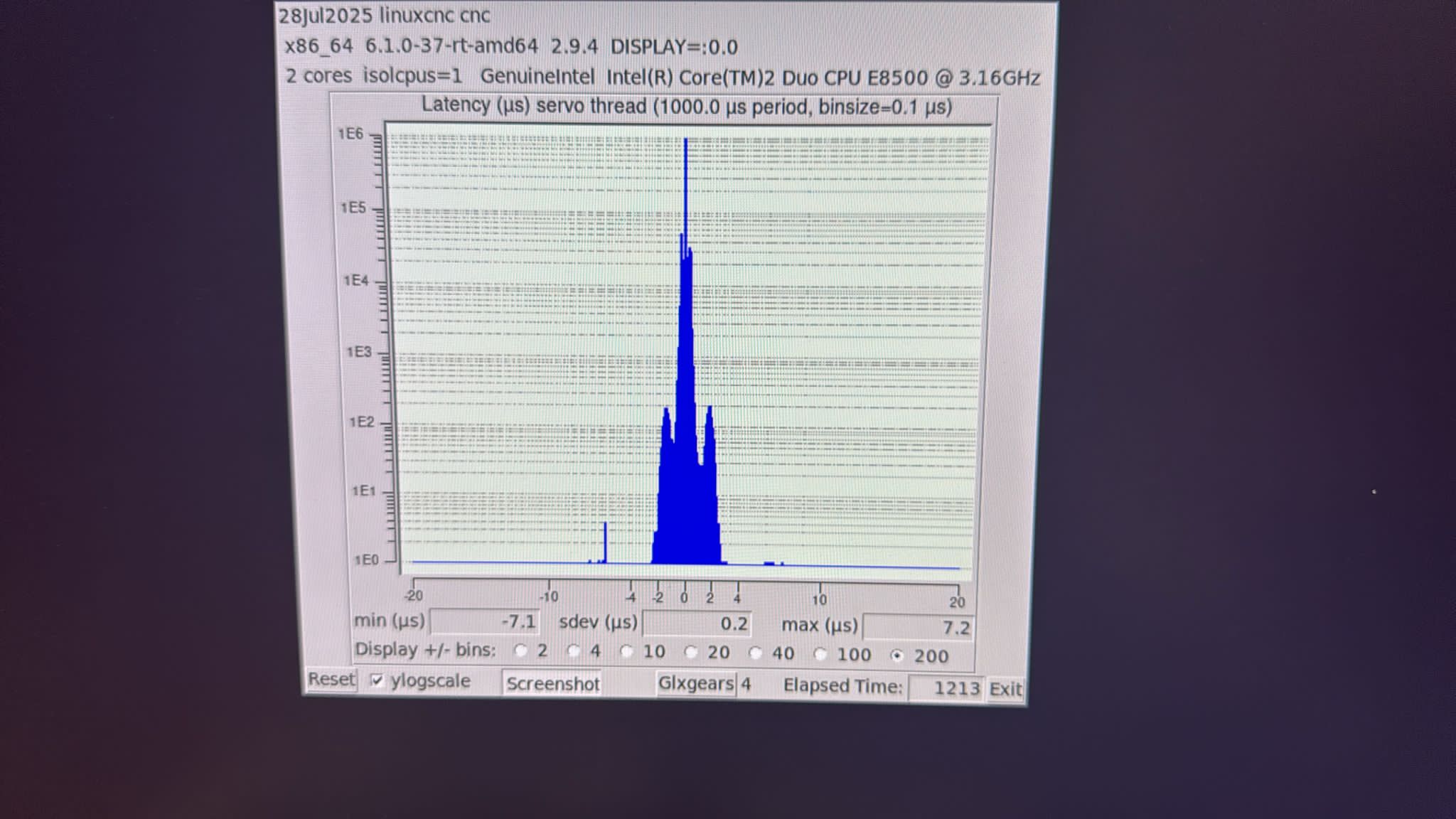

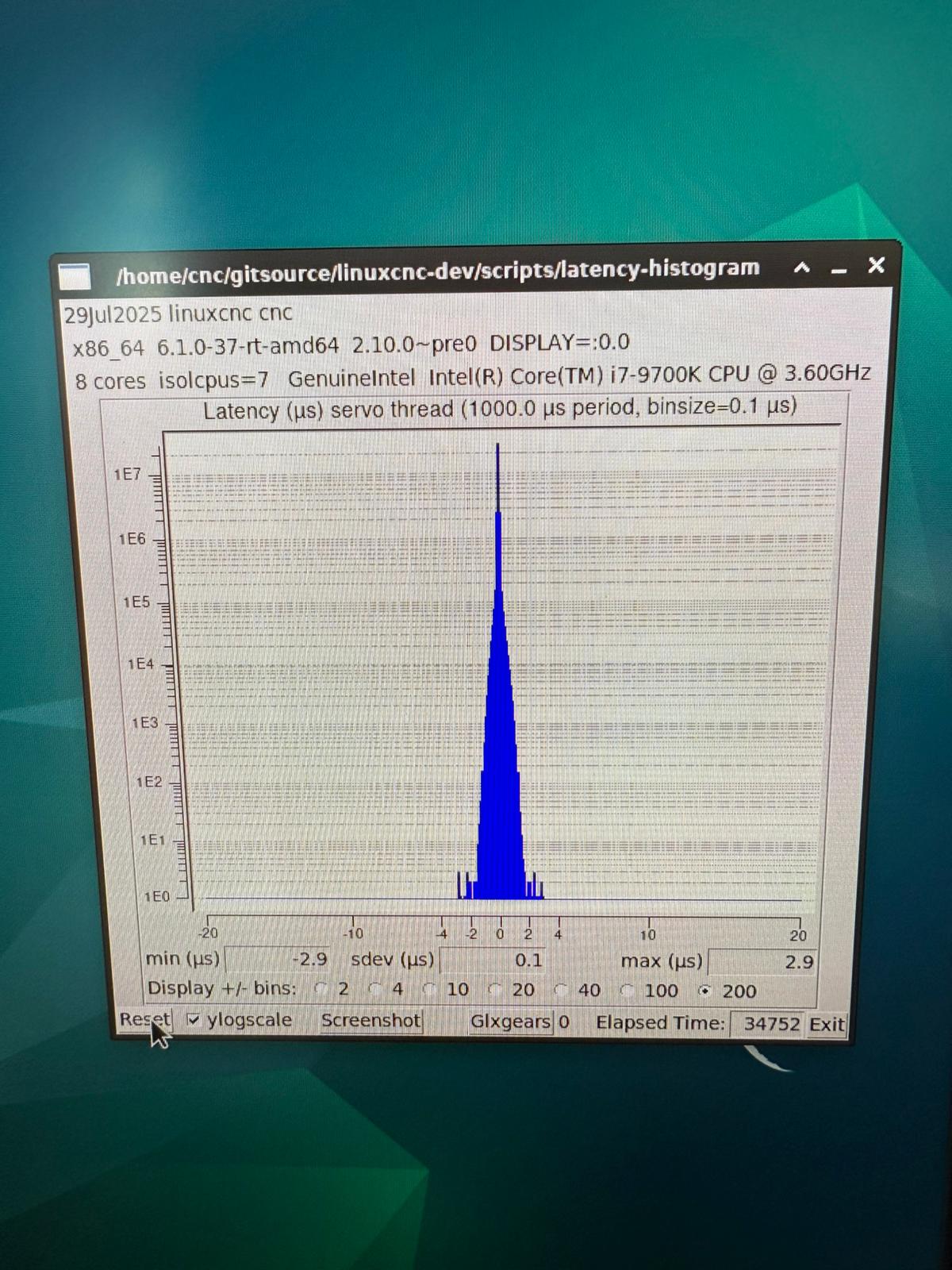

by endian
Replied by endian on topic LinuxCNC S-Curve Accelerations
first of testing was 3dchips.ngc and second the 1001.ngc When I removed the base thread ... most of spiking was gone but last spiking ( less then 300us peaks - core duo, less then 200us peaks - i5 C6930-0060, 80us peaks - i7 ) are present during the in the clouds ... but it is more then perfect and extremly usable for everybodyit amazing job for sure !!!

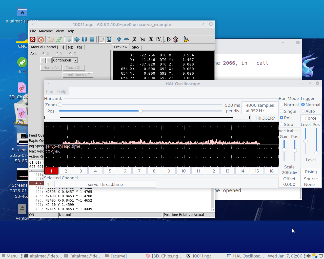

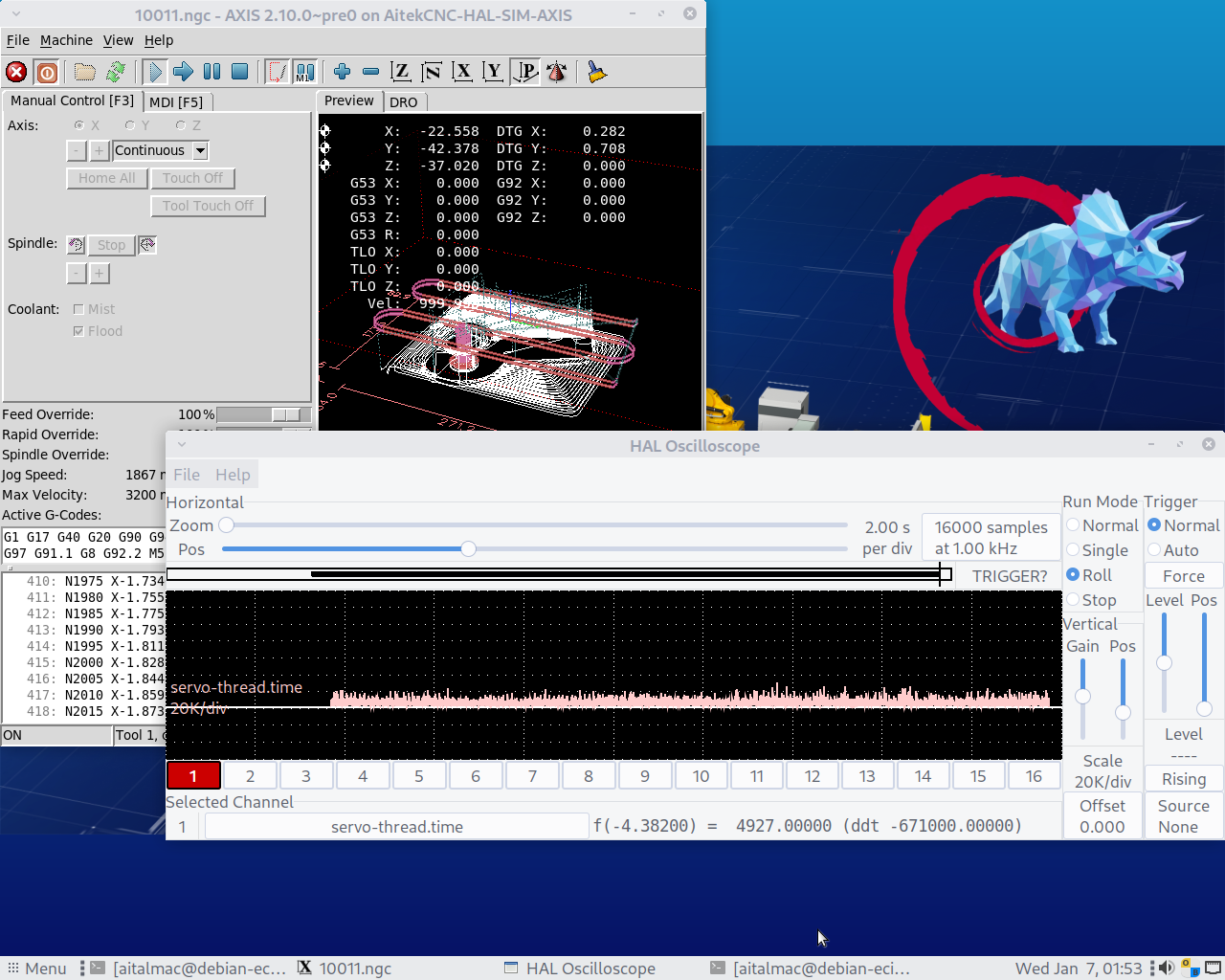

Yes I just finished testing, and our S-Curve acc tp seems to be computationally better, and spiking less the servo thread compared to the original trapez acc tp, as far as I see, thanks to our work you are getting a better and more computationally efficient TP with planner_type = 1
Now I'm a bit confused about what spikes you want me to fix, the pictures you sent are of the latency-histogram, which I think you cannot even run when you are running linuxcnc, interpreting gcodes, and actually run our code the new s-curve acc tp, planner_type = 1
I think you might have some misunderstanding of where our S-Curve lives within the LinuxCNC architecture, we only changed the TP which stands for the Trajectory Planner. The Trajectory Planner is not calculating anything when you run latency-histogram, whatever spikes you see in latency-histogram have no connection with the Trajectory Planner, does that clear things up? Or is there something I'm missing? Am I misinterpreting you? Or am I missing something else?
Edit:
On our system I see way more spikes when moving windows around, opening glxgears, or even simply having halscope in view rolling the servo-thread, when halscope is minimized I have way less spikes to 20k compared to when I run either g-code you supplied. There is a catch I can only see that I was having less spikes AFTER I restore halscope in view, and then the spikes start again, making me conclude that the act of checking the spikes with halscope introduces more spikes than anything we are doing with the S-curve or trapez TPs, but I repeat in my testing our S-curve is more computationally efficient than normal trapez TP
Edit:
