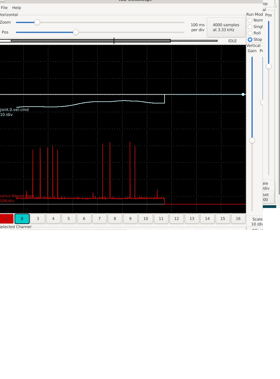

Spikes when you run latency-histogram are caused by the CPU doing other stuff, like checking the network status, reading your mouse and keyboard inputs, display graphical elements, going to sleep because its got nothing to do.
This is not in topic of this discussion about s-curve
Edit:
My test methodology was analytical, I ran same g-code, on same machine, same halscope size, changed the least variables as possible, only planner_type 0 vs planner_type 1
Please in future if anyone wants to bring forth issues about our s-curve implementation, they should use similar testing methodology, during our own internal testing of the S-curve calculations, we also often forgot to do this straight fair comparison, and it sent us on wild goose chases. Mind that we are aware that there are blending issues, this is something that we are working on, but these issues persist in both planner_types. Therefore please try to compare planner_type 0 vs planner_type 1 without changing anything else before bringing forward issues.
Edit:

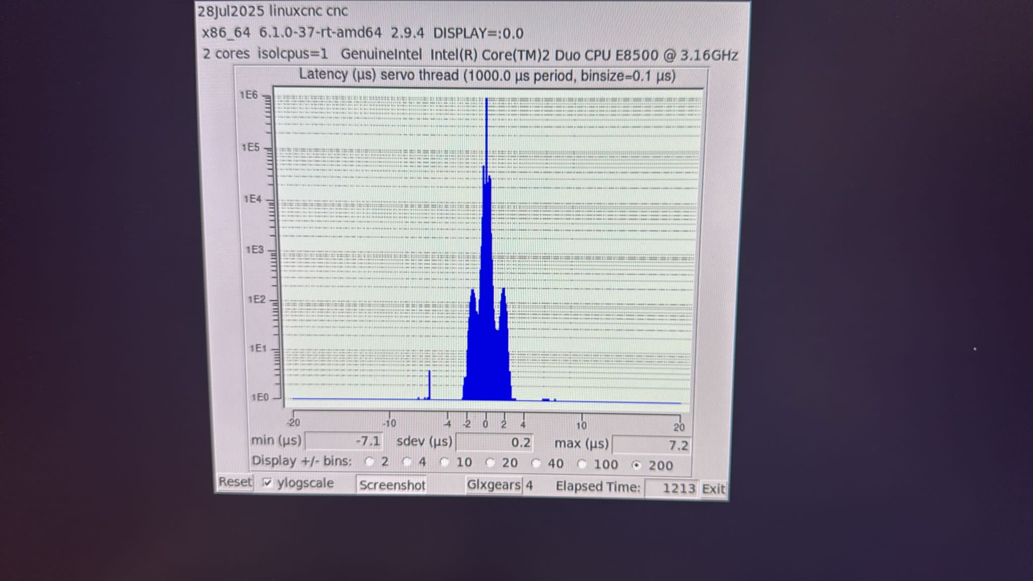

I think we are not understanding us now ... I just share latency histogram to just prove my RT and latency free setup(eliminate hardware setup source), not to share pictute of spikes of my latency... I defenetly know that latency histogram and scope are two different things but over histogram we are fast and visible proving our setup of RT...
here is scope of Intel core duo and AI tells me that Intal core duo has not some hardware instructions which can cause overloading from time to time ... here was most visible spiking
Edit > yes my testing was doing exactly as you are talking ... first test was 3 phase and the 7phase generator ..
it was just testing after experience with scurve of grotius where spiking what much greater and creating time lagging during cloud of point movement ... this situation is now not present at all I think, it works really well .. motion is excelent
great job ! I am amazed.
Last edit: 07 Jan 2026 02:07 by endian. Reason: adding testing routine example

Yes, I think I understand you better now. Still you asked me what I would be doing about the spiking, and in my testing there is no spiking that I should be doing anything about, at least as far as the code we have contributed, and as far as my testing shows to me, but I am open to different hardware having different reactions to the algorithms, but this has to be empirically shown to be true with a test similar to mine, it is easy to introduce third variables unintentionally, so any testing has to be done with the least variation as possible, try to change only planner_type 0 to planner_type 1
This toggle exist exactly for the purpose of quick comparison between original trapez vs new s-curve.

I definitely agree with your opinion ... therefore I have testing at CoreDuo, i5 and i7 too ... and then just share my observation
As I said before I am not expert of this topic but it is very interesting to help if there is a play to ...
can you share your hardware setup with us which is the best to avoid spiking please?
