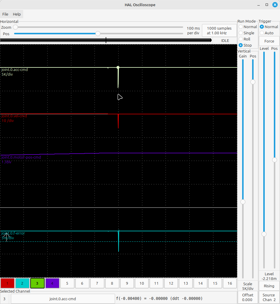

Just a quick test and I got large following errors:
ini setting are:
ini setting are:
Last edit: 08 Jan 2026 17:50 by PCW.

Replied by andypugh on topic LinuxCNC S-Curve Accelerations
Is a jerk of 2000 reasonable? What units is your config?

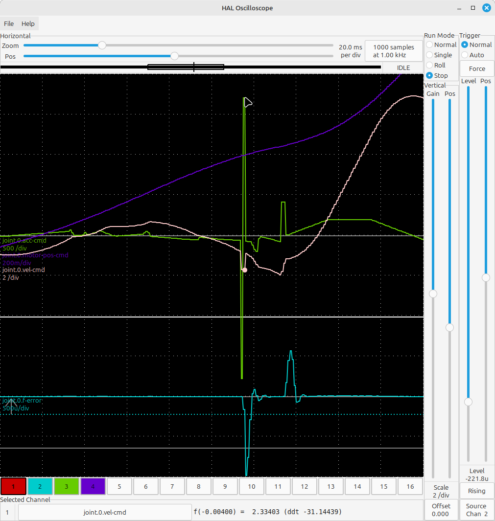

08 Jan 2026 20:02 - 08 Jan 2026 20:05 #341187
Replied by PCW on topic LinuxCNC S-Curve Accelerations
OK so the bad ini values seem to be LinuxCNC defaults (they were not specified in my ini file)
With more reasonable values set the errors are of much smaller magnitude bu there are still accel violations:
Note that the acceleration (green) which has a constraint of 200 IPS/S sometimes obeys this constraint
(right side of screen) but sometimes ignores it (spikes toward center of screen reaching more than 1500 IPS/S)
ini file settings:
ini file settings:
Last edit: 08 Jan 2026 20:05 by PCW.

08 Jan 2026 20:42 #341188
by grandixximo
Replied by grandixximo on topic LinuxCNC S-Curve Accelerations
Could you try again with arc blend enable to true?
