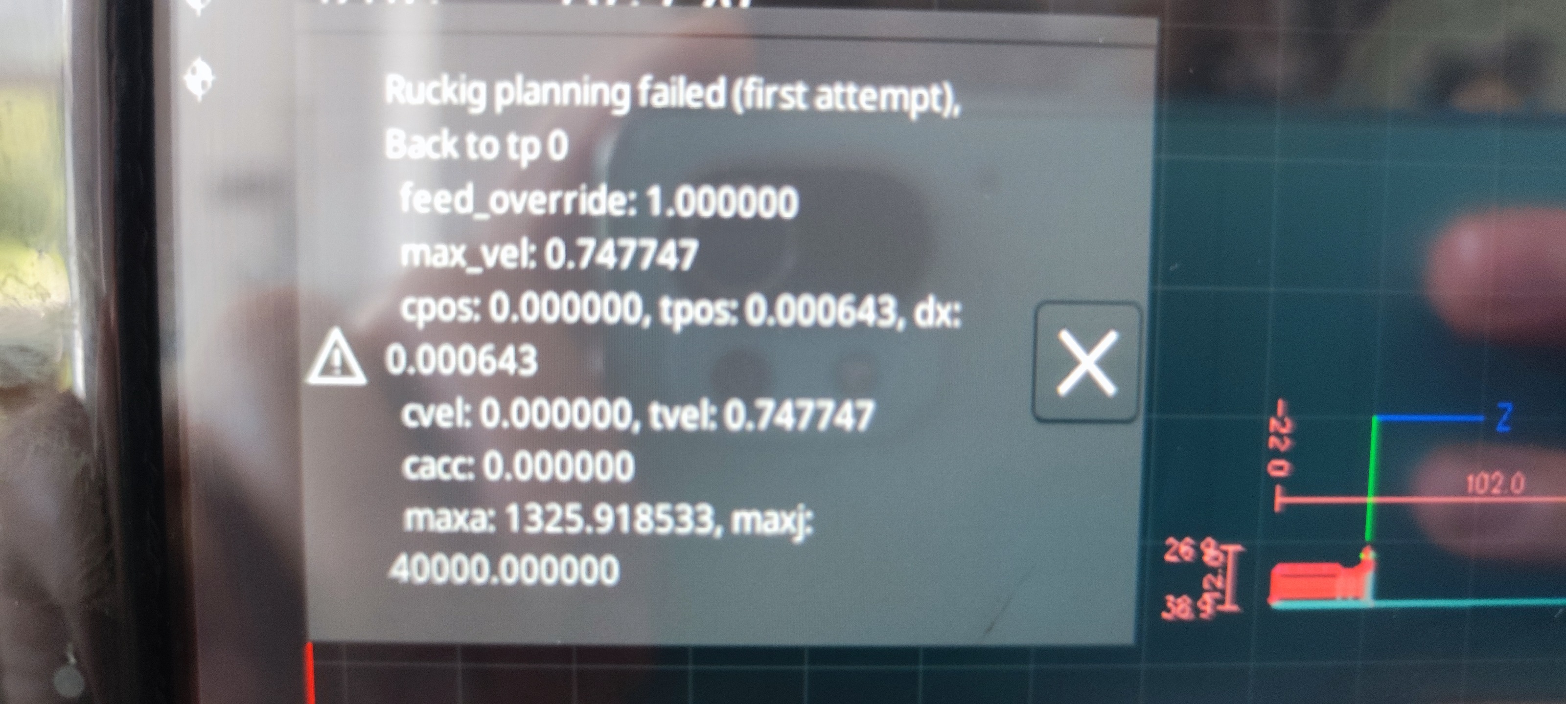

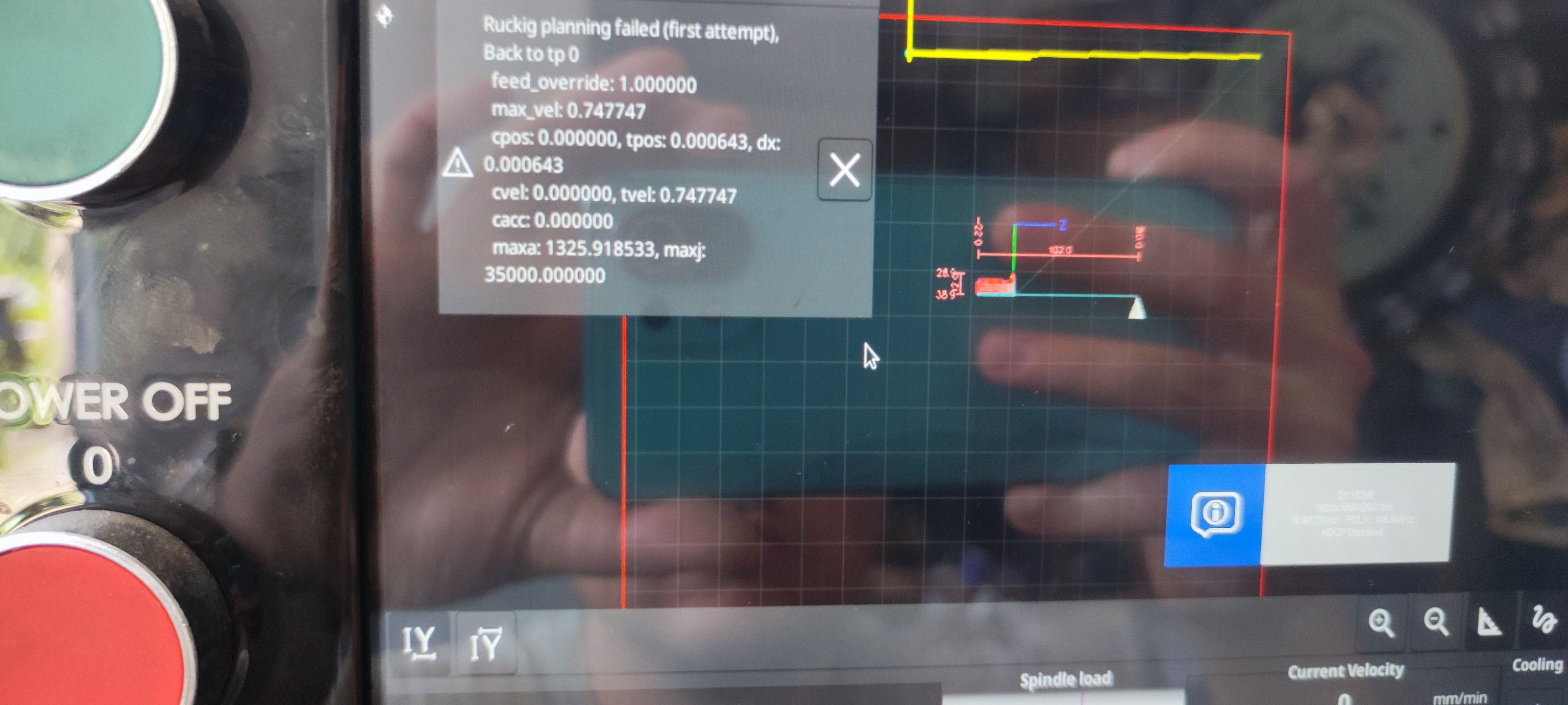

04 Aug 2026 02:25 - 04 Aug 2026 06:09 #348435
by besriworld
Replied by besriworld on topic LinuxCNC S-Curve Accelerations
I got this error. I reduced the acceleration slightly, and after that I produced 20 parts without any errors. Today the same error appeared again. I then restarted the same program, and so far there have been no errors.
on another part I get this error
ps:
I reduced the maxj quite a bit, but there is no change. I think it is related to the synchronized movement of the spindle.
ps:
