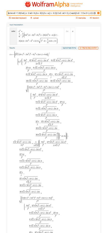

I've done some more work on this. I worked through the remaining equations and ended up with something I simply don't know how to solve. I believe it's a cubic equation, but it contains the root of a sum of the squared dependant and other variables:
t2^3 = 1/6*(6*a0^2*j0*t2 - 2*a0^3 + 6*j0^2*s_target - 6*(2*j0^2*t2 - a0*j0)*v0 - 3*(2*j0^2*t2^2 - a0^2 + 2*j0*v0)*sqrt(j0^2*t2^2 - 1/2*a0^2 + j0*v0))/j0^3, where t2 is the variable to solve for.
Anyway, I tired of banging my head against these equations, and decided to try a numerical solution for the remaining cases instead:
Of course a numerical (iterative) solution is not great in a real time system. I benchmarked the code - and got a bit of a shock when it reported ~100 ms for a solution! That's eons of computer time! Then I realised I had a lot of debug printouts. Rmoving them brought it down to ~7 ms. Still way too much. Maybe I should try an optimised build instead of a debug build? That gave another factor 10 improvement - but still too slow. Then I realised that maybe I don't need picometer accuracy *lol*. Changing it to 0.1 µm brought the calculation time down to less than 50 µs on my i5-3470 CPU. Still not great but at least it's in the realm of usability. For comparison, the cases where I have an analytical solution benchmarks at about 2-3 µs.
It should also be possible to optimise the algorithm to converge faster. And I haven't given up hope on an analytical solution, either. Maybe there's help to find at Mathematics Stack Exchange or even the local university, if needs be.
I still have a few test cases unaccounted for, but they should be variants of the ones I already have so should not present any huge difficulties. (One can hope, at least.
) Then it's off to integration with linuxcnc. One positive thing about using a numerical solution is that it doesn't need the cubic solver from the GNU Science Library, which removes the GPLv3 "taint".

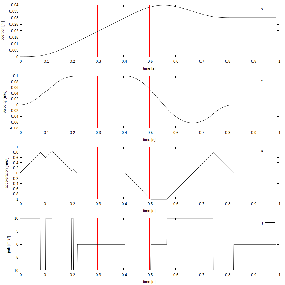

Here's the output of the "jlim_complex" test. It's supposed to model jogging with a (course) MPG. It sets the target position to 0.01 m at t = 0.0; 0.02 m at t = 0.1; 0.03 m at t = 0.2, 0.04 m at t = 0.3 and then back to 0.03 m at t = 0.5:

Thanks, I already got pretty much the same thing out of Sage Math. I have no idea what to do with those sqrt(<something>*i) though!
Although those types of expressions do turn up when solving cubic expressions in general, so it's probably possible to do *something* useful with it!
Edit: After a closer look it looks like WolframAlpha did find a real solution - the j's are from the input equation? If so that equation could actually be useful.
Replied by arvidb on topic LinuxCNC S-Curve Accelerations
Last edit: 20 Mar 2021 11:16 by arvidb.

There is actually a cubic version of the quadratic formula . I don't know why schools ignore it.
Replied by andypugh on topic LinuxCNC S-Curve Accelerations

Yes, as explained I had a solver for such equations from the GNU Science Library in the code, but the equation in question is not in the correct form, since it has roots of sums including the dependant variable in it. I'm not even entirely sure it is a cubic equation, but I'm guessing some math magic would turn it into one.
