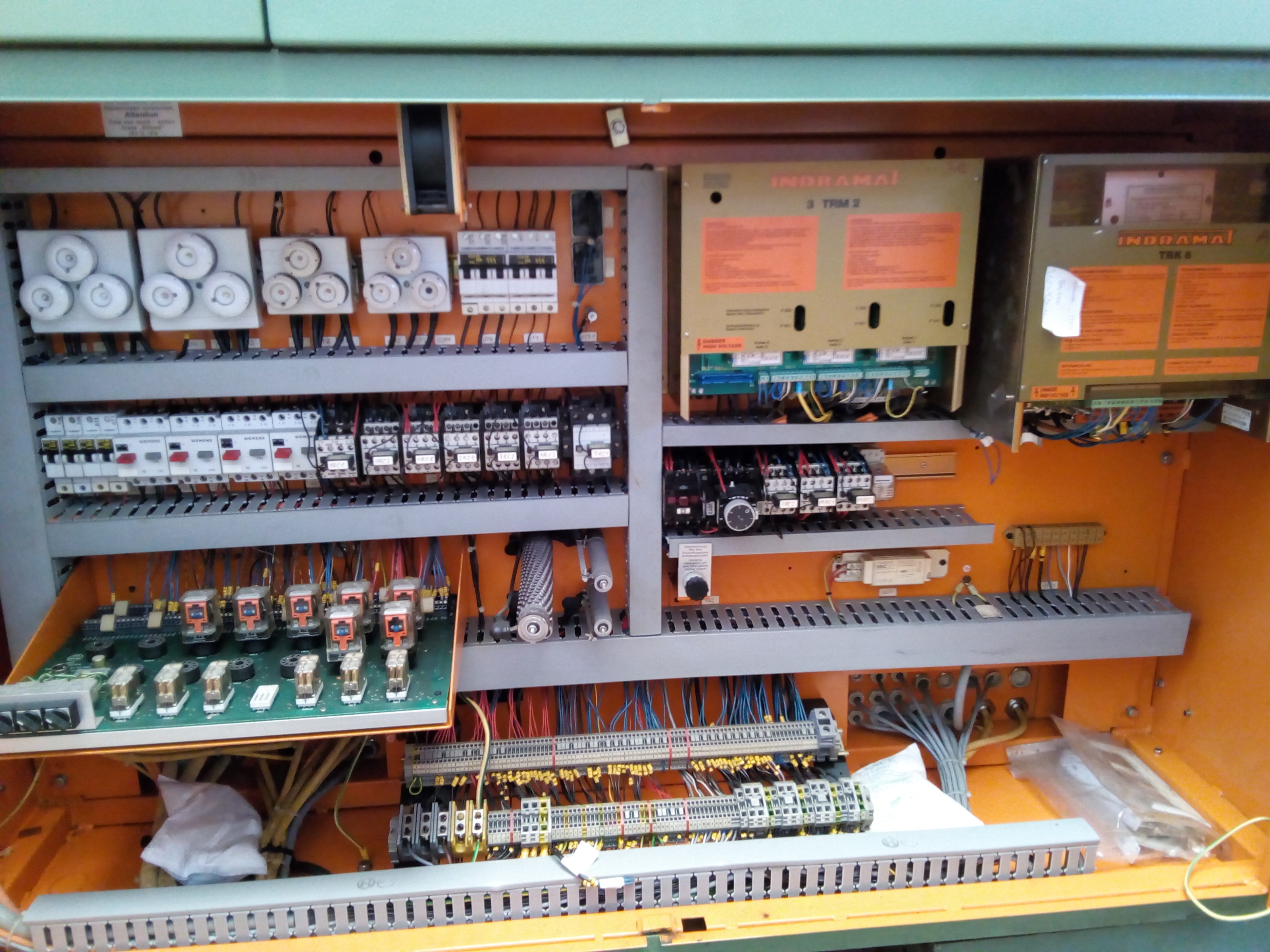

-The scales are Philips photoelectric of 11μamp.Hi
Glad to see you are still here on the Linux CNC forum .
I am interested in what scales your MH300C machine has. Are they Philips or are they Heidenhain scales ?
I am also interested in what servo drives and what spindle drive your machine has.
Do you have a parts manual and the electrical schematics for your MH300C ?
Would it be possible to get photos of your MH300C showing ---- inside the electrical cabinet --- the servo and the spindle drives ----the Z axis scale label / manufacture label and also the transmission shifting motors located on the side of the Z axis ?
My reason for those photos is they can show a lot of information very quickly and exactly what is what.

Are you certain the Phillips scales are 11µA output? Müllernick converted a 700E which also had Phillips scales, and found his had some non-standard output. Ended up replacing them with modern TLL output scales.

Technician said me that scales was 11µamp...(?

Do you have access to oscilloscope to see what the signal looks like?
