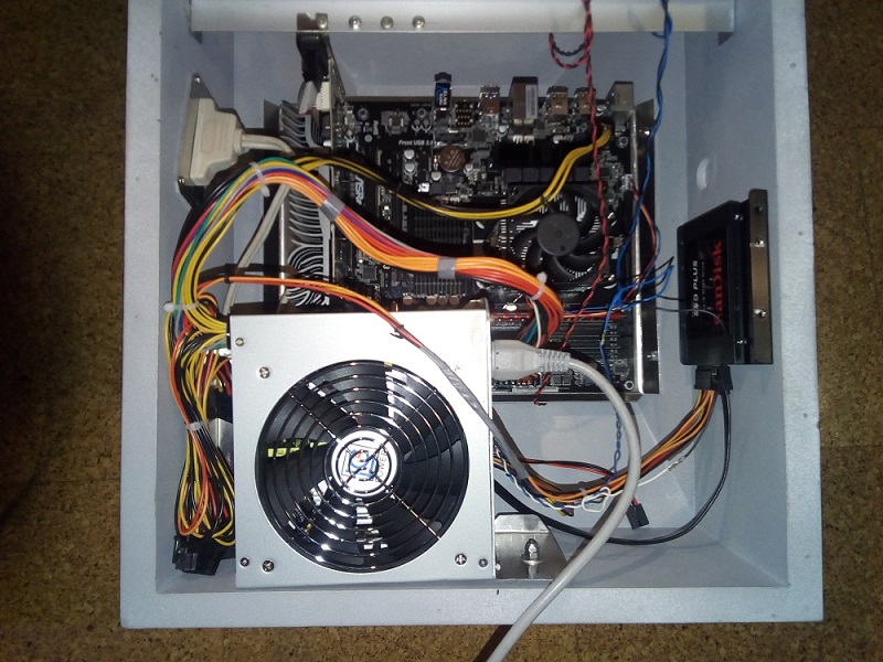

Ok. I already have two USB2.0 ports facing the outside, soon I will put two more also facing the outside but USB3.0
Here my PC (desktop) under the control panel.
Motherboard ASRock 970M Pro
AMD FX (tm) -6300 Six-Core 3.5Ghz Processor
4GB RAM
Sata Disk SSD 120Gb
Graphics Asus ... (???)
Graphics and disk are the same as previously mentioned. The rest of the components are new, the old pc did not support and did not have the necessary requirements.
4GB RAM
Sata Disk SSD 120Gb

I have a problem now, I can not format the computer with Linux operating system, I tried to boot from the pendrive but nothing, always goes by operating system that was already installed on the disk.
On the old computer I had no difficulty, but in this I am having

14 Jan 2019 18:43 - 14 Jan 2019 18:48 #124206
by Grotius
Replied by Grotius on topic Maho MH 300 C Retrofit...?
What you can try is put the hard drive in other pc with internet acces and cd drive. Then Install the linux iso. After that, Put it back into your machine pc and cross your fingers.
Other way is put a temponary cd drive on your machine pc. Or install it with usb. Try to hit F8 F9 F10 F11 F12.... during startup,
then you will be in bios if you are lucky.. Then you can choose your boot startup way... It can be usb boot is not active at this moment. You need to set it active. Some time's only a factory reset will do your job. This factory reset option is at the left side of bios setup.
I advise to install a 64 bit linuxcnc version. Not the old scool 32 version
Good luck Fernandes.
