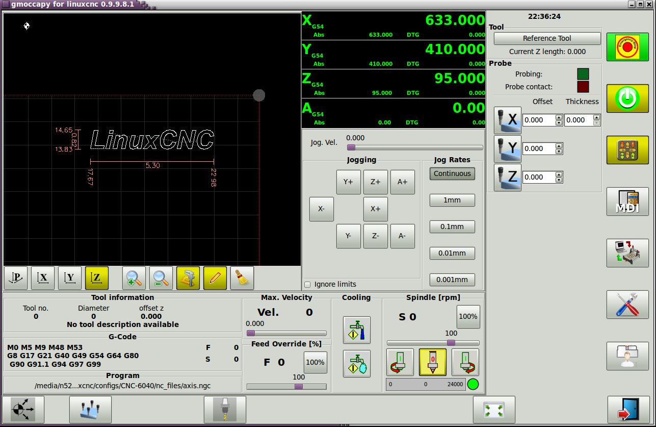

10 Jun 2018 05:16 #112125
by Fermaq
Replied by Fermaq on topic Maho MH 300 C Retrofit...?
- emcPT
- Posts: 424
- Thank you received: 95
11 Jun 2018 02:09 #112176
by emcPT
Replied by emcPT on topic Maho MH 300 C Retrofit...?
If you installed the linuxcnc iso, then you have linux + linuxcnc. In the menu you do not have a group of programs that are named linuxcnc ?
In the picture that you sent, it is linuxcnc running gmoccapy, that is a "front screen" to linuxcnc that can be customised.
