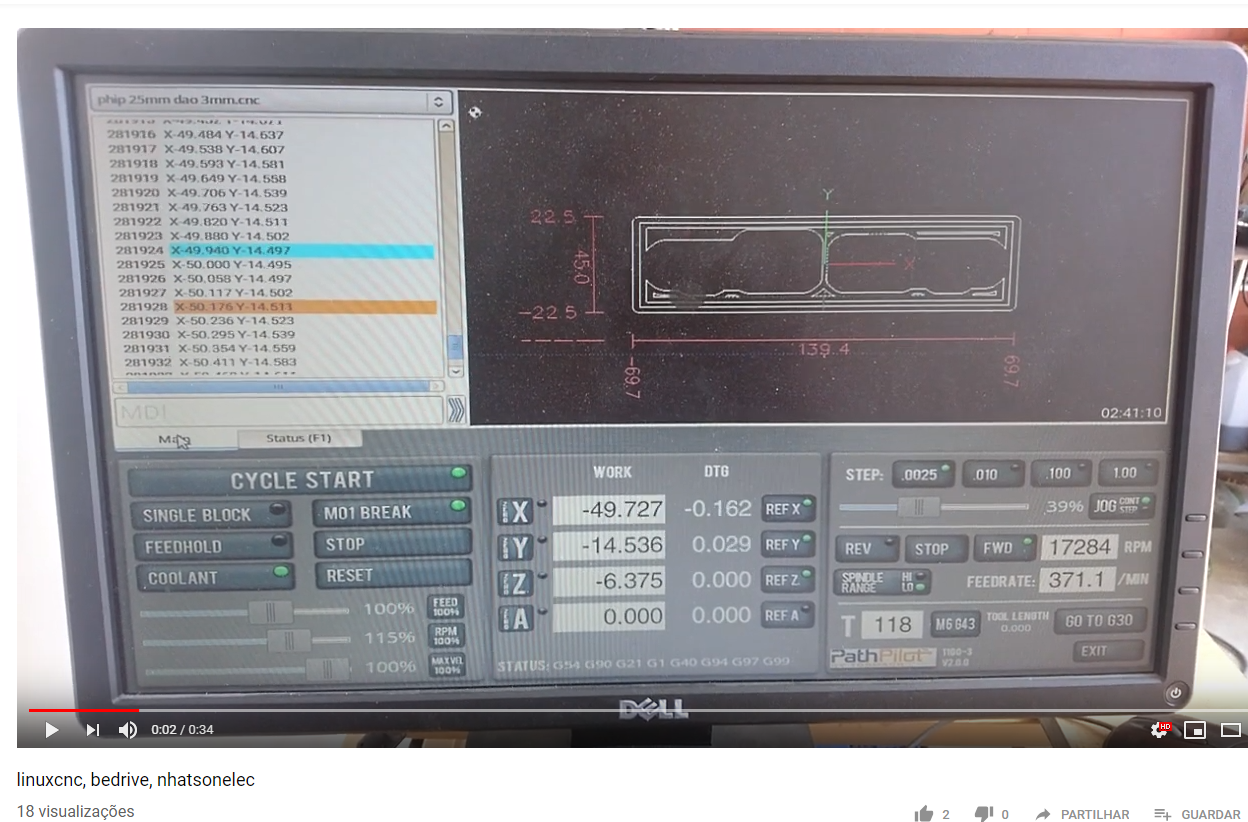

26 Feb 2019 14:41 #127183
Replied by andypugh on topic Maho MH 300 C Retrofit...?
I think it is possible (that looks like PathPilot (based on reading the logo))
There are threads on here about running PathPilot on a non-Tormach machine. My impression is that it turns out to be more trouble than it is worth.

27 Feb 2019 08:03 #127247
by RotarySMP
Replied by RotarySMP on topic Maho MH 300 C Retrofit...?
I'd also recommend you start with one of the widely used, prepackaged GUI such as Axis or gmoccapy. Don't ge too hung up on GUI layouts, until you have the machine up and running. If you still consider the eye candy important, switching between the supported GUI is very easily done by changing a line in the INI.
