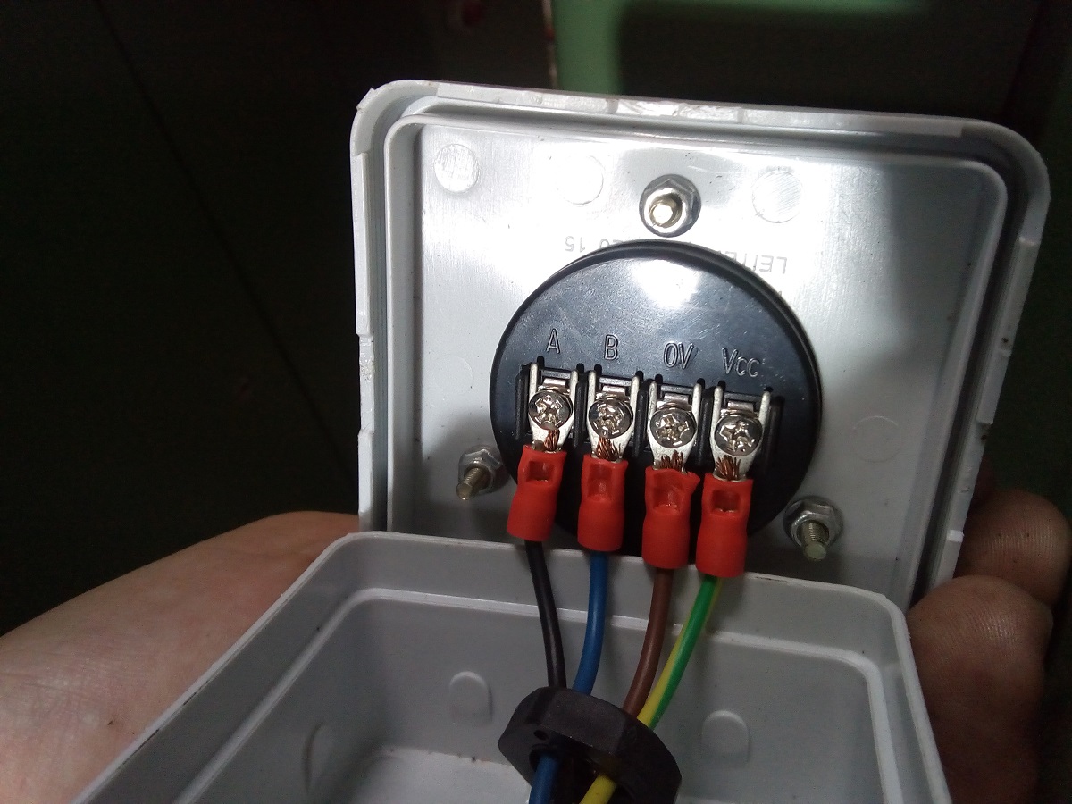

I'm afraid I can not do the retrofit with Linux 5i25 / 7i77 Table so I hope I can count on your help. Connecting the wires I think for me is no problem, but part of the programming / settings, ... I see this very dark.

I had already taken a few steps in the way I was following, I hope I can keep the work done to use with 7i77. There are things I wanted to keep as traditional ...
Can I reuse this handwheel with linux and Mesa 7i77?

Hi Alexandre, that jog wheel encoder should work with the MESA 7i77.

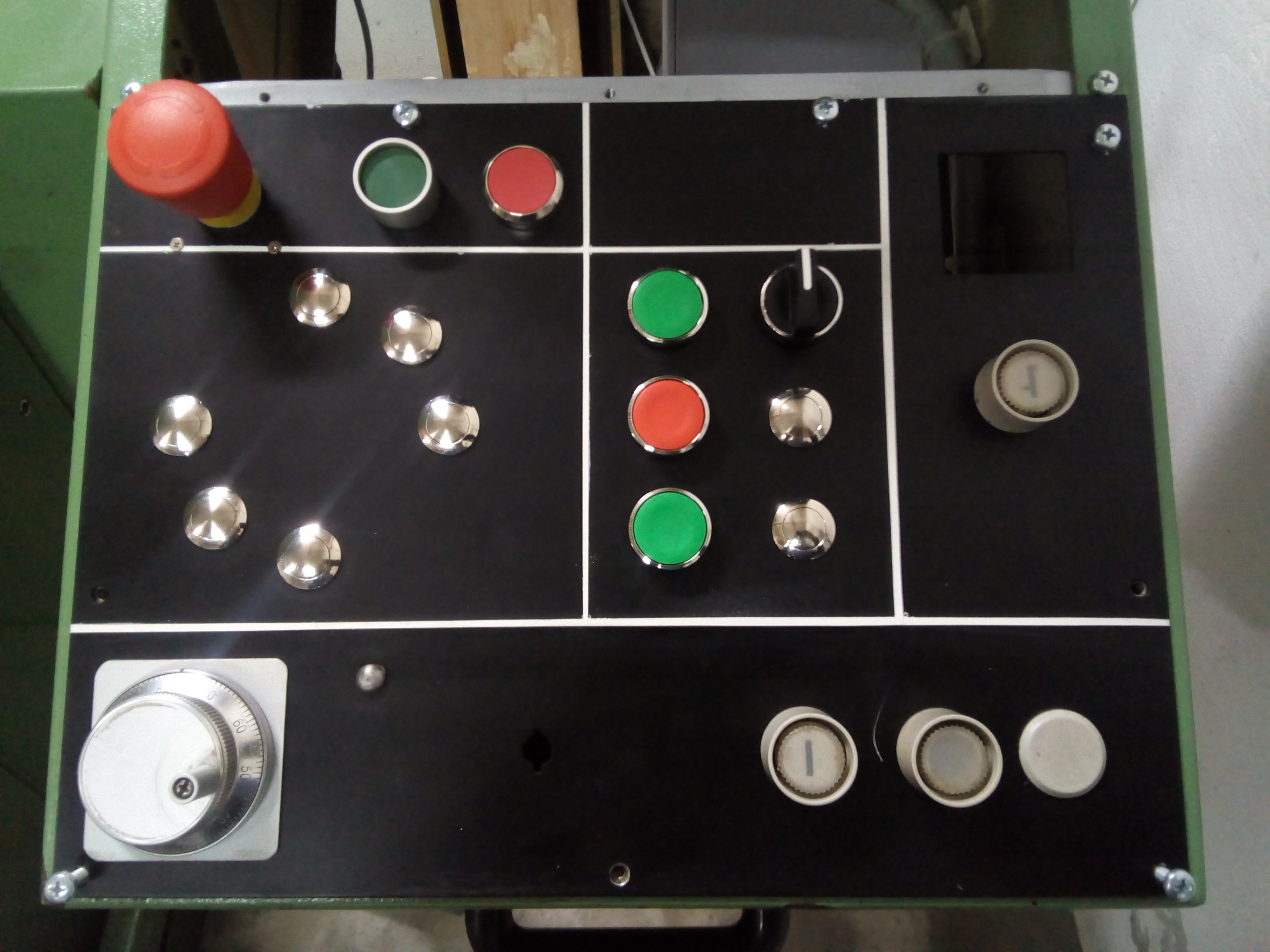

My desktop I go put here, under the control panel
