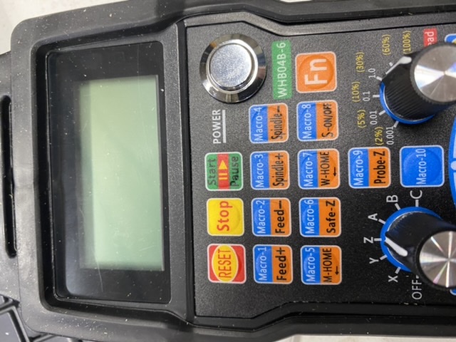

Im using Deb Stretch with 2.8 ( fresh install )
lsusb gives : Bus 001 Device 006: ID 10ce:eb93 Silicon Labs
Do i need to do anything additional ? Compile, change ?
Tried using sample config of linuxcnc with xhc-hb04 and keep getting this error :
"waiting for xhc-hb04 device"
Keith
Keith

- TKWard10000
- Posts: 13
23 May 2020 22:27 - 23 May 2020 22:35 #168730
by TKWard10000
Replied by TKWard10000 on topic XHC-WHB04B-6 LinuxCNC not working
My device IS a XHC-WHB04B-6.
I understand EXACTLY what the topic is for.
Perhaps, some constructive help, rather than giving attitude would be beneficial ?
After reading 12 pages of this thread ... and others telling people to test things using the LinuxCNC 2.8 driver ( which I specifically installed to use the MPG ), and using the command line program, I am at a loss.
I know the MPG works ( tested on Windows Mach3 ).
Does any one have any ideas ?
Last edit: 23 May 2020 22:35 by TKWard10000. Reason: Add picture
- alkabal
- Posts: 476
- Thank you received: 52
23 May 2020 22:39 - 29 Jun 2020 21:03 #168733
by alkabal
Replied by alkabal on topic XHC-WHB04B-6 LinuxCNC not working
Well i only have some doubt because you says xhc-hb04...
First check the folder "/etc/udev/rules.d/" is there the files 99-xhc-whb04b-6.rules ?
you can also try sudo nano /etc/udev/rules.d/99-xhc-whb04b-6.rules for check if the files is ok.
Secondly
open a terminal without starting linuxcnc
halrun
loadusr -W xhc-whb04b-6 -Hsf
and open a second terminal
second :
watch -n0.4 halcmd show pin whb.
If the device and driver work you can see several entry in the second terminal.
Secondly
halrun
second :
Last edit: 29 Jun 2020 21:03 by alkabal.
- TKWard10000
- Posts: 13
23 May 2020 23:06 - 23 May 2020 23:19 #168739
by TKWard10000
OK, Thanks
Reason I mentioned 'xhc-hb04' prior was that people had been using that utility to test the MPG ( mentioned several times in the thread ).
Regardless, I appreciate the help
/etc/udev/rules.d/ has no files in it at all
The watch terminal appears to react to button presses. Macro, feed + etc etc
X Y Z feed counters do not go up and down. Is this correct ?
Also, is there a 'current' configuration cheat sheet for adding the MPG to my hal files etc ?
Keith
Keith
Last edit: 23 May 2020 23:19 by TKWard10000.
