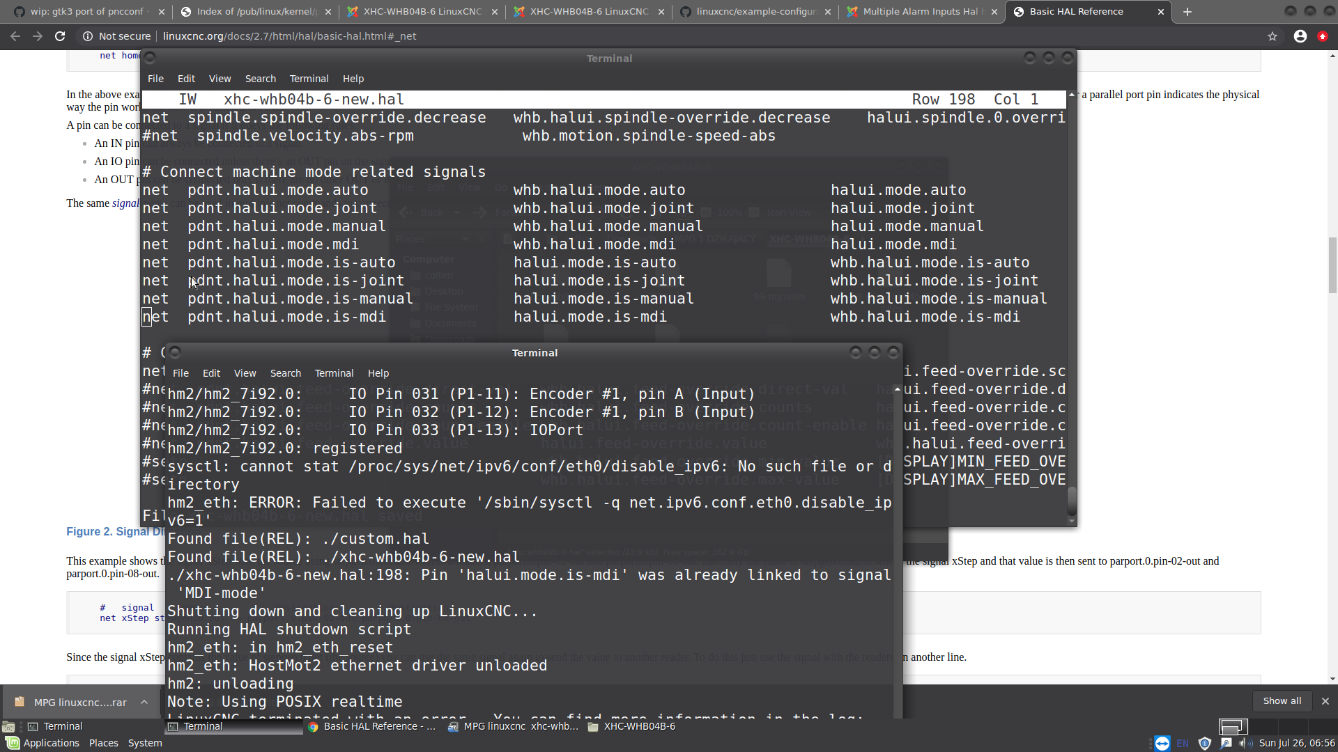

Having an issue with is-mdi already being assigned. I've inserted a pic of the error. The link to the github page does not include a example .hal file.There is a kind of readme md file for the example hal file, but the pin definitions are all jumbled

29 Jul 2020 00:31 #176315
by alkabal
Replied by alkabal on topic XHC-WHB04B-6 LinuxCNC not working
Hi
I think you simply need to remove the "setp MDI-mode halui.mode.is-mdi" from you main ini file that is not really used.
