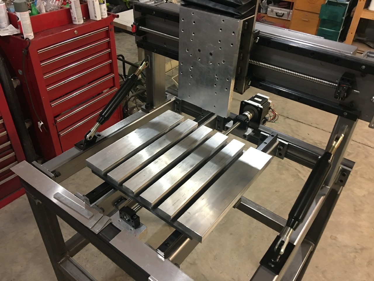

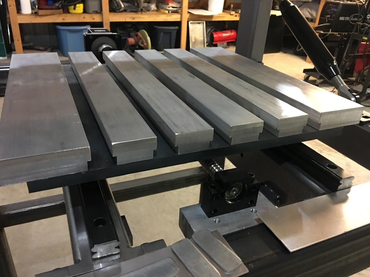

16 May 2020 01:08 #167916
by Mayberry Customs
Replied by Mayberry Customs on topic New Mill Build...Can I use LinuxCNC?
The 7i76E is on its way!!...Still going to grab a 24v PS, does the PS posted above look correct?...made a little progress on the multi piece aluminum t slot table, plan to mill the surface with the machine, it’s a semi permanent set up...they will bolt on from the bottom...they can be decked off several times, and swapped out for more aluminum or steel whenever necessary. Thanks, Andy
