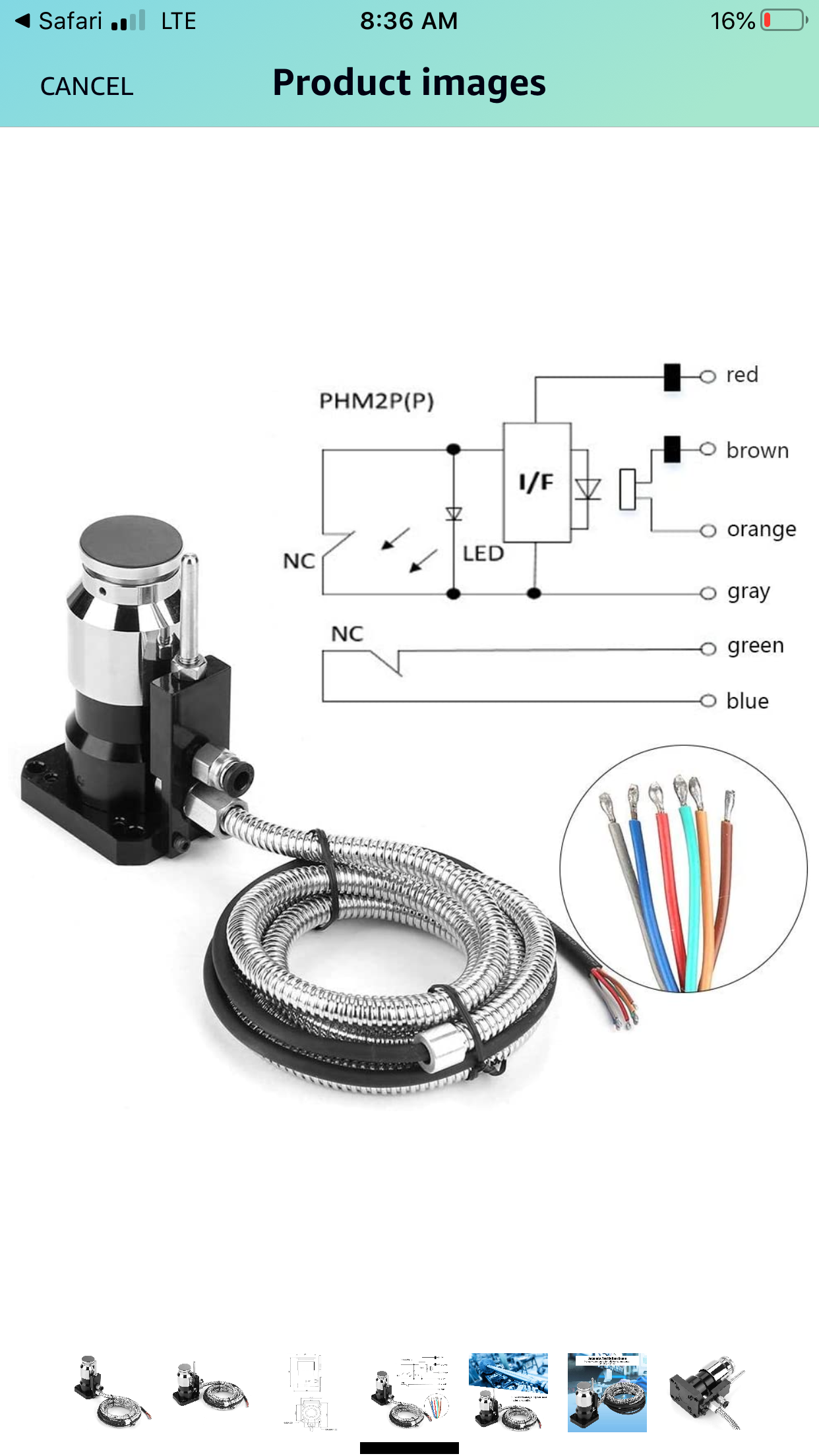

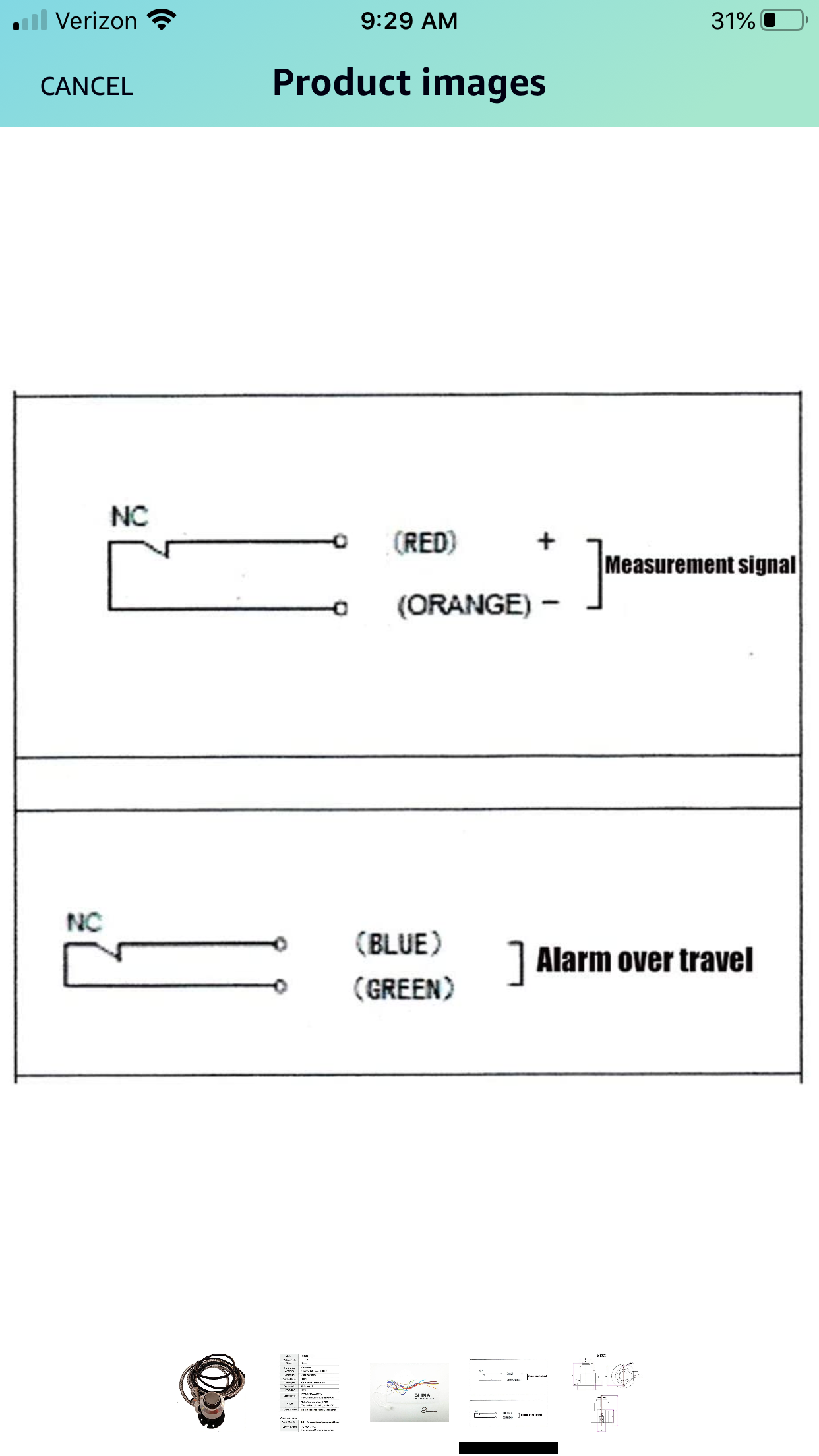

Working on wiring the board now...I want to use a tool setter at some point so I can take advantage of the auto tool measurement in gmaocapy ...is this consider a “digital input” and do I wire it the same way as the limit switches?? Thanks, Andy
- Mayberry Customs
- Posts: 62
- Thank you received: 8
01 Jun 2020 13:39 - 01 Jun 2020 20:12 #169665
by Mayberry Customs
Replied by Mayberry Customs on topic New Mill Build...Can I use LinuxCNC?
I’m talking about a tool setter similar to the picture...Can anyone help me with how to wire something like this to the 7i76e? I’m assuming it’s wired just like a limit switch then just simply configured as a tool probe or tool setter in pcconfig. You can also see in the picture that it can be wired to alarm out if it goes past it’s travel, is this also connected to another input on the board? The simple diagram picture is from a different tool setter but one that looks very similar
Thanks, Andy
