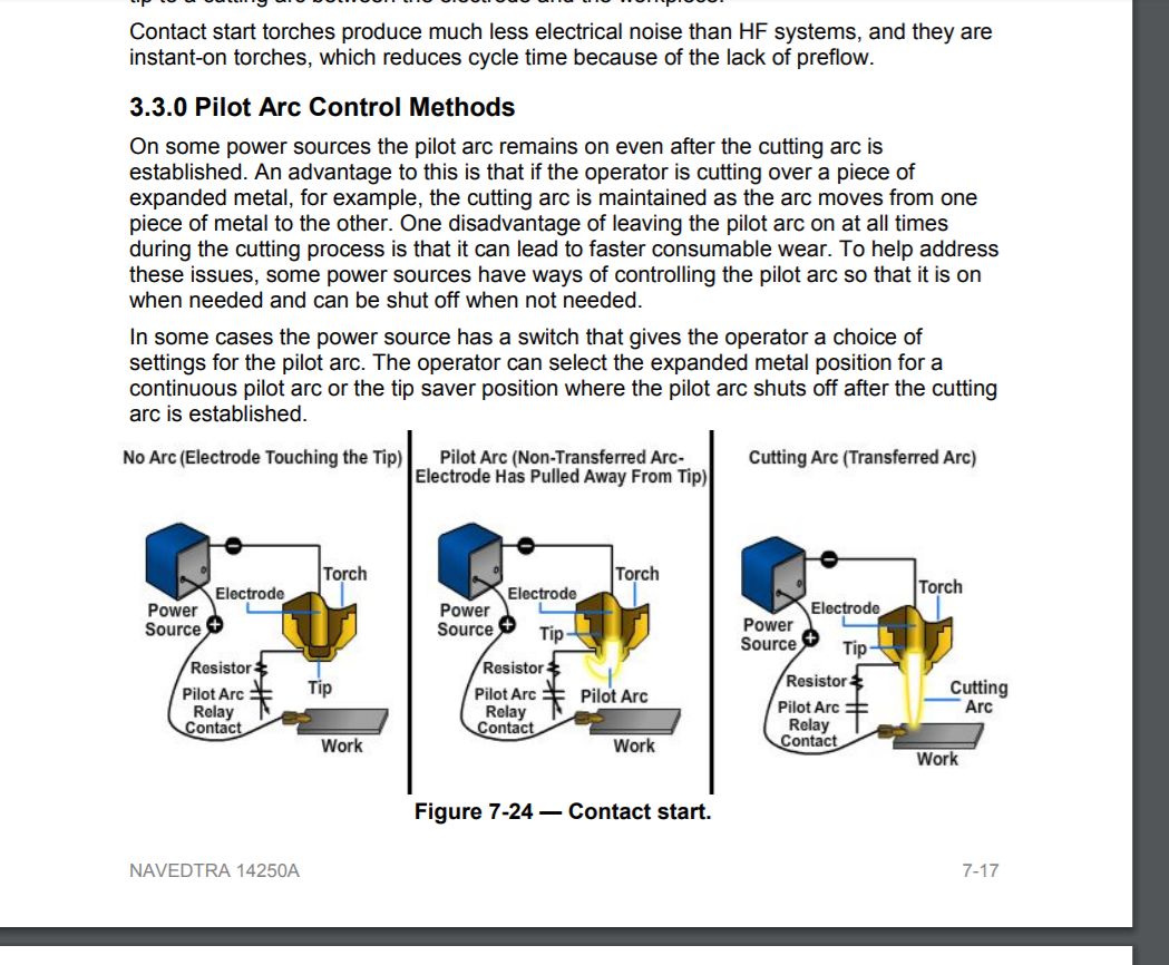

27 May 2020 14:26 #169131
by jay1st
Nope, it can be pilot arc without HF.
There is still a ground wire coming back to the generator, and if the torch keeps firing over a gap without any metal around then it's a pilot arc system llike mine.
So the THCAD will never be able t detect any variation in voltage due to height change as the gap inside the torch never changes thus keeping the voltage more or less constant. See picture attached for the principle of pilotarc
Replied by jay1st on topic Z axis
jay1st I am aware that a plasma machine does not have to be HF to be a pilot arc. I will be the first to admit I should have not pinched pennies when I bought my plasma machine. Reading the link you provided it appears l have a very similar problem to what you had, but correct me if I am wrong your machine is a HF type right ? As I do not have a HF type plasma machine, your approach does not apply. I could be wrong wrong though.
