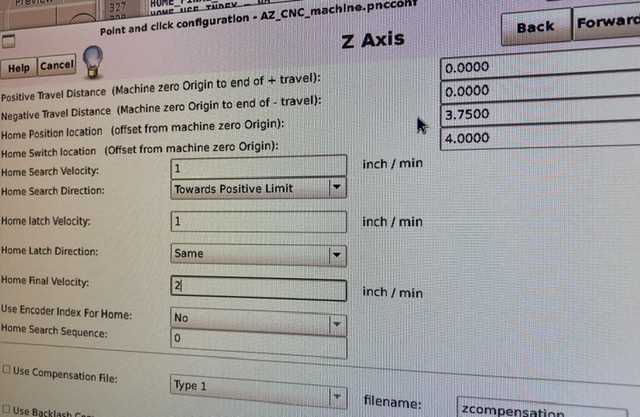

With a little help, I figure out that the “home switch location” is the max my z axis can travel up, Away from slats. Thus “home switch location” is where You would want the z axis to move to when once it find its home/max limit.
So I my case the “positive and negative travel” boxes where throwing me off.

Homing can take a while to get your head around, this gives a fairly good description.
linuxcnc.org/docs/2.8/html/config/ini-homing.html

There is a catch to homing in this case, the home and home offset are tricky to get correctly, i had to set home at 160mm and offset at 165 for it to properly home. Total travel is 170mm plus 10 for the float.
And i have the min set at -10.
