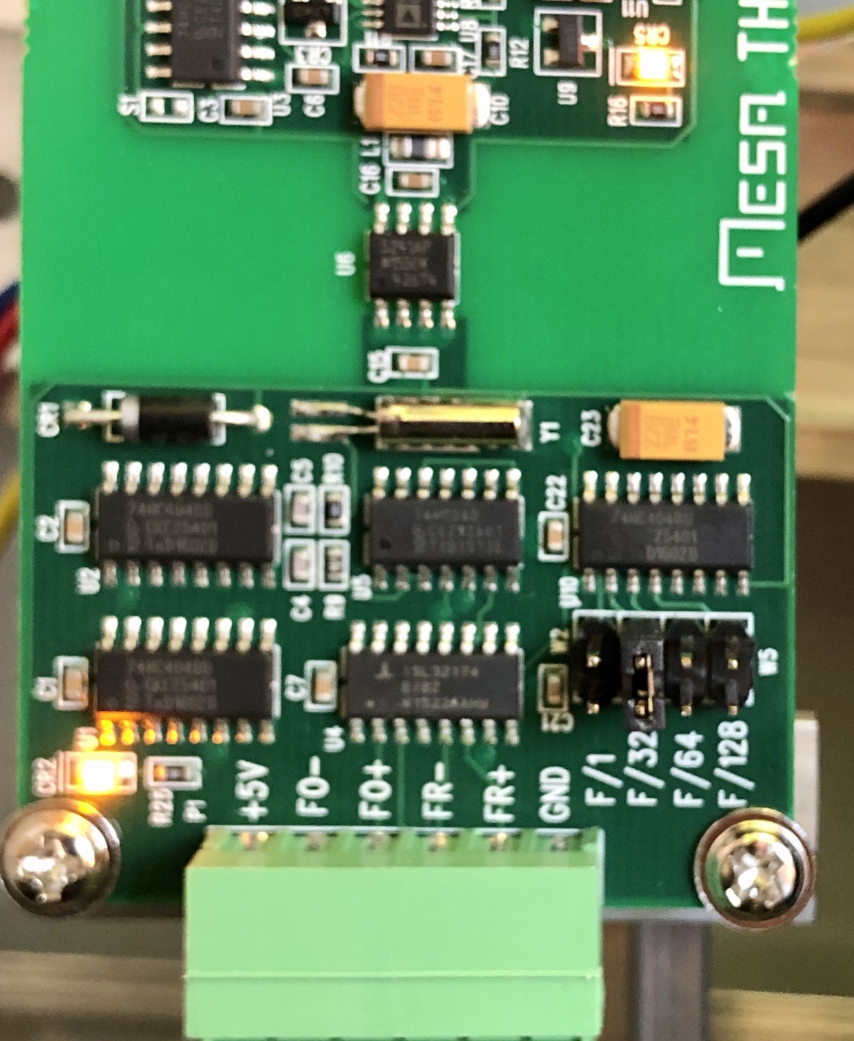

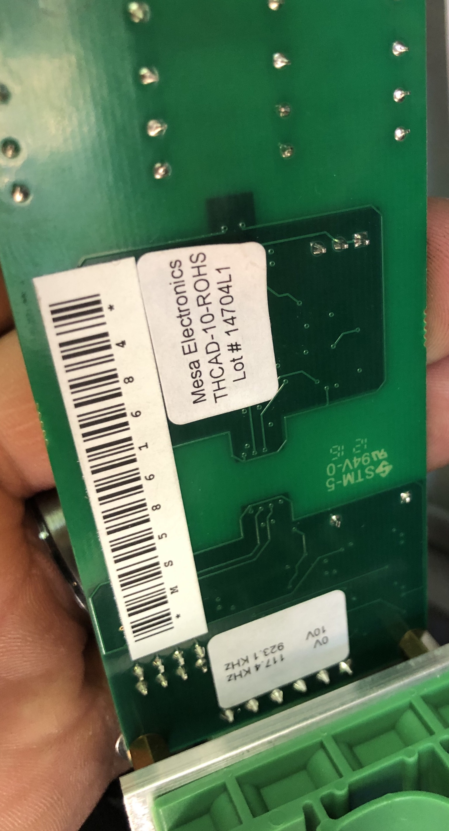

Strange, Your numbers are correct and the hal files look good, the only thing I can think of is the divider is not really 50:1
A -73V variation from what it should be is a lot.
Have you checked that the THCAD jumper is definitely F/32?
EDIT: definitely a THCAD-10?

Here a couple pictures, to make sure

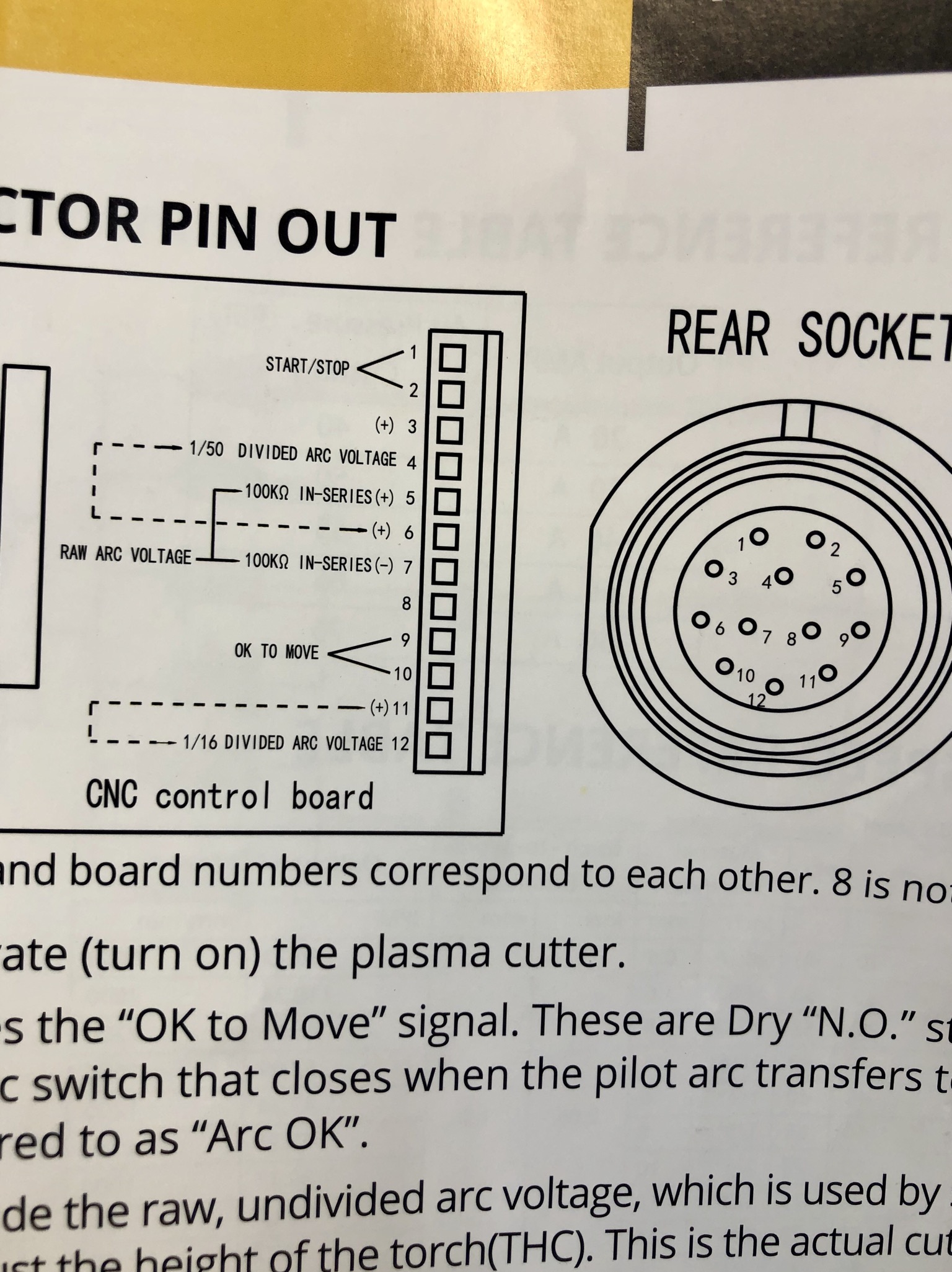

My plasma machine has 3 out put for voltage.
1/50, 1/16 and raw arc voltage with 100kohm resistors in series.

And I just triple check my wiring and I Am connected to the right pin 4 and 6 for the 1/50
