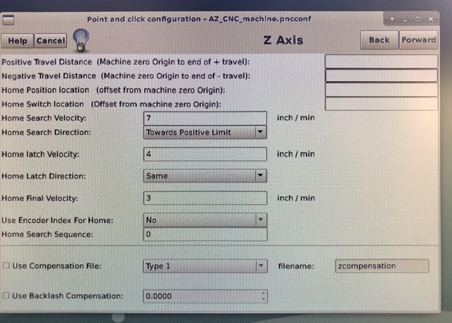

I will try the suggestion you made tommylight,
On a side note, I figured out some of the homing issues I had especially with the z axis.
When setting up the axis the home search direction was set up the wrong, so for other make sure you pick what’s appropriate for your application.
Follow up question, what’s best for practice when setting up the home inputs . Should one pick “home”, “shared home” ,if share home is picked should you pick “min limit + home” , “both + home”?
- Posts: 22011
- Thank you received: 7491
07 May 2020 17:03 #166972
Replied by tommylight on topic Z axis
For PlasmaC you should pick max limit + home.
Beware that the limits on the Z axis should be set as a normal axis, not as a mill, meaning min limit should be 0 and max limit should be where your home switch is, or near it.

In that note. What do I put in those empty box in the pnccofig wizard , see picture

Nevermind I figured it out.
