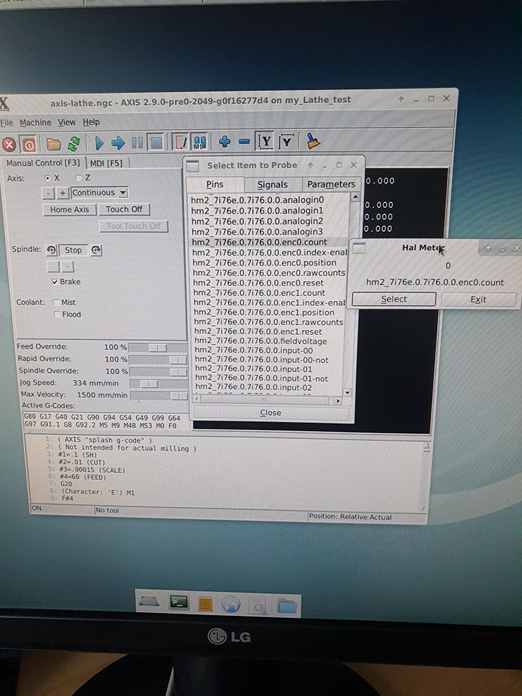

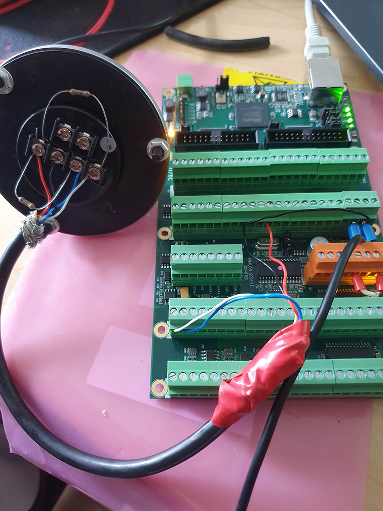

PS: i tested the halmeter in linuxcnc, tryied all enc0 pins, but when turning the handwheel, nothing happens. When measuring on the A and B wires from the MPG then i get 4,10V when turning the wheel. Not sure why 4,10V and not 5V.

16 May 2020 18:57 #167995 by PCW
The raw count for MPG field inputs 16,17 should be
hm2_7i76e.0.7i76.0.0.enc0.count
To count, the inputs must swing below 2V and above 3V relative to field ground

Alright, i am back at the test PC.
@PCW: Thanks for that! Now i do understand that the input pins 16 and 17 dont need to be somewhere in the HAL, because those pins are already linked with "hm2_7i76e.0.7i76.0.0.enc0.count". Correct?
So, 4.10V is totally fine.
@rodw: I have read your build thread many times, really, but my problem is, i have no switches at all, so i dont know what i have to change in the HAL so that the MPG is always active just to test it.
The only thing I thought of is that if you don't have the axis select switch installed, you might have to setp the MPG scale pin to a value. If it is 0 , nothing will happen.
Thats a good point. Make sense for me, but again i dont know what i have to enter/change in the HAL to set one scale which is always active, so that no switches are needed.

17 May 2020 11:35 #168043 by denhen89
So, i just upgraded to Linuxcnc 2.9 pre.
Debian vers. 9
Wiring of MPG to Mesa 7i76e: See picture:
*GND from TB3 Pin 9 is connected to GND of TB3 Pin 23

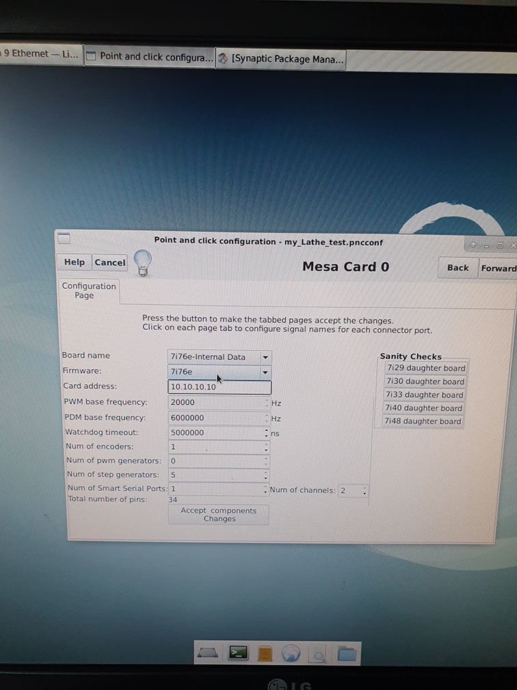

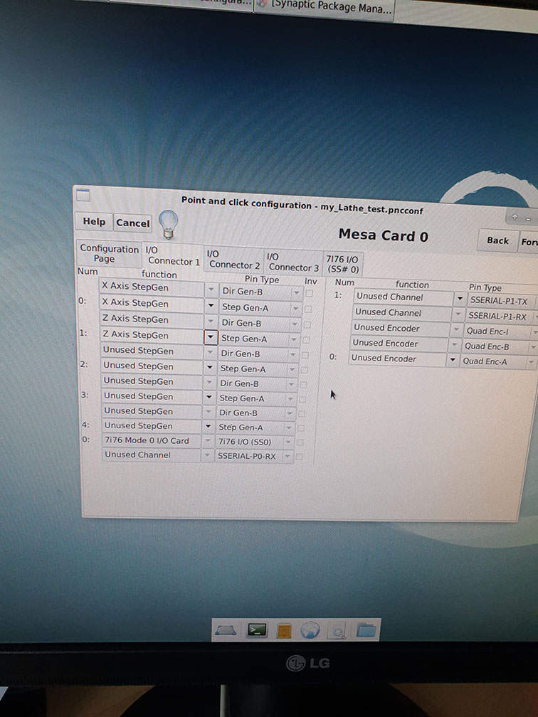

I used PCCONF to create a RAW setup. See pictures:
Everything else has been not set up and left as default.
After the set up i changed in the HAL the sserial port: sserial_port_0=2xxxx
I attached the .HAL and .INI file
I started Linuxcnc, opened the Halmeter and unfortunately nothing happens when turning the MPG handwheel, no matter which Pins enc0 pins i choose. See picture:
Do i understand it correctly, that if the wiring of the MPG is correct, then something should happen in the Halmeter when selecting the correct Pin ?
To remember: I have no switches to select the scale also no buttons to enable to MPG, so as Rodw wrote, i would need to set a standard scale. Also i would need to have the MPG active without any buttons to press.
I hope that are all informations you need to help me out.
Of course, in meantime until i get some help i will try to get it done by my self and not just wait until someone helps :)
Thanks in advance guys.
