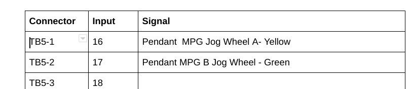

To speed things up a bit, i am going to eat something and grab one of my 7i77 and a 5i25 or 6i25 if i can find them and do a mock up for testing, and some encoders. Back in 20 to 30 minutes.
- Posts: 12156
- Thank you received: 4149
17 May 2020 12:40 #168056
Great stuff! I did say I did not use resistors!
Replied by rodw on topic 2 seperate MPG handwheels for each axis - CNC Lathe build
Works!
What i did. I took the second MPG handwheel i had lying around and connected all 4 wires to the terminals but without the resistors. Halmeter shows counts!
EDIT: and of course i changed the white and blue wire back to TB5
- denhen89
- Posts: 301
- Thank you received: 27
17 May 2020 12:53 - 17 May 2020 12:56 #168057
by denhen89
Replied by denhen89 on topic 2 seperate MPG handwheels for each axis - CNC Lathe build
Okay, one MPG works, but the one where the resistors were wired, does not work. I put all wires back to the first MPG, but of course without the resitors and hal does not show the counts.
Have wired up the second mpg again, halmeter shows counts. Back again to the first= no counts.
Is it possible that the MPG got damaged because of the resistors? (2k0 resistors)

Rodw, thanks but it seems i found the problem.
I measure Ohm on the terminals of both MPGs:
Red stick(dont know the correct word) on terminal 0V and black stick A, then B , then the A and B terminals on bottom of the mpg. All are giving 5.4 Ohm.
But, on the MPG which does not show any counts i get on all 5.4 Ohm, but not on the main "A" terminal. It shows: 0.001 Ohm
So it seems something with the terminal A on the first MPG i tested is not okay. Right now i am not sure if its because of the resistors or if i shorted something

Glad it works, not glad for the faulty MPG.
2KOhm resistors can not do any damage as they were connected, must have had a 5V connected to output A at some point in it's lifetime. Anyway, i have a Mesa 7i77 and some others here, just in case.
