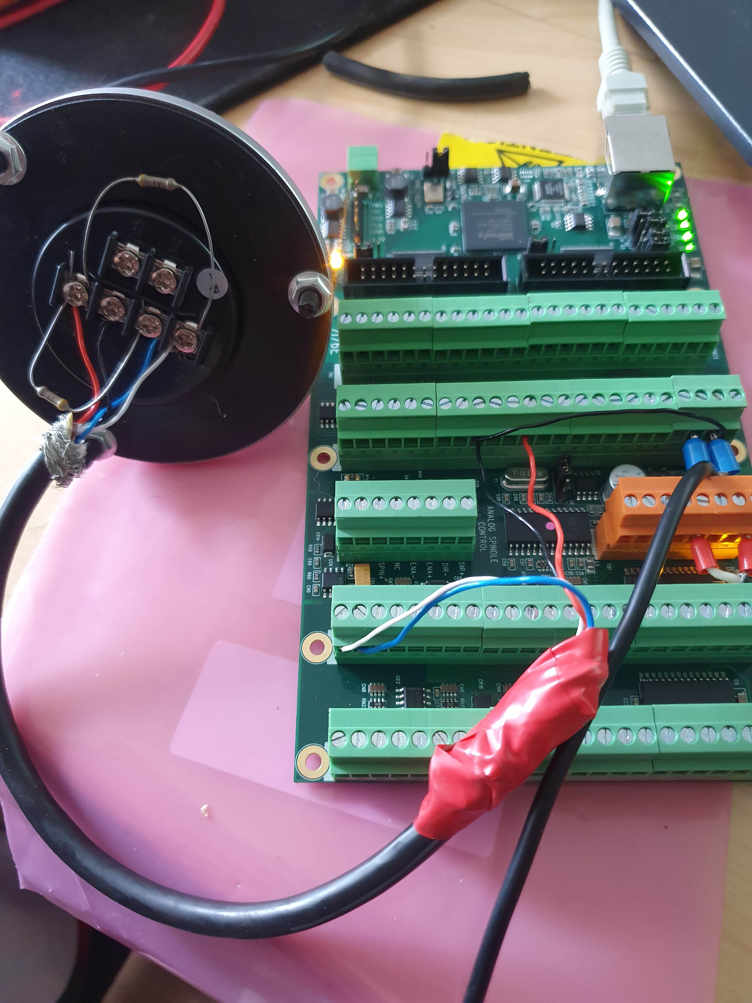

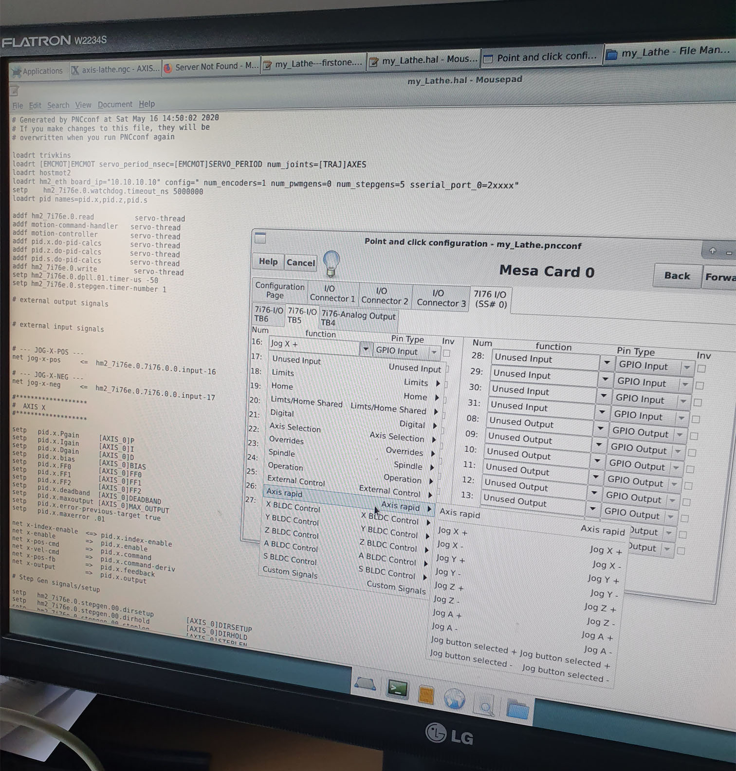

16 May 2020 08:11 #167968 by denhen89
Haha i was also confused when i have read your first post on this page :dry:
Current situation: The wiring is done as shown on this manual (page: Connection of MPG's): wiki.eusurplus.com/downloads/7i76E.pdf
Now i would like to make the setup for the MPG with the PCCONF tool: I am on the configuration page on the main Tab "7i76 I/O (SS 0)" and the daughter tab "7i76-I/O TB5". There os jabe to chose the function. I choosed "Jog X +" for Input 16 and "Jog X -" for Input 17, which is for sure wrong, because nothing happend on the AXIS GUI DRO, but the MPG gives 5v when turning the handwheel.

16 May 2020 09:01 #167973 by tommylight
@Rod, you mean 2 pins,
@Danhen, you are not using two power supplies , so you are good and the wiring should be ok if those are +5V and gnd from the Mesa with the red and black wire.
@Rod, those are pull up resistor as the encoder has open collector outputs, so it can pull the signal to ground but not to +5V.
@Danhen, in pncconf, there is the option of using MPG, but i think it is for the spindle encoder, so you can set that and later edit the hal to point them to the actual encoders.

16 May 2020 10:31 - 16 May 2020 10:48 #167976 by denhen89
Thanks Mikel_Eitel and tommylight.
Sorry for my lathe reply, but unfortunately (as always with Linux) i had and still have problems with my wifi on the test pc. Its disconnecting from time to time when using a brower. But it does not matter right now.
To Mikel_Eitel: I cant find that post: #130396. Could you send me the link?
To tommylight: thanks, but its impossible to get it done for me, because i just dont know what i am doing or what i have to do. Its so complicated for me and i really dont know why. The CNC router with the cheap BOB was so easy to set up, but i really dont know how to do that with the mpg handwheels.
I try to check some settings from others, but the first thing which i just dont understand is, why in no lines in the HAL are the input pines pointed out.
Like for example i found this answer from Andypugh on that topic Mesa 5i25 and 7176 getting started :
Then connect the mpg to each axis:
net x-jog hm2_5i25.0.7i76.0.0.enc0.count => axis.0.jog-counts
net z-jog hm2_5i25.0.7i76.0.0.enc1.count => axis.2.jog-counts
Are there no input pins missing? I just dont get it. No even a bit. I would really wish someone would make a tutorial or something and not just give 10% info. At least i think that its impossible to know what to do for a "mesa beginner" as i am.

He did connect the MPG to TB5 Pin 1 and Pin 2, as i did also for one MPG handwheel. But no where in the HAL i can find something like "input 16" and "input 17".
Guys, i dont wanna cry, but i dont get it done by my self. No chance. I know that this is not your problem and you are helping here for free, but since i have got the Mesa 7i76e i have spend about 24 hours to get things done and from the 24h a spend at least 10 hours, just to get the Handwheels connected and setup, but with no positive result. I am currently really thinking to give up and sell the 7i76e, forget about the mpg handwheels and just use a cheap BOB which i know that i will be able to setup.
Another option is that someone does the work for me and i pay for that. There are nicer things to do then trying something without any clue about it.
Last edit: 16 May 2020 10:48 by denhen89.
