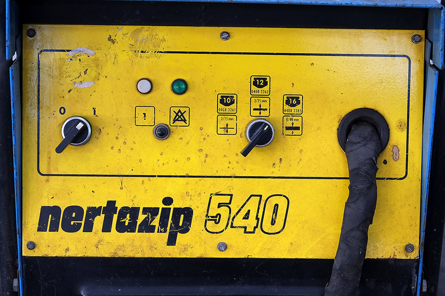

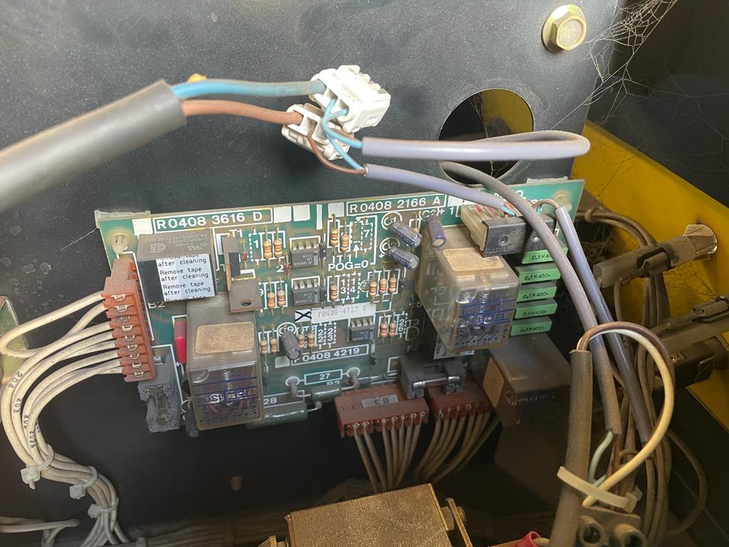

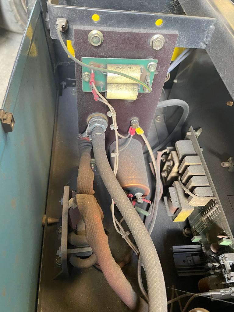

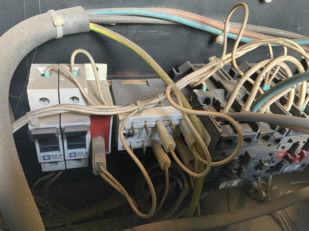

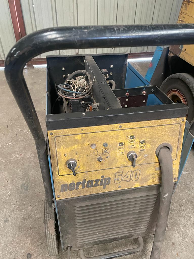

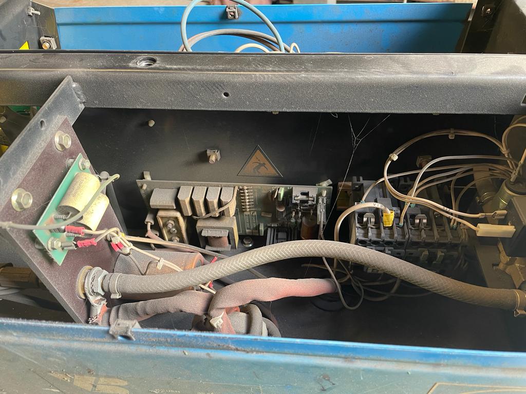

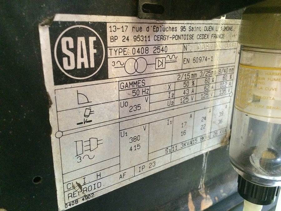

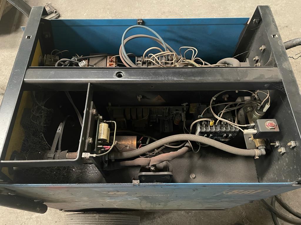

Remove covers from plasma, take some pictures, post here.
Also find 2 of 1MOhm resistors 2W, we might need those.
- Esaber
- Posts: 135
- Thank you received: 15
05 May 2023 10:12 #270718
by Esaber
Replied by Esaber on topic Esab Ultrarex UXD-P2000 Upgrade Project
Will do that.
For the resistors I don't have any 2w at hand. I have a bunch of 1/4w I can wire in series to get the 1Mohm 2w to test if needed. I will get some 2w resistors next week.
